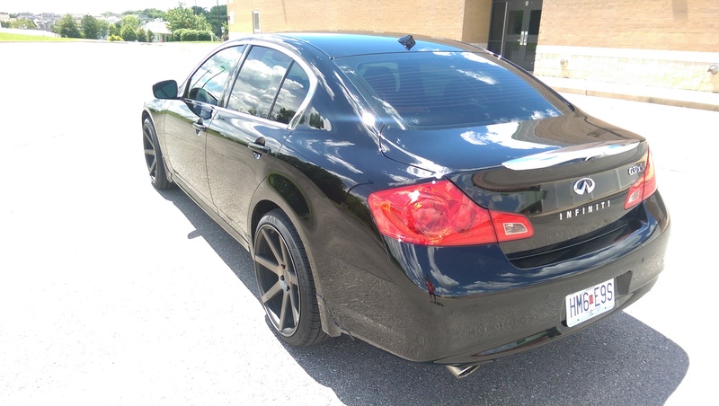

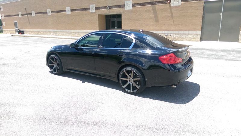

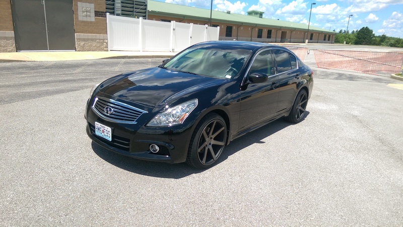

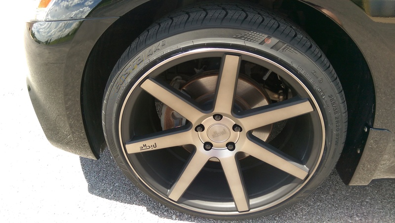

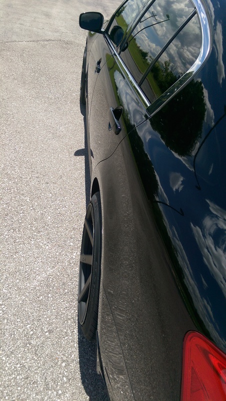

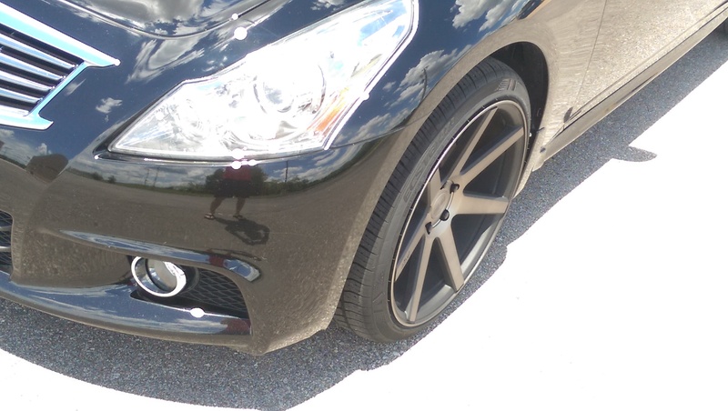

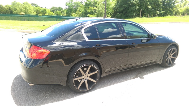

Well it's been a couple months since I started this thread. Long story as to why it took so long to come back to it so I'll tell that in another thread. Ended up going with 20 x 10 +40 Niche Verona wheels with 255/35/20 Kuhmo Ecsta 4X II tires.
Here's a few pics -
They stick out a little more than I'd like them to but I can live with it. Thanks everyone for all the advice!
