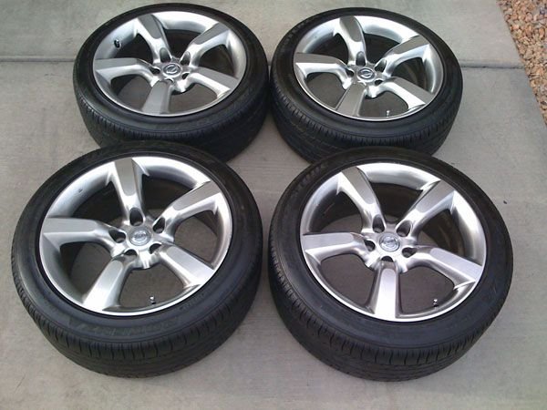

350z Anniversary wheels are on of few wheels that clear the Akebonos with no problems. 17s do not clean the Akebonos
I really like those wheels. Are they hard to find?
Old Oct 31, 2015 | 09:28 PM
Bingo!
https://www.myg37.com/forums/private...ebono-bbk.html
