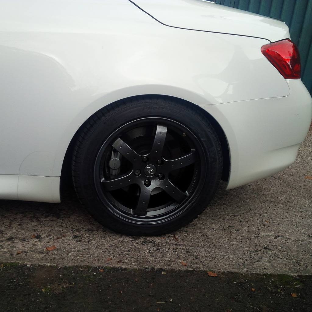

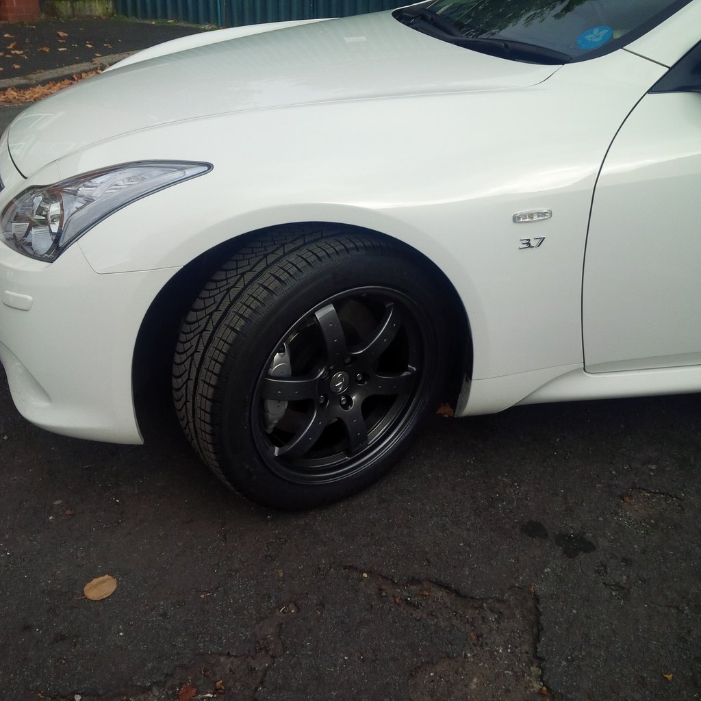

I fitted 20mm spacers on the front and 25mm on the rears, using H + R (they're German, readily available in the UK)
H&R TRAK+® Wheel Spacers | Products || H&R Special Springs, LP
Not sure if they're available in the US, so this may not be too helpful !

H&Rs are a common spacer here in the US and one of the highest quality choices.
Those gunmetal Z wheels look great on that G too, nice job!^^^^^
Wish ours had those side markers too.

To get back to the thread from the OP - my car in the pictures above is on 18" wheels as I bought a set of Rays off a 370 owner and refurbished them so I'd have a set of wheels for my winter tyres. I'll put my 19" wheels back on in the springtime.
18" wheels fit over the brake calipers no problem. Be aware, though, that I kept the rolling radius the same as on my 19s so the traction control is dealing with the same size overall on the wheels.
