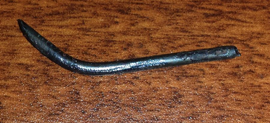

My response in this thread earlier must of been a precursor to what happened a few weeks ago. Noticed one tire was losing pressure relative others; about 1lb every 4-5 days. Got around to pulling the wheel off today to discover this.
It must of been there a while as the head was completely sheared off. Took a while to find the leak too. It was in one of the tread blocks, about 3" inwards from the inside shoulder. From the motorcycle days, I've always carried a plug kit with just in case. Should be good enough until I replace the entire set next spring. I'm just glad it wasn't a bead or valve stem leak - can't really fix that with hand tools.
Btw, tire pressure never got low enough to trip the tpms. Since the car isn't driven daily, I typically check tires at least every 2 weeks. It raised concern when psi difference is more than 1/2lb.

Do you still have a warranty? Looks like a lot of life left on the tire ,but as other have said way too close to sidewall.
