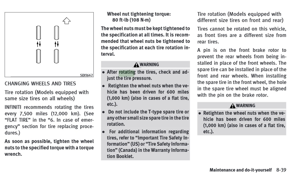

Wait, I thought on an X you can only do front to back? No crossing.
Now I'm not sure. I got this from Tire Rack:
Four (4) Tire Rotation
What tire rotation pattern should be followed? The Tire & Rim Association has identified three traditional rotation patterns covering most vehicles (equipped with non-directional tires and wheels which are the same size and offset). The first being the "Rearward Cross" (Figure A) rear and AWD; the second being the "Forward Cross" (Figure C) rear and AWD and the third is the "X-Pattern" (Figure B) front-wheel drive. The X-Pattern can be used as an alternative to A or C
http://www.tirerack.com/images/tires...tation_abc.jpg
Sorry about the jpg. The image wouldn't load.
Or check out this URL: http://www.tirerack.com/tires/tirete....jsp?techid=43
Sean
Old Jul 16, 2015 | 09:16 PM
empirepb48's Avatar
empirepb48
Joined: Dec 2014
Posts: 83
Well I did some research myself now. It really depends on the tires and wheels you are running. Basically if there is no arrow on the outside of the tire to state that its a directional tire then you can cross. Neither of the OEM X tires 17" or 18" are directional so why does the manual state only to do front to back?
This is the link that cleared it up for me.
http://www.barrystiretech.com/direct...icaltires.html
