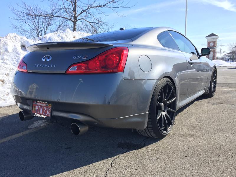

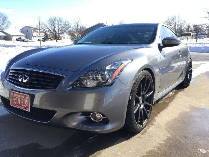

I think you will be fine. This is my car with 20x10.5 +20 rear wheels and 255/35R20 tires. I am lowered on Eibach Pro Kit springs and have the full array of SPC alignment kits. My rear camber is about -1.7 to -1.8, which is at the far side, but within, specification. My toe is set to 0. Other than rubbing the fender liner, I don't think you will encounter any issues since your wheel will extend 2mm further outward, but your 245 tire will be 5mm smaller on each shoulder. Also, the Continental DWS tires I have run pretty wide.
