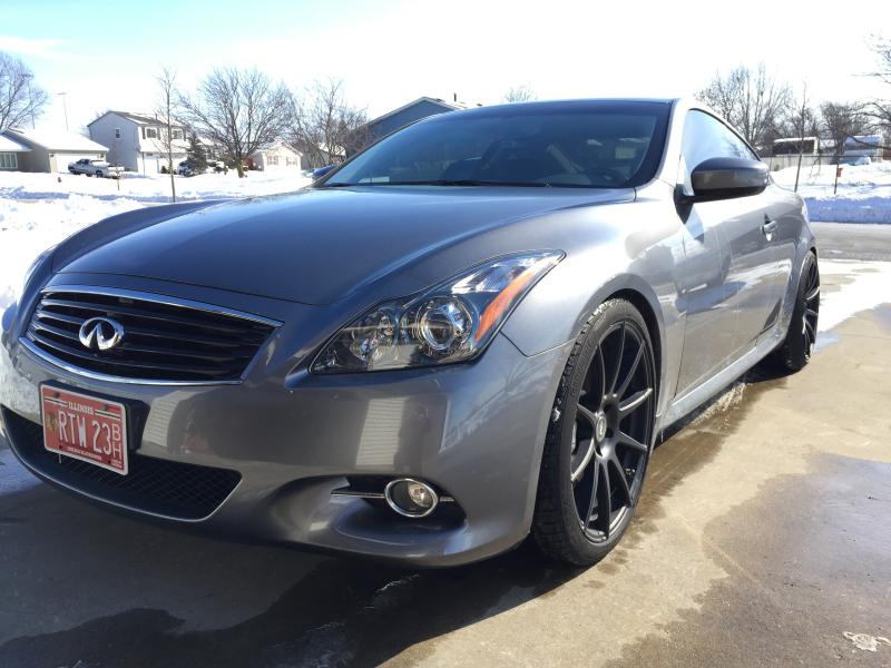

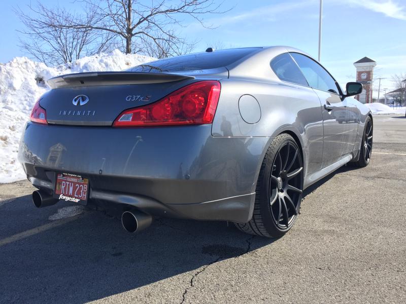

Originally Posted by G37xhibeet
Ryne runs 255/35/20 on all corners so the front can definitely handle that. For 19s I guess 255/40/19 is what you would want.
And just FYI: I, as well as others, run 245/35/20 & 285/30/20 with absolutely no issues.
Full disclosure: I've only gotten the car up to 90 on this setup.
So....square is the safest route, but if you really want the fat rears you can have them
This is true. 255/35R20 all around without any issues. My wheels are staggered though - 20x9 +28 for the front and 20x10.5 +20 for the rear.
Much more info on this setup here:
https://www.myg37.com/forums/wheels-...are-tires.html
