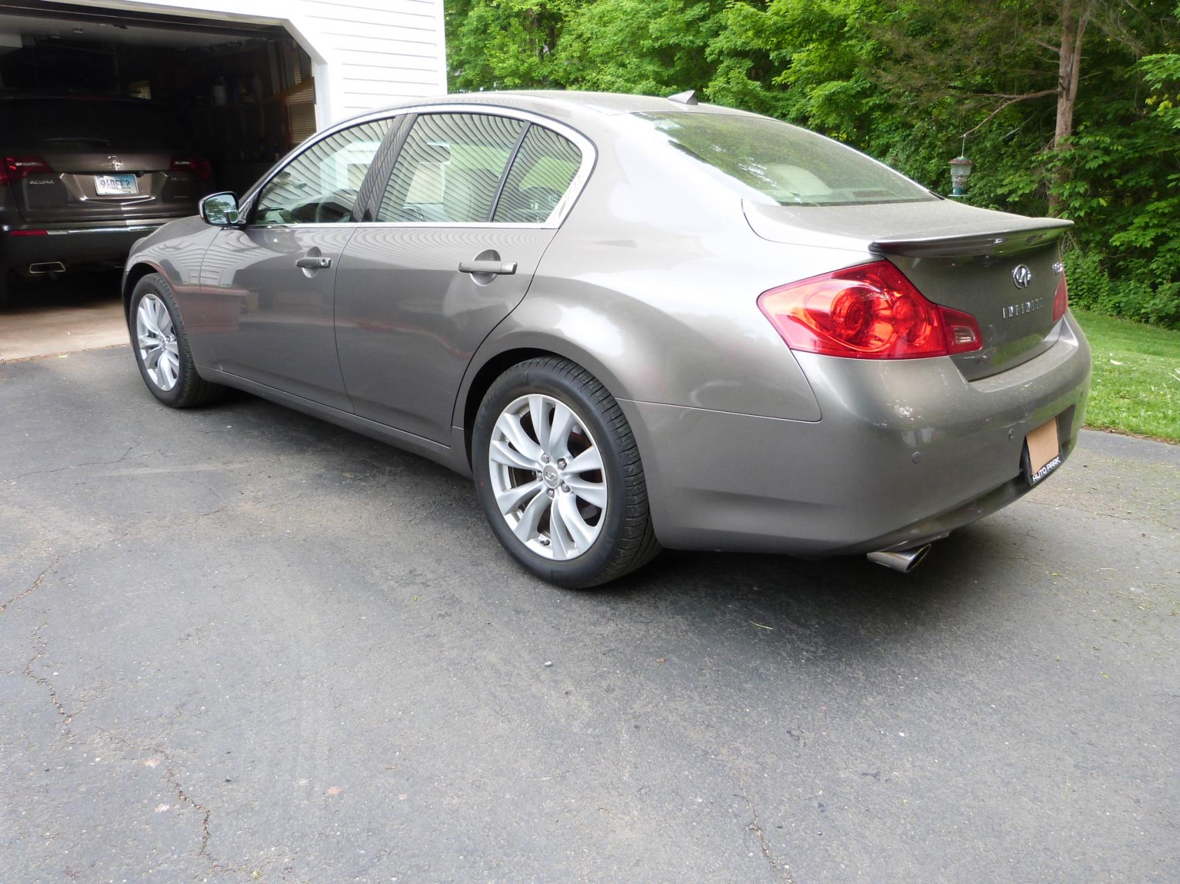

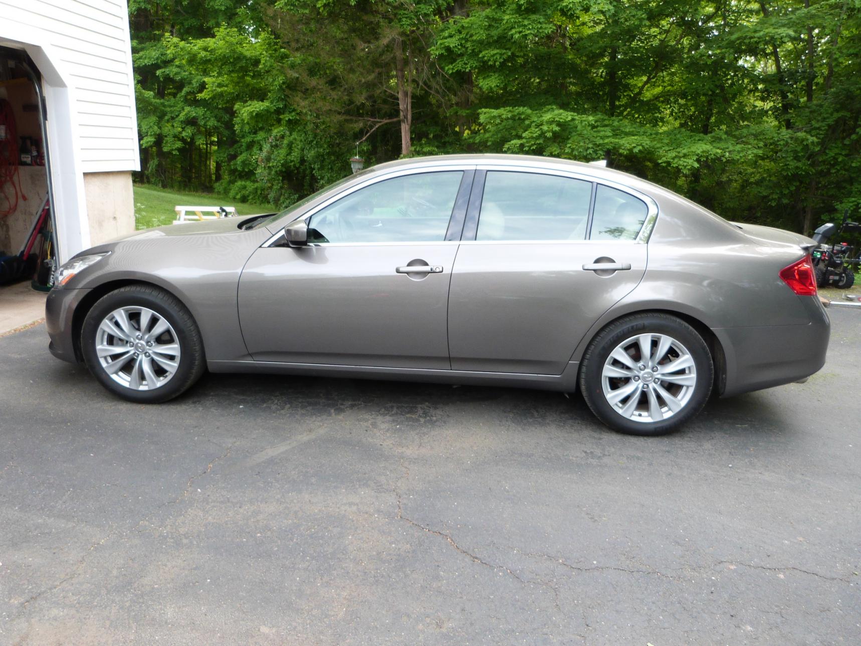

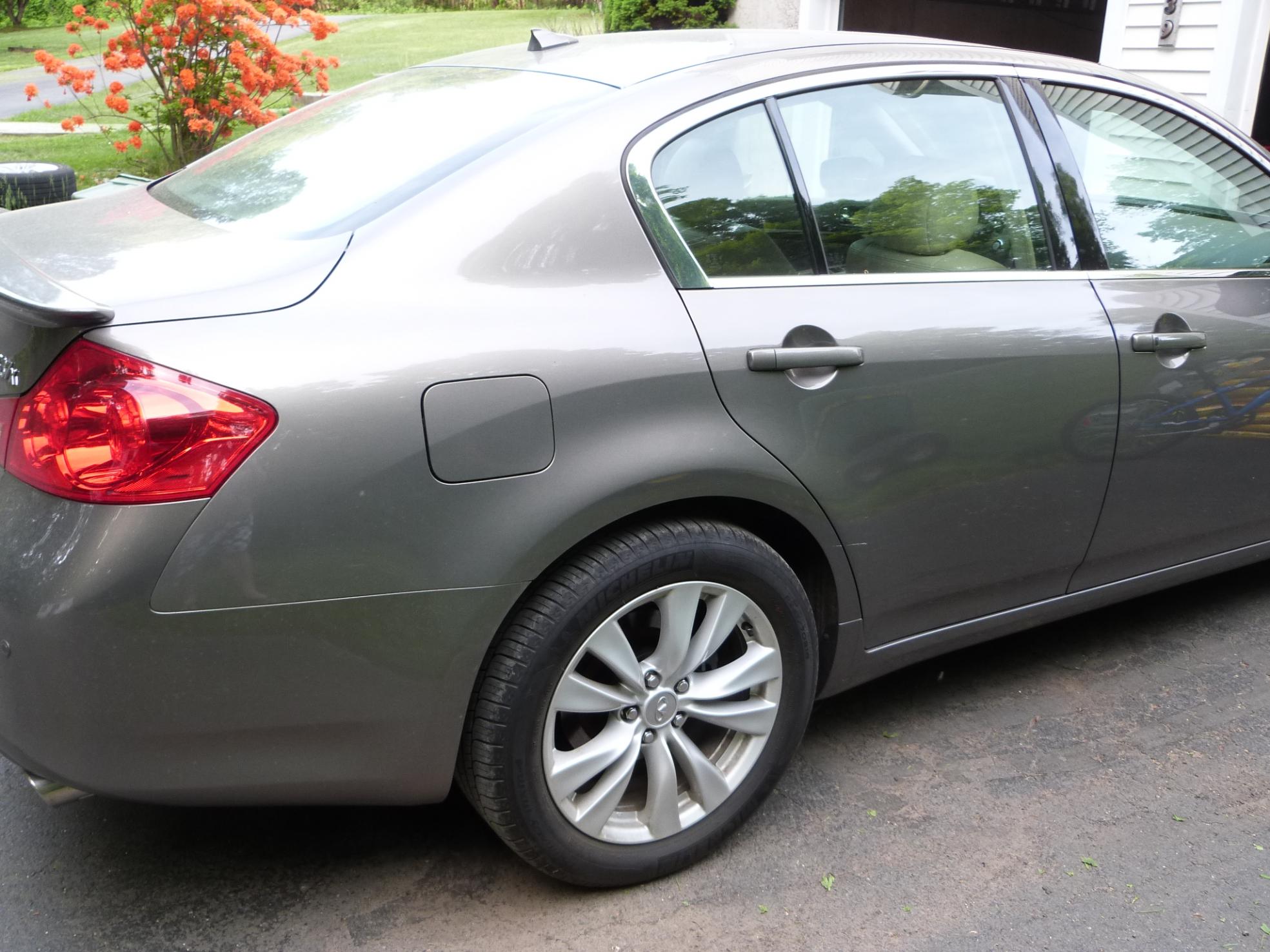

My G on M wheels and tires. Tires size 245/50r18. Been running them for 6 months with no ill effects. Traction control, ABS got me through a New England winter. The speedo reads about 58 when I am doing 60. All stock. Initially purchased this combo to get the wheels and sell the tires. Since it looks good and works well decided to keep it for a while:
