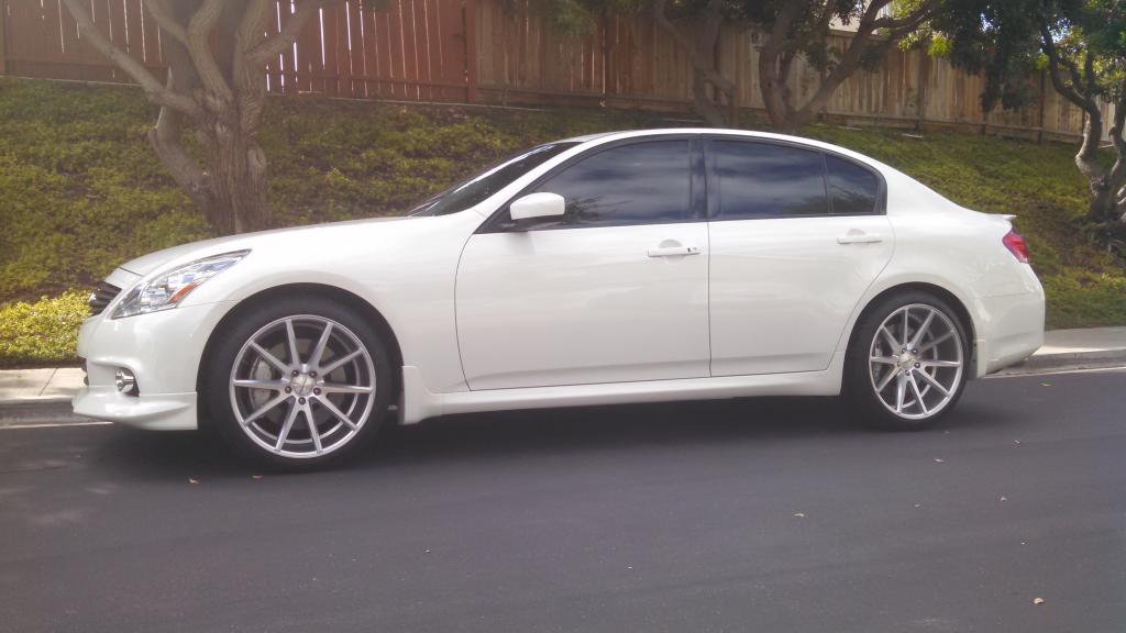

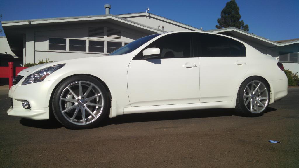

Stock diameter will be easy to maintain with the correct sized tires. Seems like plenty of guys run staggered set up on here with no issues on the X. How much are the CV1's?
If I were you, I'd look at A LOT of pictures with these cars on 20's with no drop. Honestly it looks ridiculous, bro. I have an S, so it sits slightly lower, and it did not look good with 20's and no drop.
Before:
After:
Before:
After:
Hmm yeah thanks for the pics, its helpful. Maybe 19's would be a better choice, that is what I had in mind originally anyways. I just don't want to pay like $3k+ for a set of wheels, I don't care about them enough to pay that kind of money. I think 19's might not look quite as ridiculous without a drop. The TSW Nurburgring in the gun metal color I think might like good, and they only cost like $3xx a wheel. I am trying to figure it out now so I am ready to put something else on by springtime, as I mounted some Michelin X-Ice winter tires on my stock wheels which I am currently using, so I might as well just get new wheels/tires as my old A/S tires are almost out of tread.

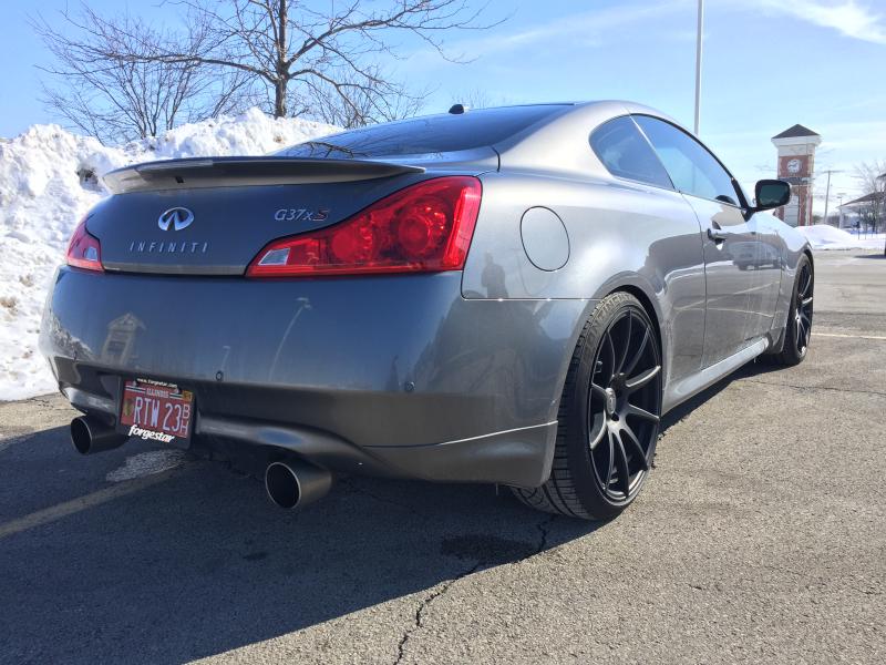

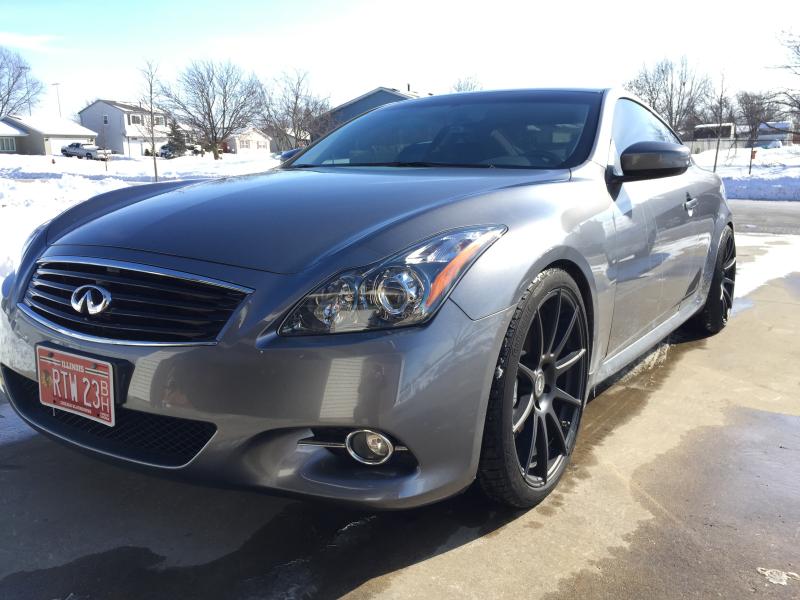

I took a different approach and purchased staggered wheels (20x9 and 20x10.5) and installed square tires (all 4 are 255/35R20)for the AWD system. This setup has been perfect for me. The DWS tires are great in the snow. No AWD light. Great stance with a nice staggered look and deep concave rear wheels.
Here is my review thread for more details:
https://www.myg37.com/forums/brakes-...are-tires.html
