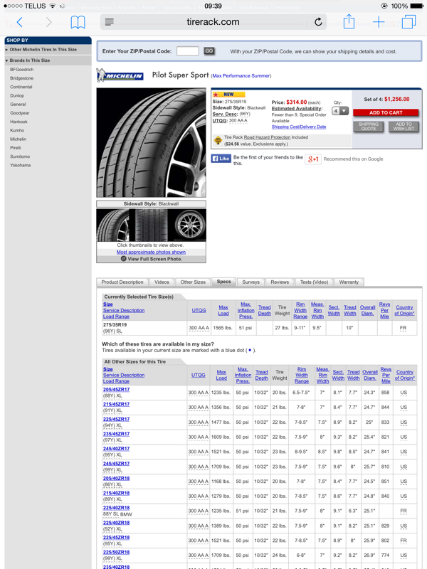

Can 275s fit on a 8.5 inch wide rim? That seems like it's pushing it.
Old Jan 6, 2015 | 08:41 AM
drkay's Avatar
drkay
Joined: Jul 2014
Posts: 151
Likes: 44
From: Calgary
According to the specifications on Tire Rack the tire is designed to fit on a 9 inch to 11 inch rim. And 9.5 inch wide rim is ideal.
I've run a 275/40 17 on an 8.5" on the Camaro and it was fine. Aren't the rears on these cars 9" wide though?
Yes, the rears are 19" x 9" and Michelin recommends a rim width of 9" - 11", so it shouldn't be a problem.
