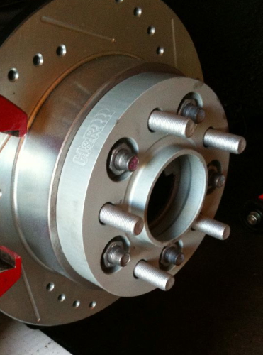

I got a Infiniti G37s 2010 and I had to get spacers for my winter tires because in the front the \after market wheel would rub on the brake of the car. I got H&R hubcentric 20 mm spacers all around and now i found out I have a gap issue with the spacers on ..... HELP

Not clear on what you mean by a gap issue? Are the spacers not mating up properly to studs and leaving a gap? Or are the spacers too wide creating interference at the fender edge under compression?
the studs from the original are sticking out that they are are rubbing the wheel

Is this what your spacer & stud look like and the oem studs hitting the backside of the rim ?

Most wheels have recesses in the back of the wheel mount where the spacers' studs will go. If yours only has a flat mounting flange you're not going to be able to run them
Thanks for the pic Gio!
Yeah that is the issue ... Not that bad as the picture but ... Yeah
