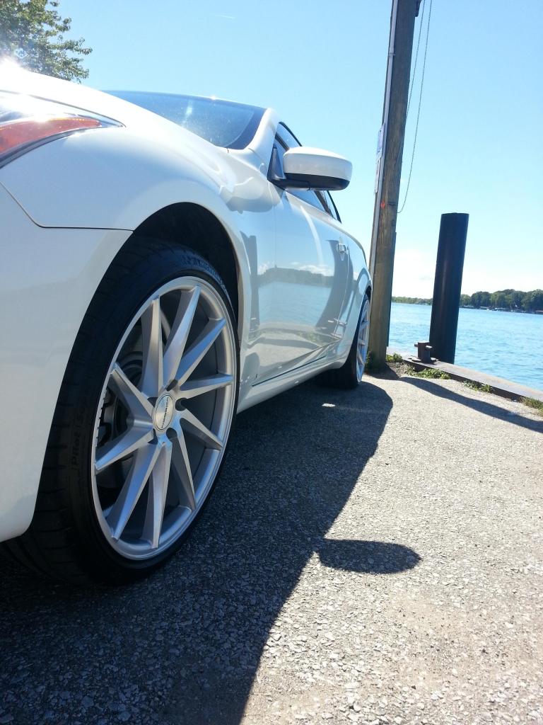

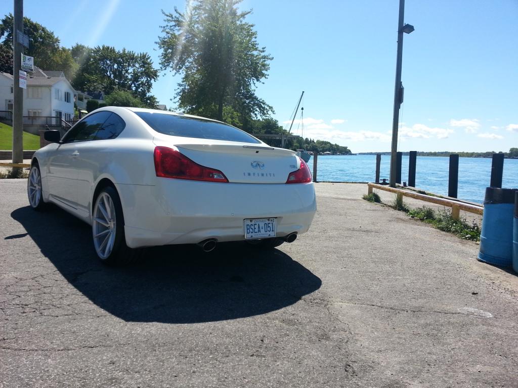

The tires on my x coupe are 20x9 +32 on the front with a 245/35/20 michelin pilot super sport tire, the rear rims are 20x10.5 +45 with a 285/30/20 pilot super sport tire. They are 0.4% difference in diameter.
I have only had the car for a year, and no issues yet.

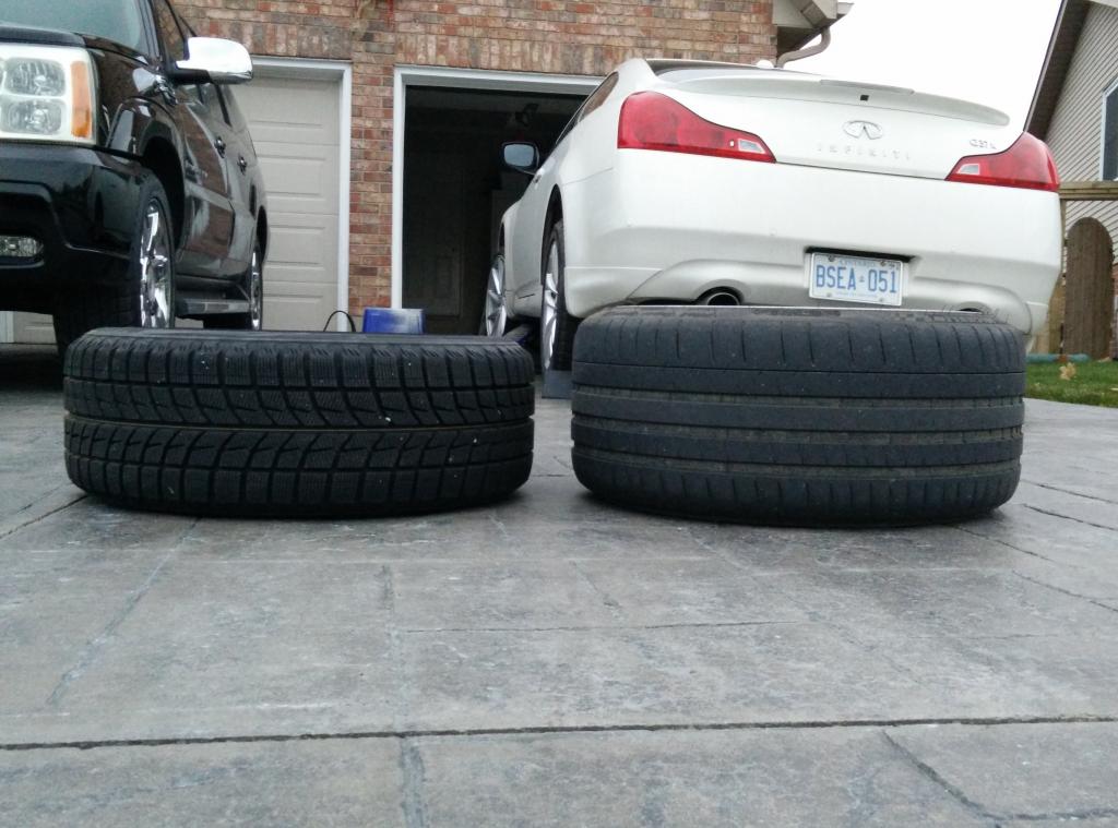

here's a pic of the stock rear tire size vs, the 285/30/20 that i have on the rearName:  2014-11-16170036.jpg
