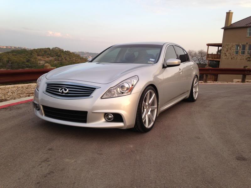

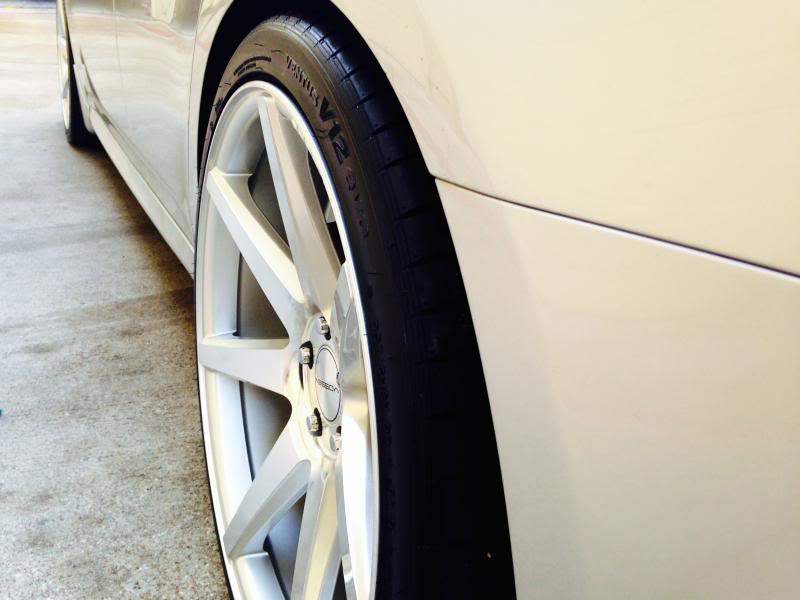

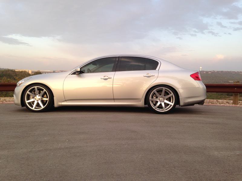

13 G37S
20x9 +32 20x10.5 +45

Originally Posted by pebkac
13 G37S
Looke great!! What are you lowered on? Did it require a camber kit?
Tire sizes?
Old Jun 29, 2014 | 12:32 PM
pebkac's Avatar
pebkac
Posts: 241
Likes: 22
From: Austin Tx
Thank you!
I'm on an Eibach prokit.
20x9 +32 on 255/35/20 and 20x10.5 on 285/30/20
My toe is within spec, and that's all that matter to me right now.
