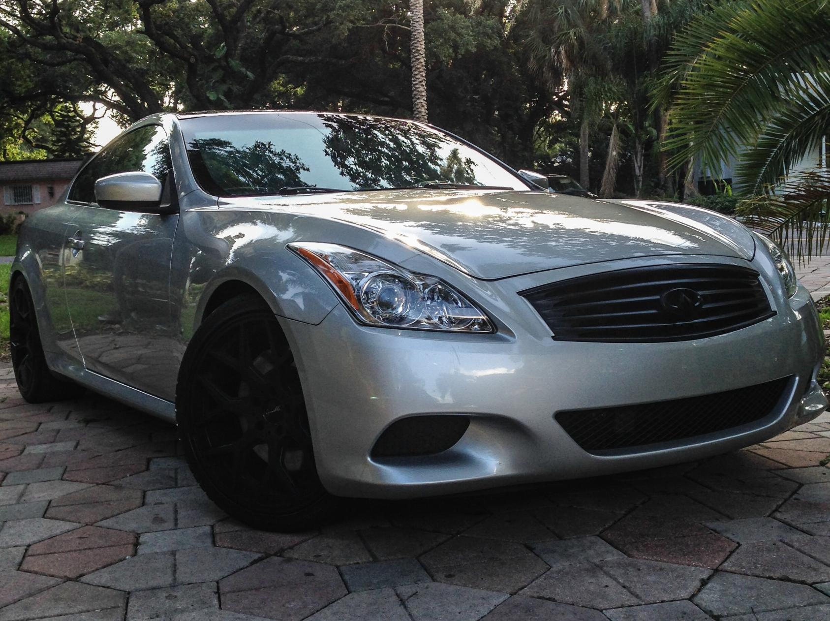

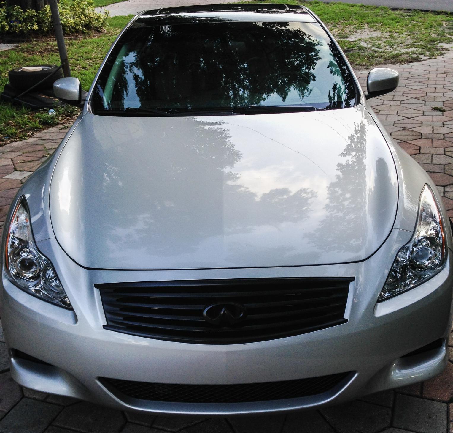

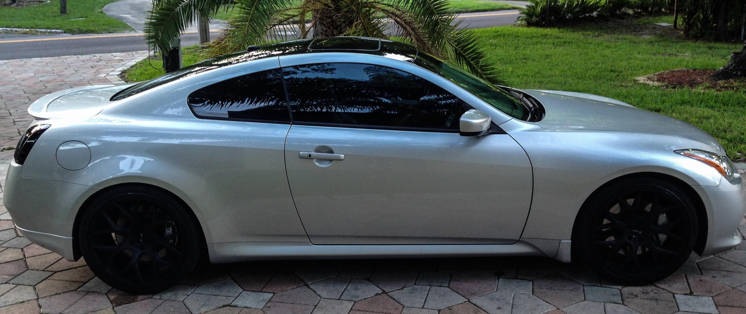

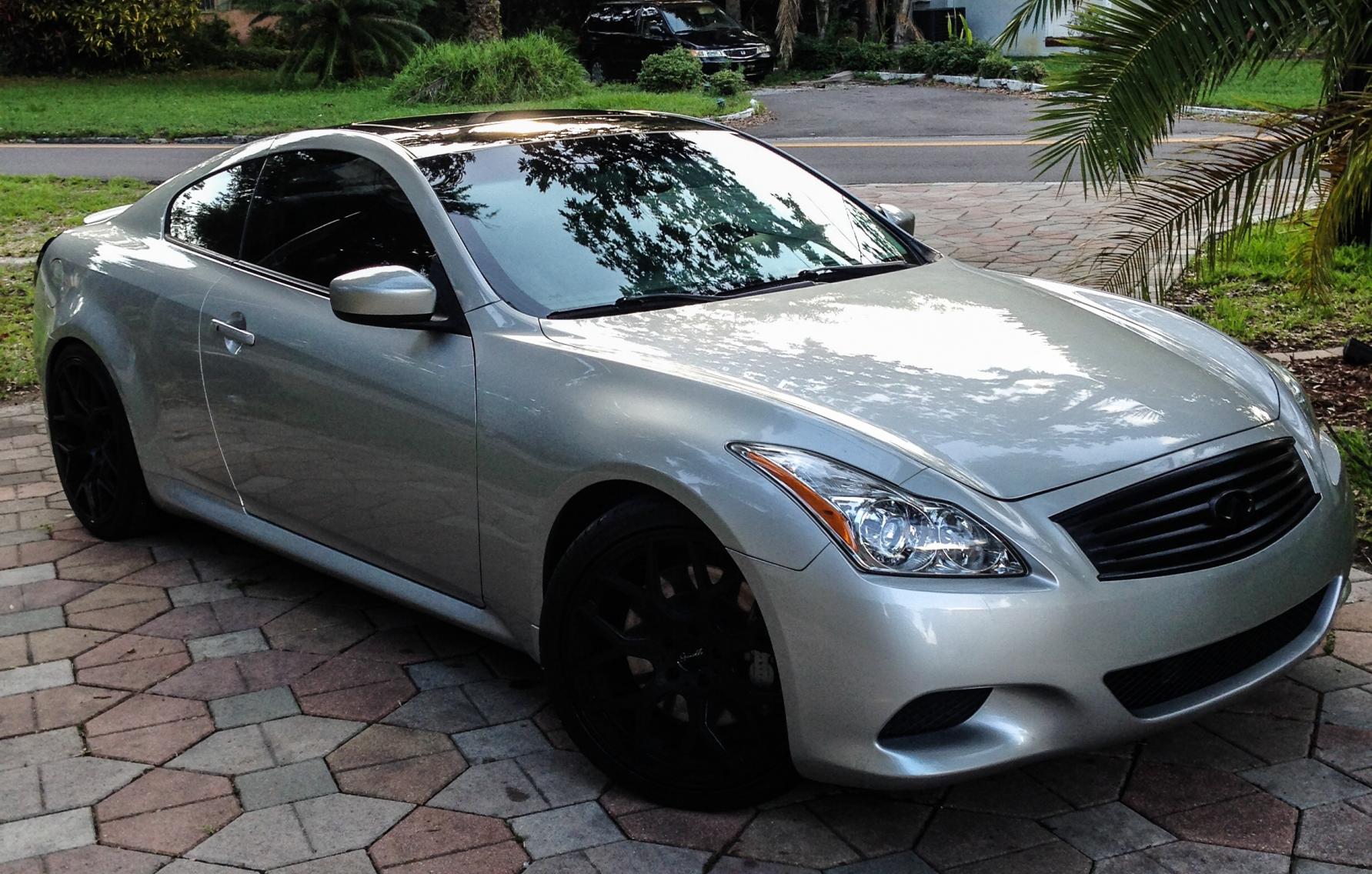

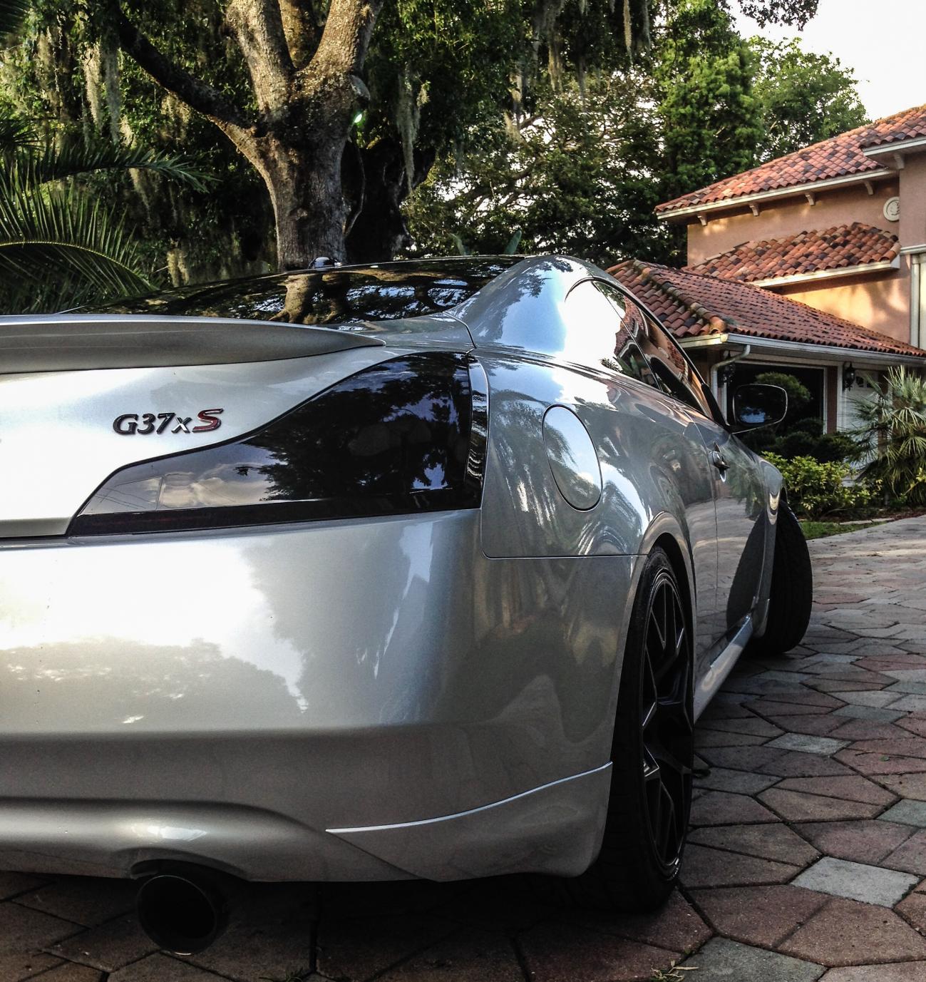

Hey guys! I am extremely close to making my decision on the 20" CV3s on my G37s coupe! With what I have installed on the car, would you guys think it'll look good? If so, what offset should I get? Im not too familiar with numbers. I dont want an extreme concave or aggressive look. As flush as possible. Thank you!
Attached Thumbnails CV3s on my 09' G37s coupe?-img_1619.jpg   CV3s on my 09' G37s coupe?-img_1620.jpg   CV3s on my 09' G37s coupe?-img_1624.jpg   CV3s on my 09' G37s coupe?-img_1625.jpg   CV3s on my 09' G37s coupe?-img_1632.jpg
Old Jun 17, 2014 | 12:24 AM
Looks like you have a pretty good fit w/ your current wheels/tires. I'd just use those sizes/offsets as a baseline, then plug them into this calculator on the top line and enter the CV3 wheels and desired tire sizes in line 2 and take it from there.
https://www.myg37.com/forums/tire_rim_calculator.php
Do you want a staggered set or square setup? If staggered what widths F&R?, etc.
For example a 20x9" front +30 running 245/35/20 and 20x10.5 rear +30 running 275/30/20 would be something that should be in the ballpark.
