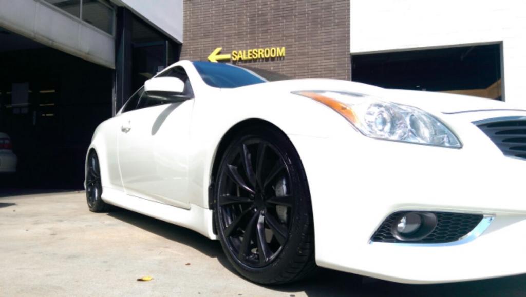

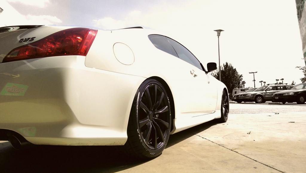

Well the tires wore out evenly and I had an alignment like 8 months ago now. I havnt gone over any crazy pot holes.
I went with 245/40 on the front and 275/35 rear. It actually feels smoother, but it can be that they're new too.
See below
