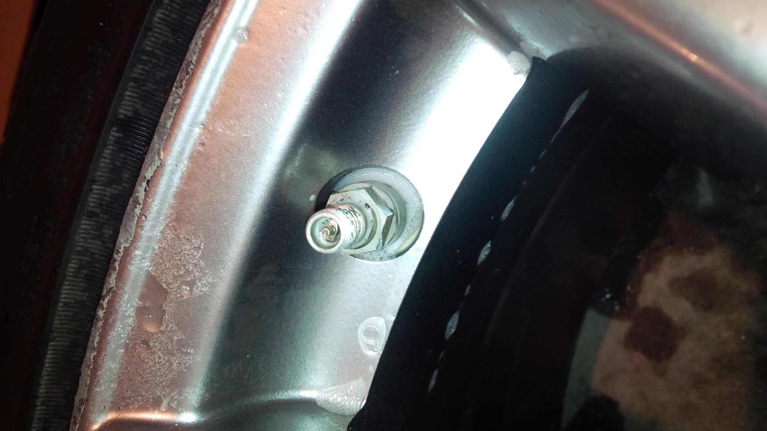

I did the soap test on my front two wheels. They both are leaking where the collar meets the valve stem and at the base of the collar. My guess is the rubber seal on the inside part of the wheel is old and useless. I tightened the collar but the bubbles kept coming slowly.
The
TPMS rebuild kits (Schrader 20014) TPMS rebuild kits (Schrader 20014)
are a $3 each at my parts store which is nice and cheap, but dismounting, remounting and hunter roadforce balancing seems like it may cost a $150. Contemplating waiting til I need to replace the tires to do this. They've got another 2 summers if I am lucky.
Can anyone confirm that the rubber seal is indeed inside the wheel??
Here is a pic of the bubbles on my dirty, rashed wheels
