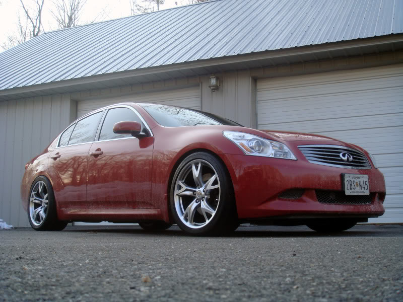

Z 19s fit the coupes real well but a bit aggressive for the sedan, without a drop the rears will poke out of the fenderwells, even w/ a mild drop they'll probably poke a bit. About the widest tires you can run without problems would probably be a 275/35/19, the fronts will be OK w/ 245/40/19s. If you drop it pretty deep you could run 285s w/ some excess camber.

As you can see the rear offset is real aggressive, even at that zero-gap drop they're right on the edge. If you keep the stock height they'll be out about a 1/2" or possibly more.
