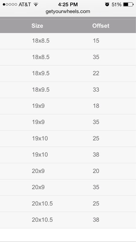

Sweet. What about the offsets
Could I run 19x9 +35 in front and 19x10 +25 in rear??

Having an X you really "need" to have almost exact diameters front & rear so the tires you have to have for the best setup would be those 245/40/19 285/35/19, that said those will fit up just fine on those wheel sizes. The rear offset "should" be fine but I'd run that wheel in the tire calculator to be sure.
Here's the numbers based on your stock setup~
It looks like it will extend about 39 mm out from where you are now, I used a 8.5" +45 offset for your stock set, here's the calculator and not sure on your rim width but I entered 8.5", but the offset is correct for your X. If the 39mm is too much you can always go w/ the +38 and get spacers to flush it out.
https://www.myg37.com/forums/tire_rim_calculator.php

Having an X you really "need" to have almost exact diameters front & rear so the tires you have to have for the best setup would be those 245/40/19 285/35/19, that said those will fit up just fine on those wheel sizes. The rear offset "should" be fine but I'd run that wheel in the tire calculator to be sure. Here's the numbers based on your stock setup~ It looks like it will extend about 39 mm out from where you are now, I used a 8.5" +45 offset for your stock set, here's the calculator and not sure on your rim width but I entered 8.5", but the offset is correct for your X. If the 39mm is too much you can always go w/ the +38 and get spacers to flush it out. https://www.myg37.com/forums/tire_rim_calculator.php
Okay so then I can run 19x9 +35 offset all around and I'll be good? Also would 19x10 be any big difference?
