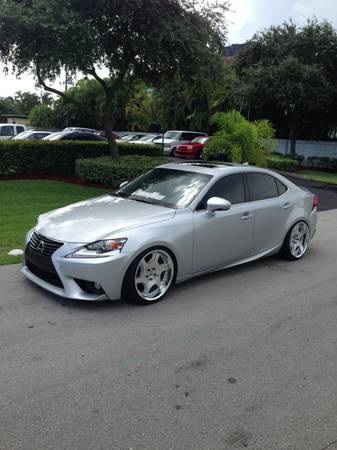

Ok, so I'm coming from a nice set of agressive offset 20" Work VS-XX on my G35 coupe. I love them. Now I have a G37 sedan, and I need something with less agressive offsets. I have a chance to pick up a set of 19" Weds Kranze Bazreia 19x9 +18 and 19x10 +25 in like-new condition for $2,200 with no tires. They're a bit outside my budget. I also have sport brake bbk and not sure if it'll clear.
How do these compare to Work as far as quality?
Good offsets for G37 sedan?

Attached Thumbnails Work vs Weds (and fitment on G37S sedan w/ sport brakes)-image.jpg

Offsets are going to be a problem unless you plan on dropping pretty low and running excess camber. Should be some high quality wheels though.

Run a 225 on the front, 265/275 rear. Lower the car/buy camber kits, run -2 to -3 camber at the MOST. Will fit not issues as long as they clear bbk without the need of spacers...

As long as those clear bbk and you run stretched tires they will fit fine

you have to ask about the Disks sizes on the wheels for clearance check with Akebonos.
