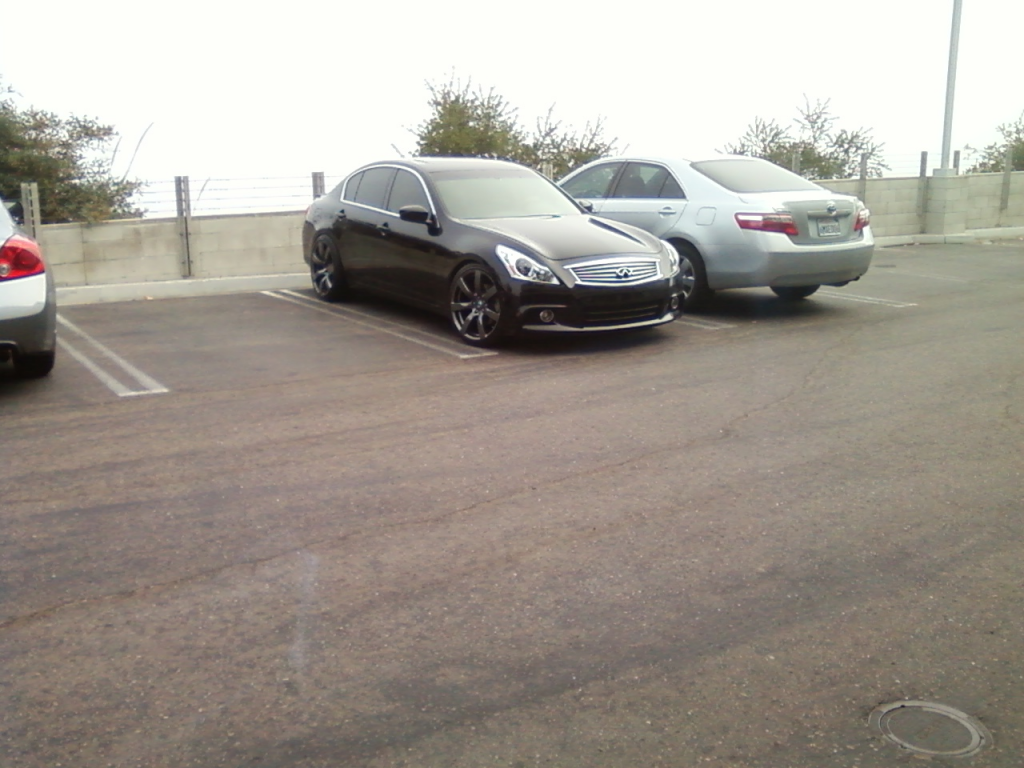

Found a great local deal so I decided it was time! The tires that came with the wheels were damn close to brand new and I had to rip them off due to the height of the tires, which sucks..
245/35/20 fronts (should of went 255/35/20) and 285/30/20 Rear.
Definitely rubs when there is added weight to the rear of the car. I need to eliminate this. Any suggestions?
Was thinking of dialing a little negative camber and a set of anti roll bars. Can the factory camber be adjusted to the rear, even if slightly?
Here is a terrible camera phone pic (Galaxy S4 broke so I'm left with a flip style phone for now.)
Pictures really don't do the look justice. It's very aggressive looking! Couldn't be happier with the outcome.
I'll add some better pics this afternoon.

Nice man looks good. As for the rubbing either go with a 275 tire or pick up a rear camber kit

spc rear camber kit with toe bolts, done....looks great, i'm rocking GTR wheels on a coupe

Rear camber & toe bolts are relatively cheap. I think the SPC kits run under $200. I have the SPL kit which is quite a bit heftier and a little more expensive. I believe there is at least one other sedan running the GTR wheels.

Thanks! I'll look into it. Do you know if a shop can modify the factory camber?

yes, camber & toe (once you get the bolts installed).

So all I need are bolts? Whats the point of the kits then? Sorry, I'm new to suspension modding. I've done a lot of searching but haven't found needed info.

The rear camber arms allow adjustments to the camber.
The rear toe bolts allow adjustments to the toe (you need to have the toe within specs unless you love spending money on new tires).
The rear camber kits are relatively easy to install but the toe bolts will require some Dremell work.
Just remember to get an alignment after any major suspension work.
I am lowered on coilovers but only have rear camber arms. I did not need toe-bolts to get within specs.

Thanks!! I wanted to do the window trim as well. Specs are 20" x 9.5" +20mm offset (front) 20" x 10.5" +20mm offset (rear).
I'm going to take it to an alignment shop after work to see what they can do. Was reading somewhere on here that you can dial about 1 degree neg camber with stock arms.
When I finally get some decent pics, ill probably go nuts lol. Next project - BIG BRAKE KIT!
