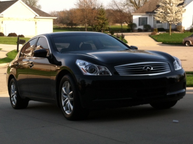

These are 245/50/zr17's on my 2009 G37x. General G-Max 03's
