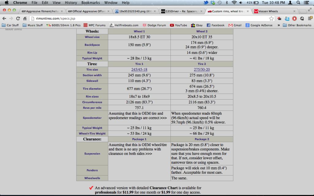

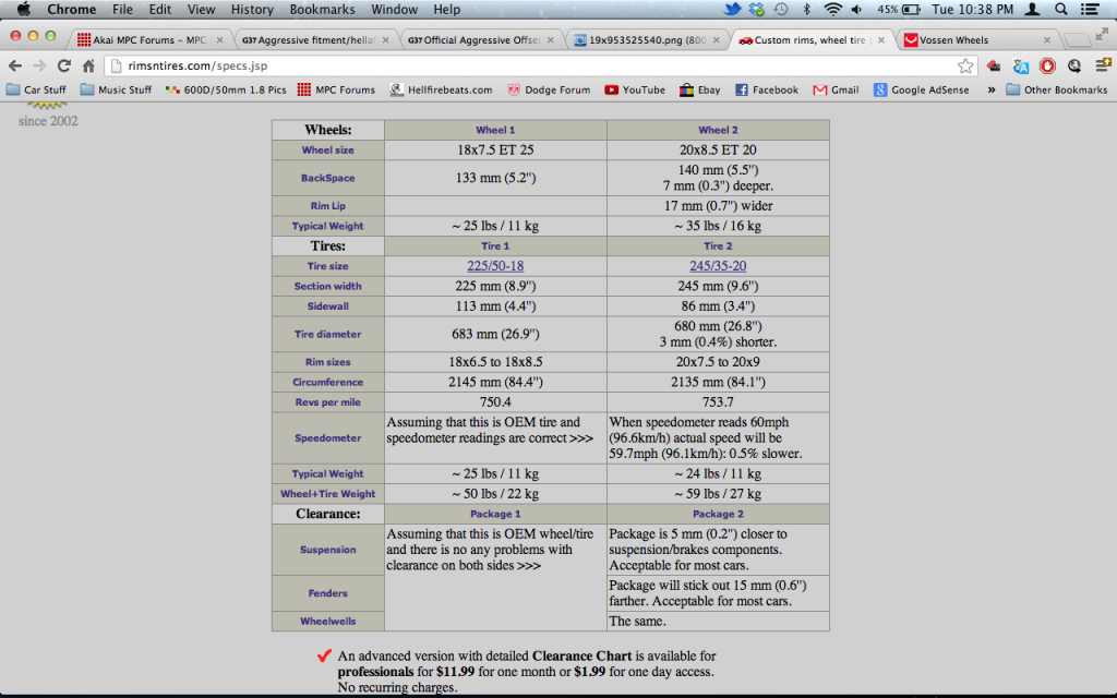

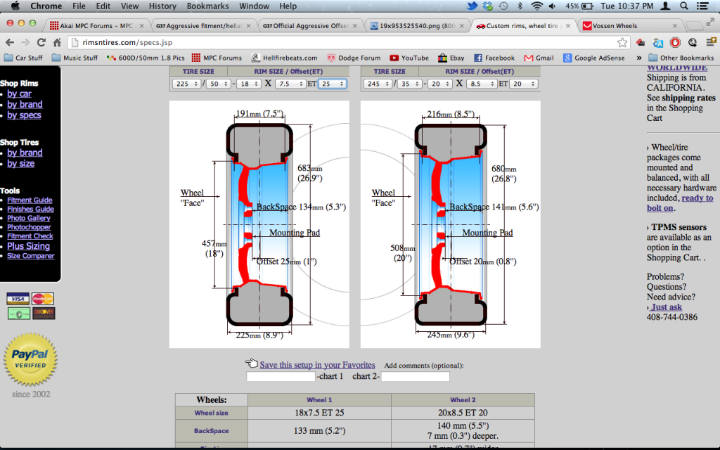

I'm doing the math with rimsntires.com and it's looking like I can swing the +20 Vertini on the front with no issues since it's only 8.5" wide, or even a +25 if they make them. I'm already running 20mm spacers on the stock wheels, so my offsets are currently +25 in the front and there's definitely another 1/2" to safely go more aggressive.

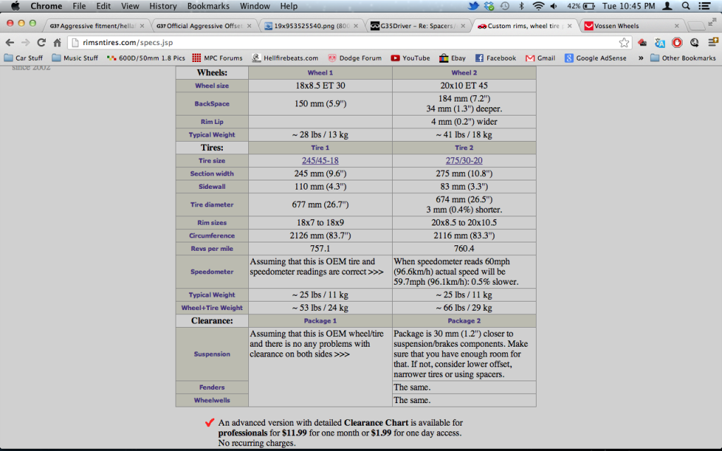

For the rears, both the +35 and +45 would definitely work without rubbing. Just the issue of clearing the rear caliper, which is much smaller than the front and shouldn't be an issue I would think!
+35 Rear

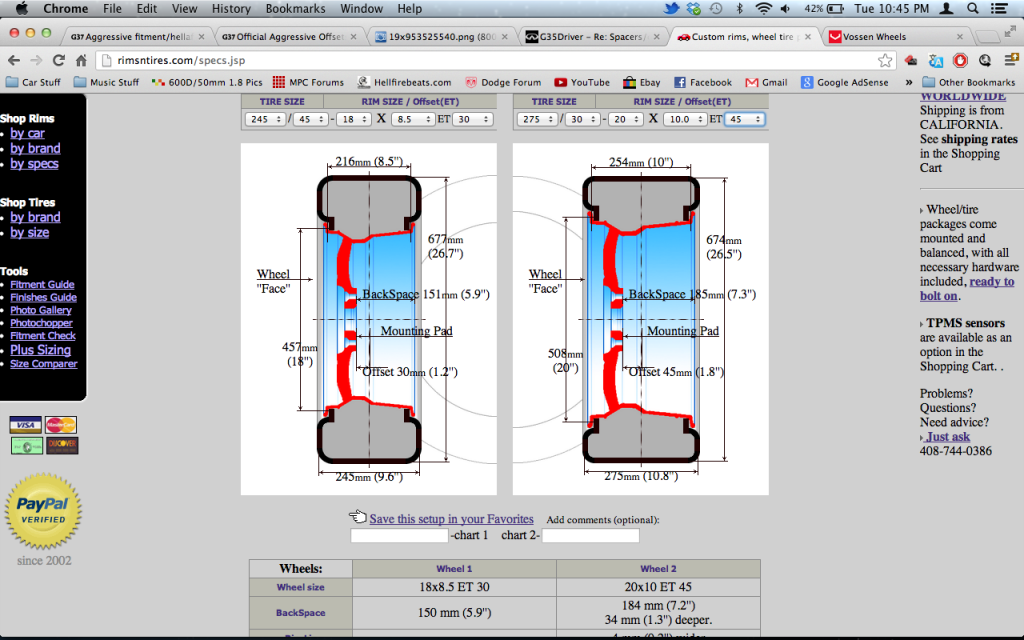

+45 Rear

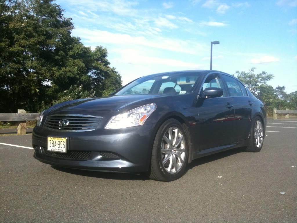

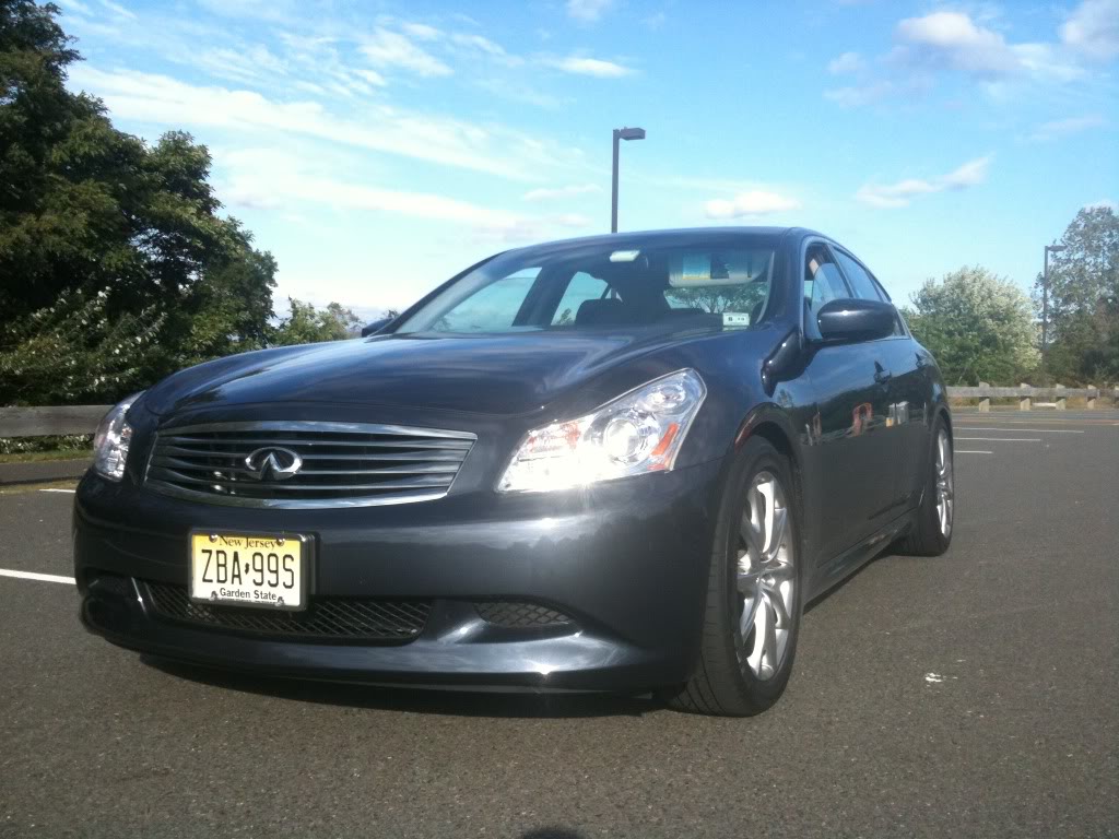

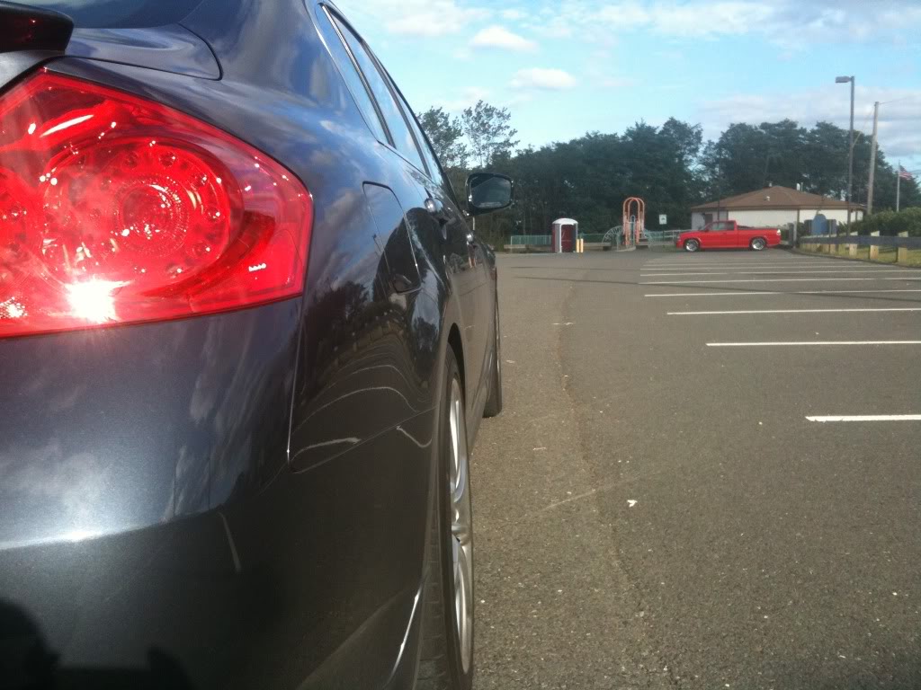

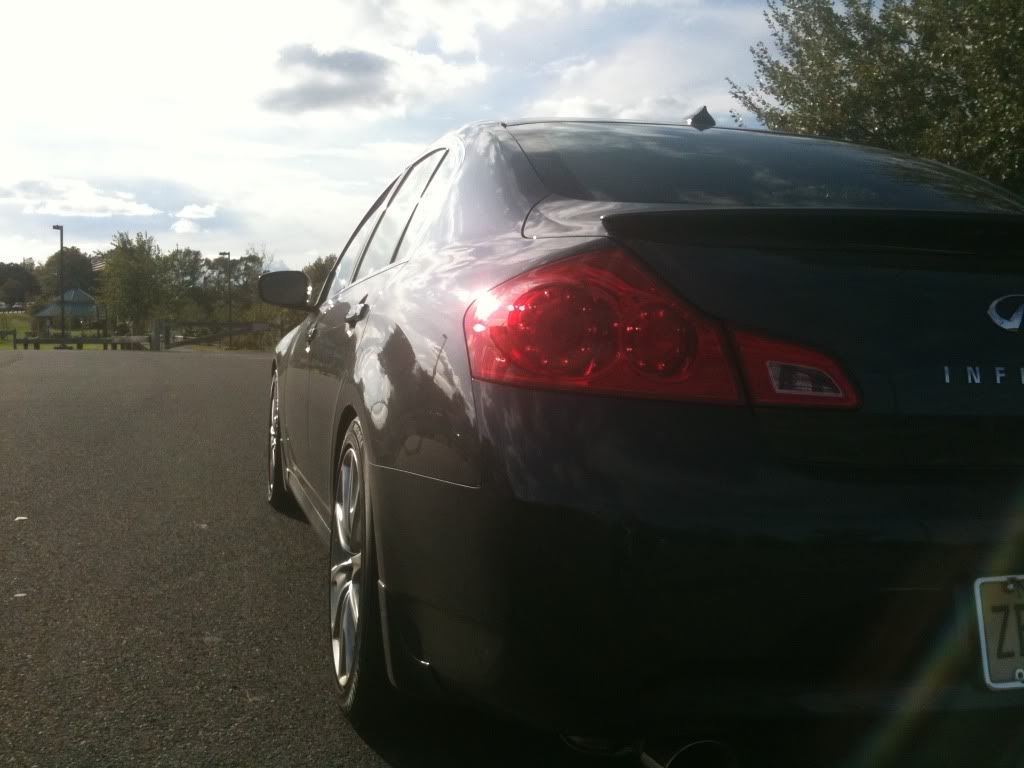

And here's my current stance. I definitely wanted to go at least another 5mm wider front and back (25mm spacers). And I don't think that with the +35 Vertini in the rear bringing this wheel out 1/2" further than my current stance would cause rubbing.

I am almost 100% certain those rears will clear the rear Akebono's, they're not gargantuan by any means. Even the rear 2007 OEM sport 18s can clear the rear Akebonos.
FWIW, here's a front 8.5 +24 with 245 wide 20s. Roughly an Eibach drop and just enough space to comfortably clear the Ake's. Bit of camber.
I also feel like sharing this. And it could just be an issue with my ride. But, having the fronts flush with the fenders may clear regular driving, but i've always had trouble with it when the front suspension is loaded/fully compressed and turning at the same time, like after hitting a dip and changing directions -- the tire will rub on the fender, even when i had my BC coil dampers at near full stiff (i.e. track.)

Nice! Thanks for the info! I went ahead and ordered the Vertini's anyway! I went with 245/35/20x8.5 +25 Front & 275/30/20x10 +35 Rear. Gonna take almost a month to receive the +25's though! Thanks for all the help! Can't wait to see how this works out! I'm thinking with my mild Tanabe drop, I hope to have adequate clearance in the front!
