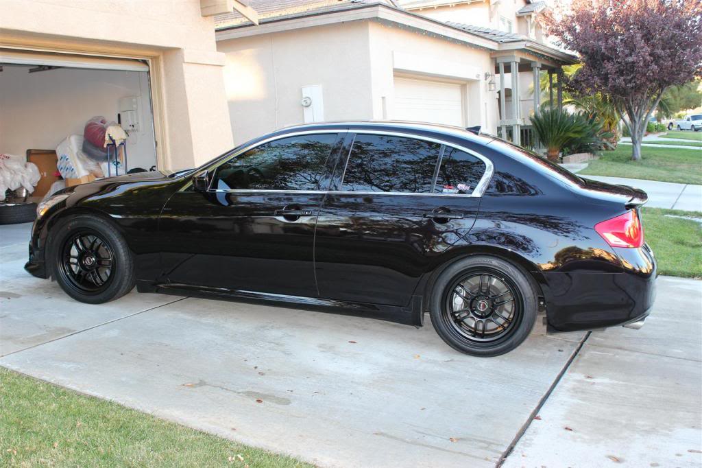

New wheels installed
Enkei RPF1's in 18 x 8.5 +30. I dropped about 13 pounds per corner going with these...

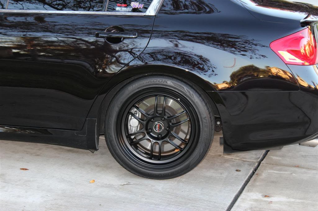

I went with 245/45/18 Hankook V12's.

Put those 4 corners on a serious diet, very nice indeed. Black window trim would finish it off nicely. Nice job!

aaah finally Macs, glad your butt like those new wheels. Now you got me seriously thinking about these RPF1s. Hows the clearance with the bbk?

I've been seriously thinking about blacking all the chrome.

Cleared it, no problem at all. These are a +30 offset, whereas the Vossens were +32. Since these are only 8.5 wide instead of 9, they sit almost exactly the same. Very flush with the well. I need to drop the fronts just a touch... easy fix (couple twists on each side).

I did keep the same size all around to facilitate rotation.
I went with the Hankooks because A: I had them on the car before and loved them aside from the fact they wore out too fast (16k miles - done) B: They are much less expensive than the Michelin PSS, and rated #2 behind the PSS in a test that was done by one of the car mags (can't remember which one).
Edit: After doing a little research, the PSS might be worth the extra coin, as they are 3 lbs lighter and have a 30k treadlife warranty, whereas the Hankook's have nada. If I go through these in 16k again, I WILL switch to the PSS.

I also use the Enkei RPF-1 in NASA and SCCA road racing. It's a great lightweight alloy wheel, but needs a hub spacer to get it to fit properly. You don't want the lugs to supply both the clamping force and load bearing properties. I assume the OP used some aftermarket 3 mm hub rings to get the RPF-1 to work properly on the G37.

Yes, hub rings came with the wheels when I ordered them. So did the lug nuts and socket.
