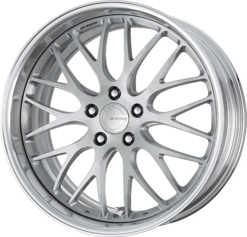

Need your advise on fitment! I've narrowed it down to these Work Wheels Gnosis HS202 Step Lip, in matte silver, for my '12 xS OB sedan, lowered on D2 coilovers. I wanted a semi conservative fit, for daily driving. I didn't want to go staggered, but with AWD, selected the below disk to get that look. I know AWD can go staggered with the correct tire fitment, but prefer not to risk it.
Work Wheel Gnosis HS202 Step Lip
20x9.5 +25 all 4 corners
2.6" lip, R-disk up front (BBK friendly for future mods)
3.5" lip, O-disk in the rear
245/35/20 for tires
How do you think these will look? Would I require any fender work? I'm leaning towards mesh wheels with a step lip, any others I should consider? I've considered SSR MS1 (too expensive), BBS LM (too expensive), Work Brombacher (require spacers for BBK). I ruled out replicas (for now).
Thanks in advance for your input!

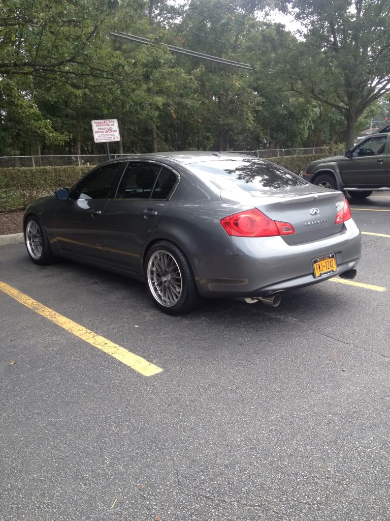

I think you should be fine in terms of rubbing on all four corners depending how low you go. I have a 2010 X sedan on D2 coilovers also. I have 19x9.5 wheels on all four corners with a finger gap and I do not rub at all. I do have 40 profile size tires and they stick out a tiny bit in the rears but no rubbing at all. Its an agressive look but I like it.

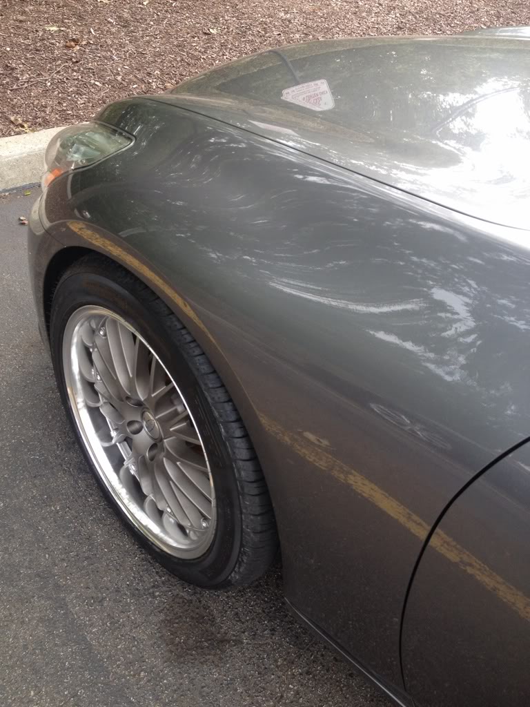

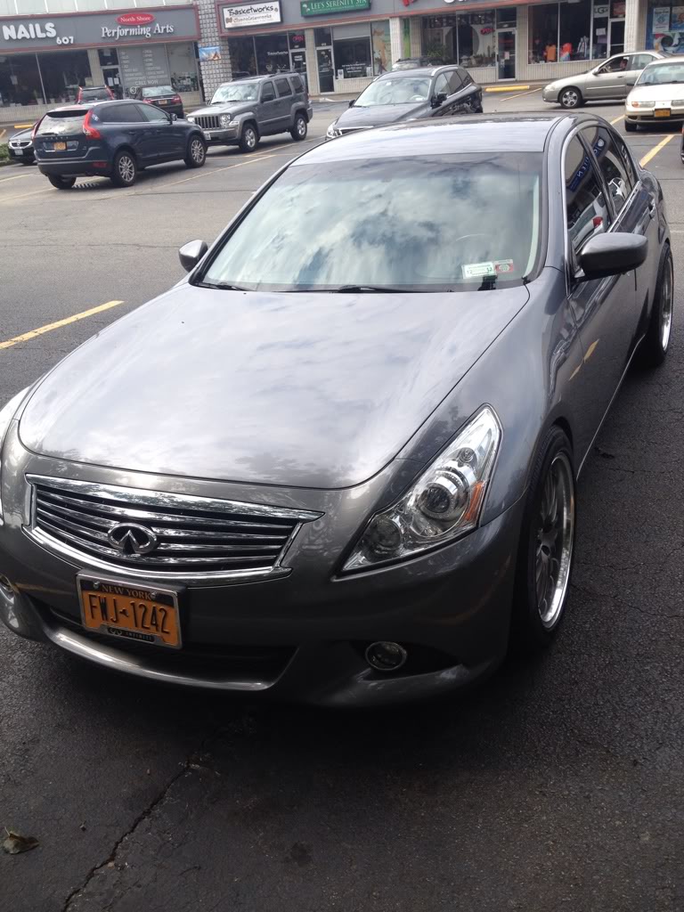

My offsets are 25mm all around and yes with 4 people in the car no rub. Havent tried 5 people and I hopefully I wont have to lol. Here are pics and like I said its a bit agressive but its to my liking.

^^ the tires you are running are too big for those offsets. As for the OP the 9.5 +25 will work fine and if you do have rubbing it might be the fender bracket

yeah his car looks like crap lmao
