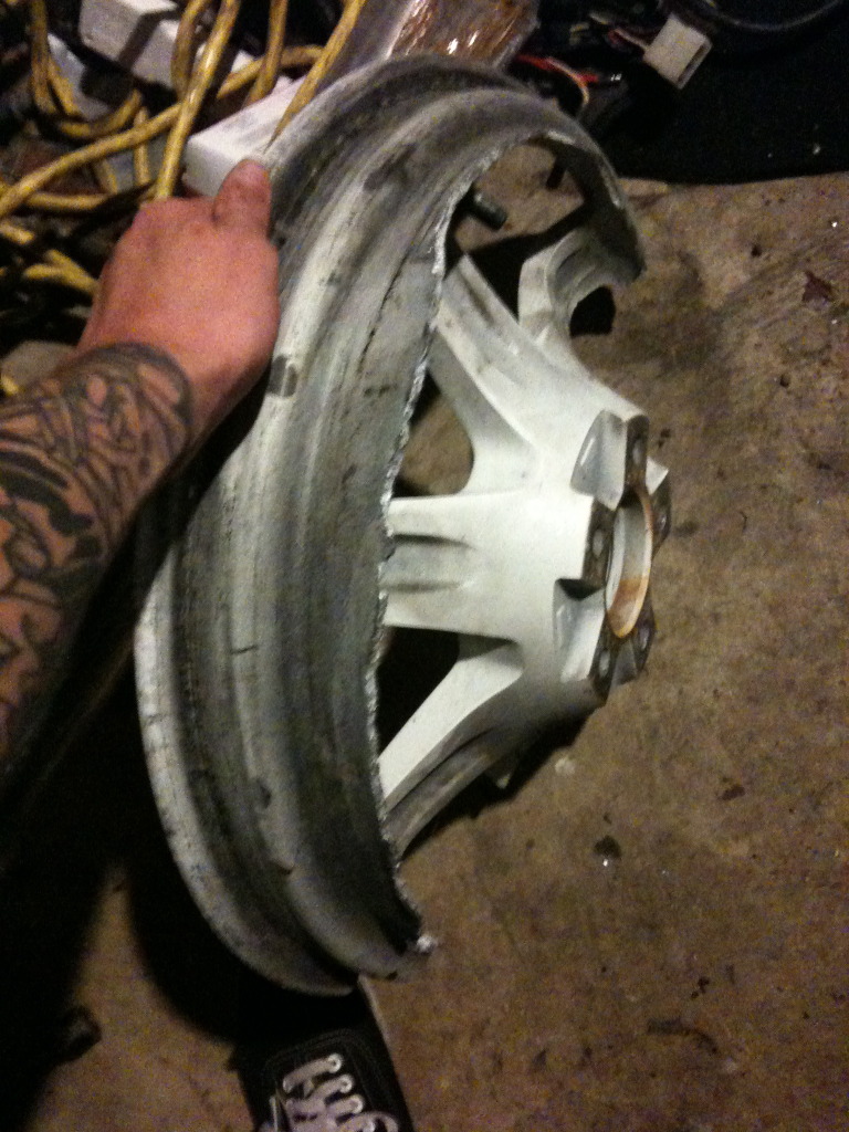

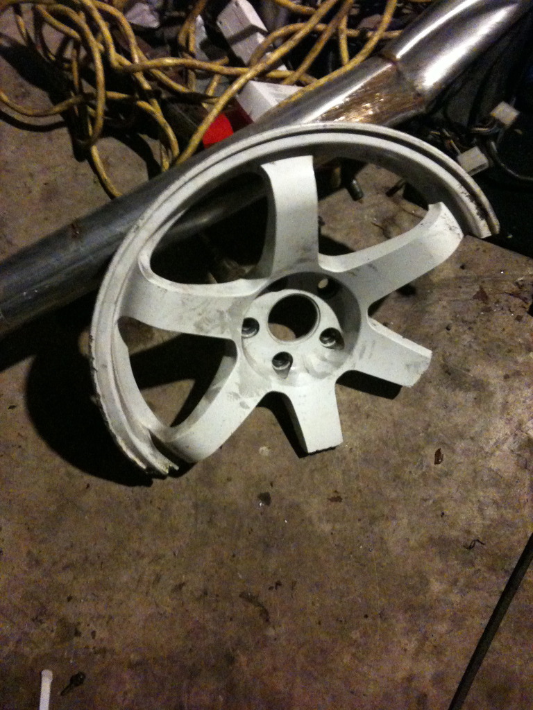

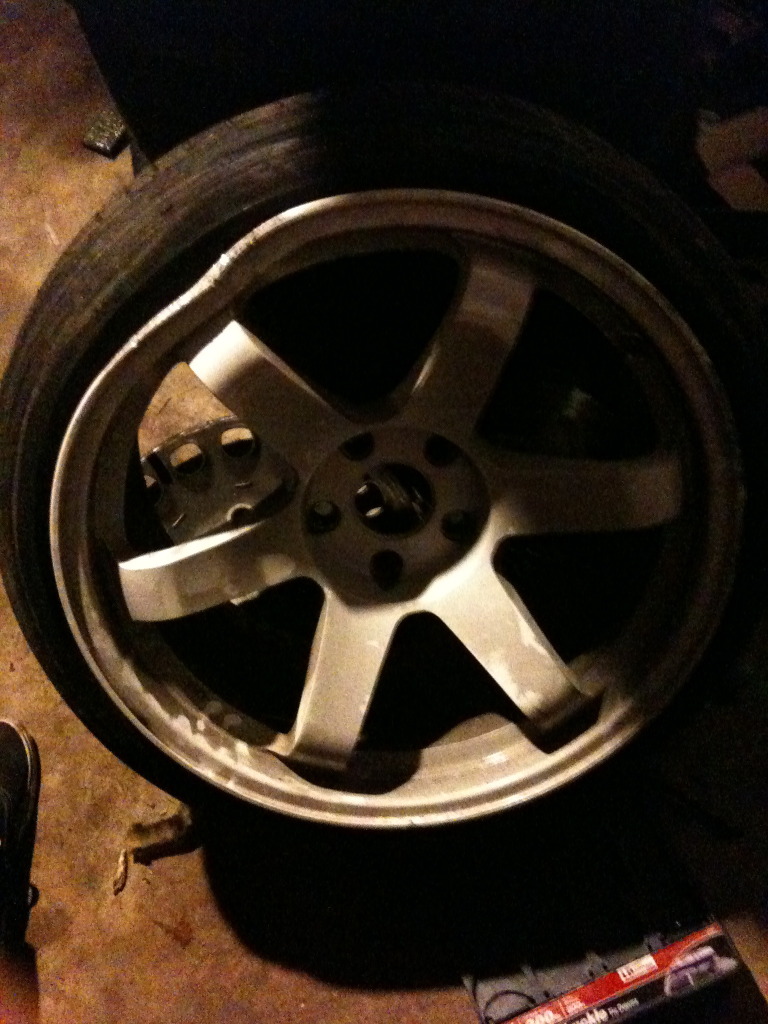

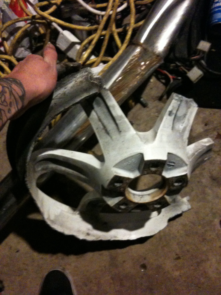

First off, I just want to say...I am perfectly fine with people running replica wheels...Varrstoen, Rota, etc...I have no angst towards people buying them or anything. I just wanted to show some pics of what can happen when a curb meets said wheels. Granted, the force of the impact with the curb was quite strong, a true forged monoblock wheel would not even come close to this kind of damage. Luckily the driver is alive without a scratch, but the wreck was pretty brutal. And for reference, ROTA GRID.
This is one of the wheels that actually made it through the wreck:
This one not so much:

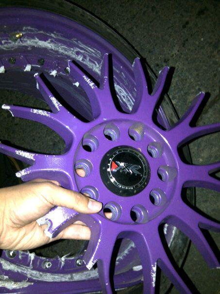

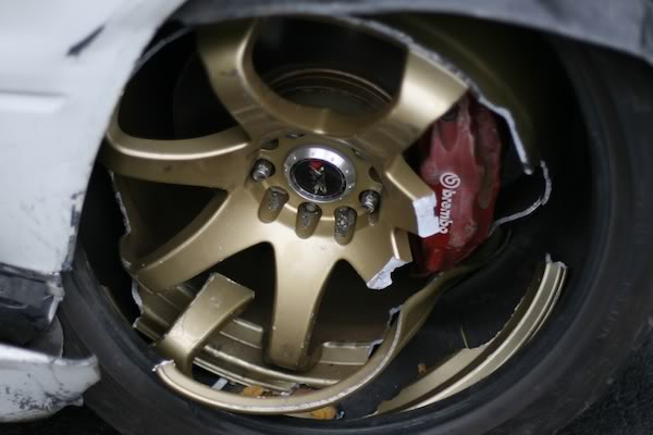

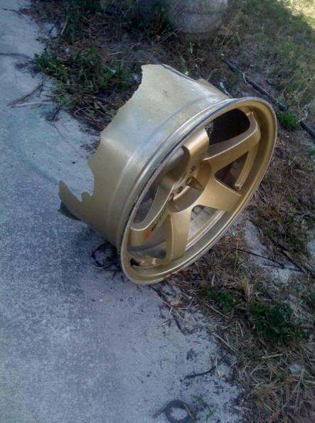

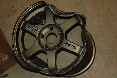

The damage to this fake wheel would not have happened to the wheel from which it was copied. The Volk Racing TE37 is a forged wheel. Forged wheels are stronger. Plain and simple. The forging process changes the structural integrity of the aluminum making it stronger than a cast wheel. There is a higher specific strength and toughness to a forged wheel. Basically, it can absorb more energy. This means the wheel, while being lighter, will also be able to handle significantly more abuse. It is less likely to crack. If one is involved in a high-speed crash, yes, there would likely to damage to any wheel. However, the damaged to a forged wheel would likely look something like this:
Authentic Volk Racing Wheel
And not like these:
Knock-off Wheels
They would bend; not break, shatter, or virtually disintegrate.
There is no enforcement like the DOT for the aftermarket in the United States. In countries like Japan and Germany, each wheel has to be registered with the government before it is allowed to be put on the market, whether it is cast or forged. That is the reason there are so many **** wheel brands surfacing all over America. In many cases, these wheels are, quite simply, extremely unsafe. Well-reputed companies like Rays Engineering, Enkei, Advan, SSR, BBS, etc... (all companies that happen to get their designs stolen all the time) ensure that their wheels pass quality and safety standards to provide a driver in a catastrophic crash the best chance at survival.
I don't know about you, but, in a bad accident, I would much rather have my wheels bend than break into pieces...
