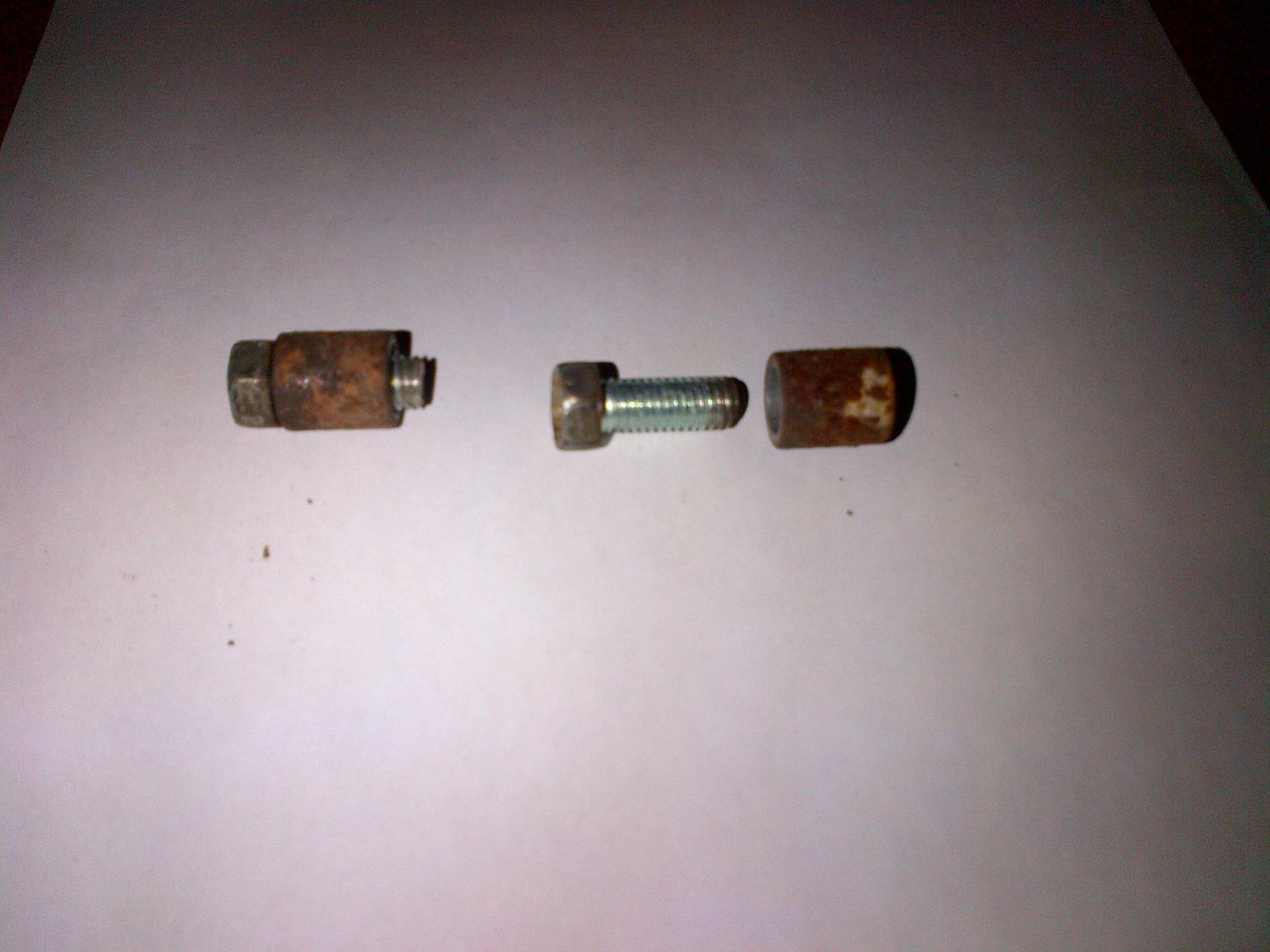

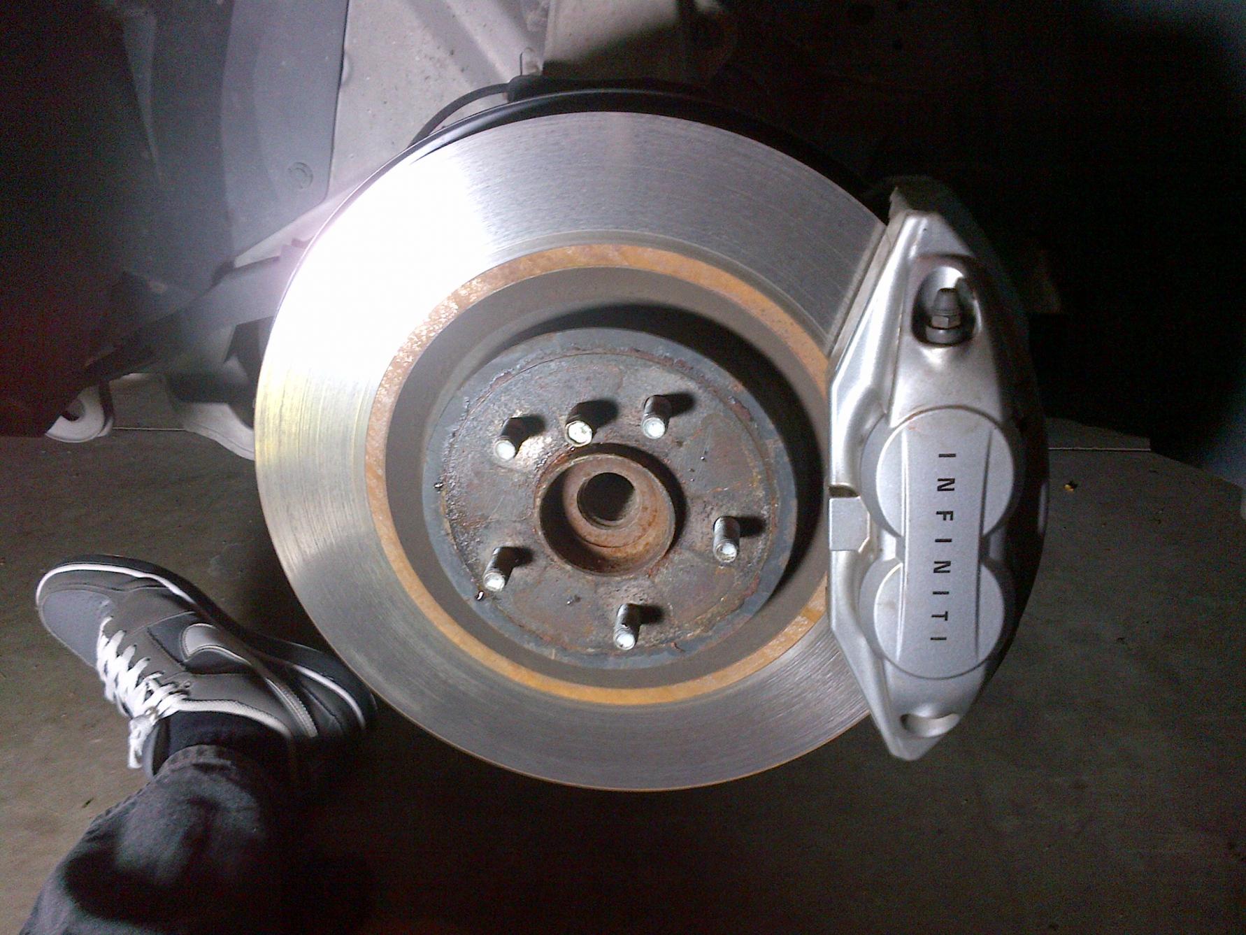

I just threw my wheels and tires on last weekend. There is a ~12mm bolt with a 5/8" collar screwed into the front rotors. It is there to prevent someone from putting your rear wheels on the front. You'll have to remove the 12mm bolt & collar to slap on your winters.
Cell phone pics attached

Awesome! Thanks for the pics- I would've been befuddled with that screw!!!

umm no
that screw is used to remove the rotor if in the case that it is stuck. You unscrew that piece, remove the washer tube, screw back on all the way and POP your rotor comes off..

wha? not according to the FSM.

That sounds like it would work if you were ever in such a situation.
I've kept these parts in a ziploc bag just in case I feel the need to put them back on in the future. I would recommend others do the same.

He won't need to take the screw out if he puts the front wheels on the front and the rear on the rear. At least I didn't have to when I put on my G35 wheels for winter.

You're right, the OEM front wheels fit over that "pin" easily.

So to recap- unscrew the bolt, remove the washer tube, and screw the bolt back in (they're after market wheels). Correct?

NO! ..whoever said that was explaining an alternate use for that bolt. He was saying it could be used to pop off a stuck rotor!
To put on your winter wheels, remove the bolt and sleeve and save it somewhere. Mount your new wheels and done.
