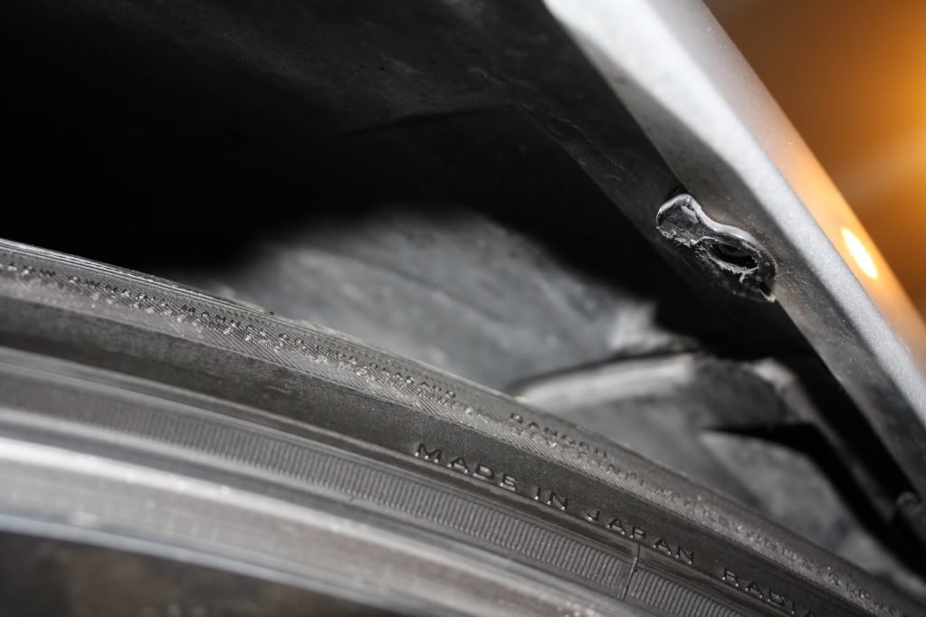

I will let these pics speak to my facts. Again, I am running 20x9 +25 with 245/35/20 tires. I have rubbed on these 4-5 spots with both Eibachs and my Tein SS-P coilovers (about 1/2" to 1" lower than the Eibachs-- I tried several heights to prevent the rubbing). I would say this is the most common size tire to run on a staggered setup. I can live with the rubbing myself, but if someone is adamant that they don't want rubbing, I usually recommend something slightly less aggressive, or at least have the decency to explain what they are in for (I guess that makes me ignorant since I don't just say "trust me" and then throw out insults).
Tire size
Rubbing fender liner (nope, no rubbing at all)
Rubbing fender clips and liner in 3 spots in these pics (notice I have rubbed the back clip completely off)
Originally Posted by dropspyder
Ok people. Here are some phone pic of the initial set up. The eibach pro-kit is coming next. I still haven't seen the car in person yet, but this is what my wheel guy sent me. If anyon'e in Houston, Central Tires Plus on the southwest side will definitely hook you up. Great prices and great service. Better pics to come soon.
I should be more flush once the eibach drop comes in. Thanks for the help so far peeps.
Looks good. Glad it worked out. Sorry, for derailing your thread, but I felt the need to respond. Hopefully, someone will find it useful.
Originally Posted by Pcasey
you could have gone 245/30 in front with a +20 with no rubbing at all...... would have ben perfect
To be clear, a 245/35/20 will rub (I stated this earlier in the thread, but not in the post you quoted). Sorry, if that was not clear. Not on turns, but bumps/dips on the clips and fender liner. No doubt a 245/30 or 235/35 would clear in most cases. The OP clearly said he wanted no chance of rubbing, and I think he will be happy with what he went with. The 245/30/20 has a half inch less of sidewall height and is almost 4% smaller than stock. That extra half inch goes a long way in protecting my $3000 wheels. If you have a show car, no big deal, but in the real world that half inch in sidewall goes a long way in protecting your wheels.
