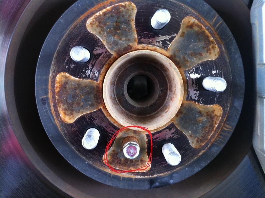

anybody know what this is

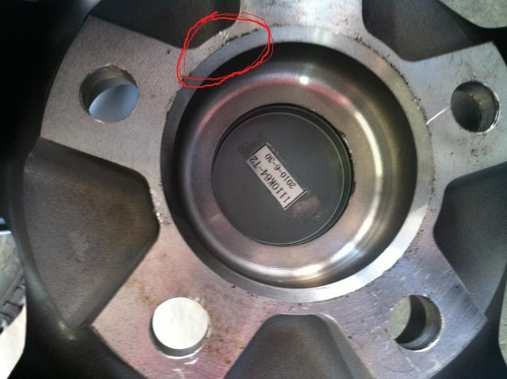

I went to get my new rims put on (much thanks to US-Autotech for hooking me up) and the tire place (Goodyear, but I live on the Texas-Mexico border in a tiny town so they dont see much) had no idea what that bolt was. It was only on the front wheels and the new wheels did not fit over it.
Simple solution was to remove it as it didnt look like it did much. But before I drive on it I wanted somebody else's oppinion.
Thanks

It's to prevent the OEM wheels from being accidentally mounted on the incorrect axle. Taking it off is perfectly fine, we all have to when mounting aftermarket wheels. You can throw them away. You're safe.
