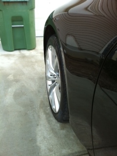

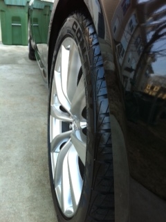

This is exactly what look I am going for. Meaning, the tire sidewall is flush with the face of the wheel. However, on this tire it has meatier tread, but I was planning to run Bridgestone RE050A.
So I figured 245 on front (8.5) and 275 on rears (9) and I would achieve this look.
Do you guys agree?
Also, I am thinking of going 45 rear and 40 front.
