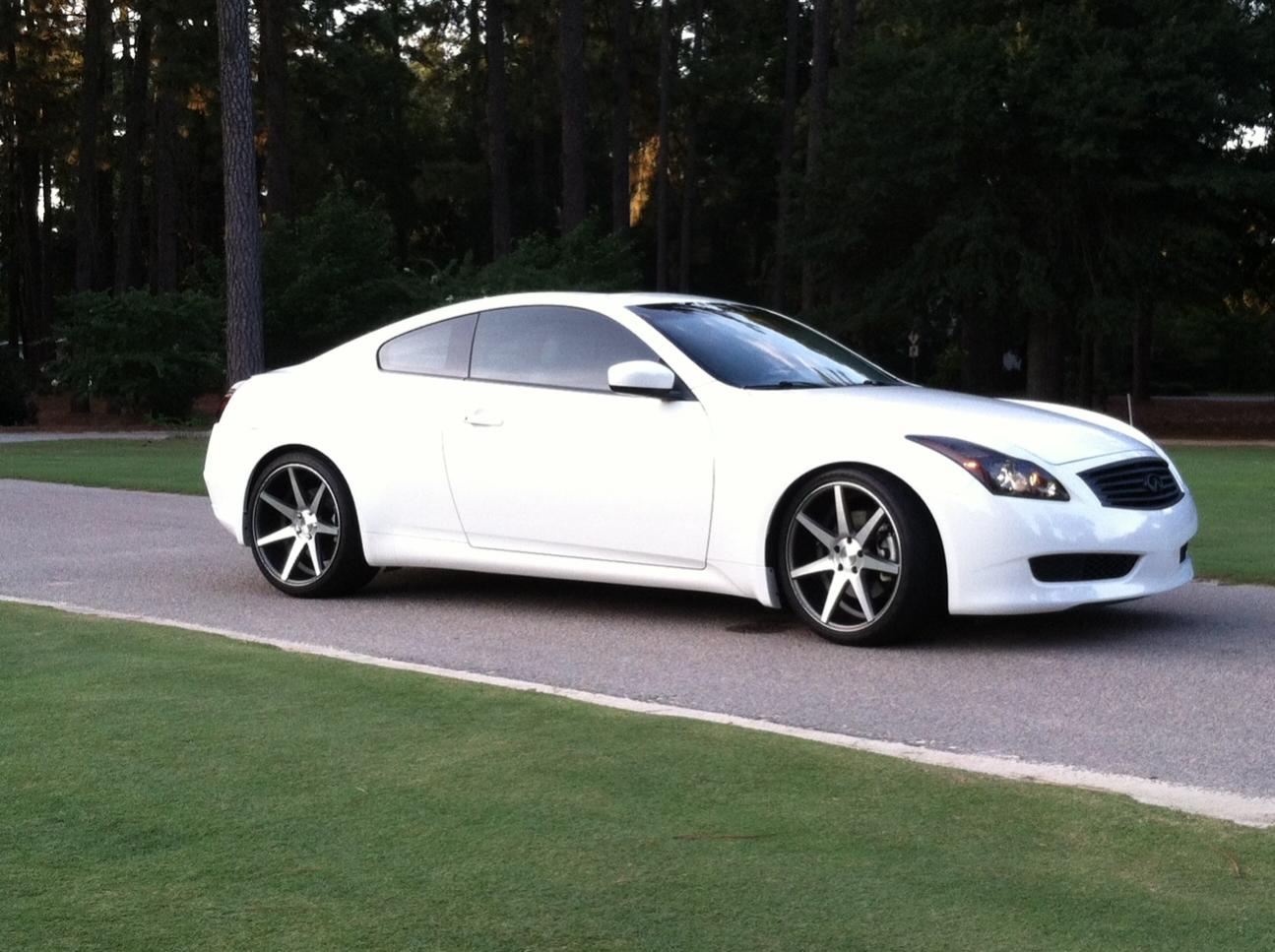

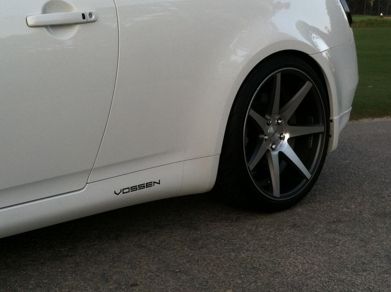

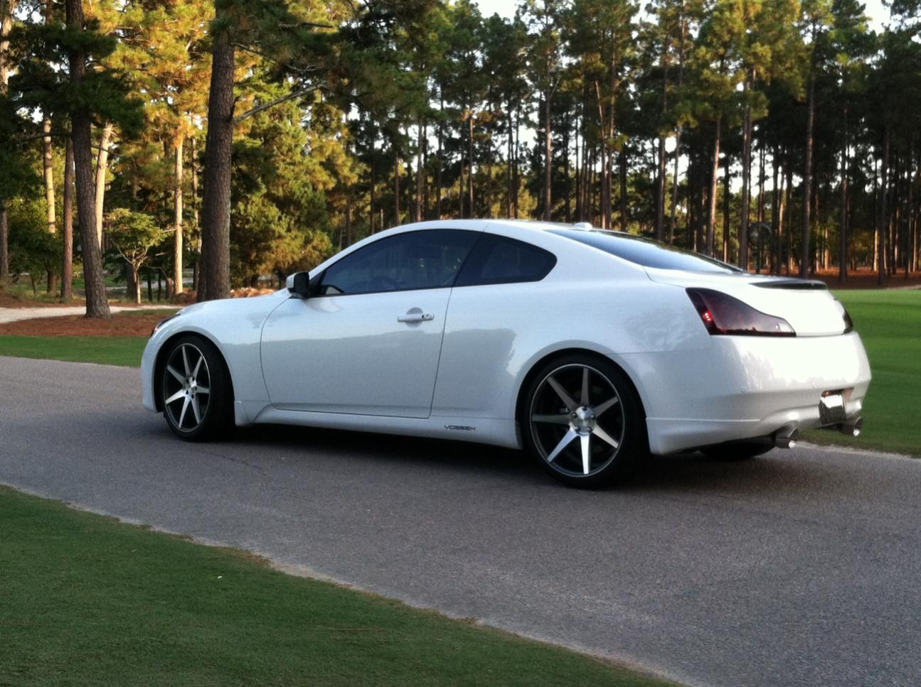

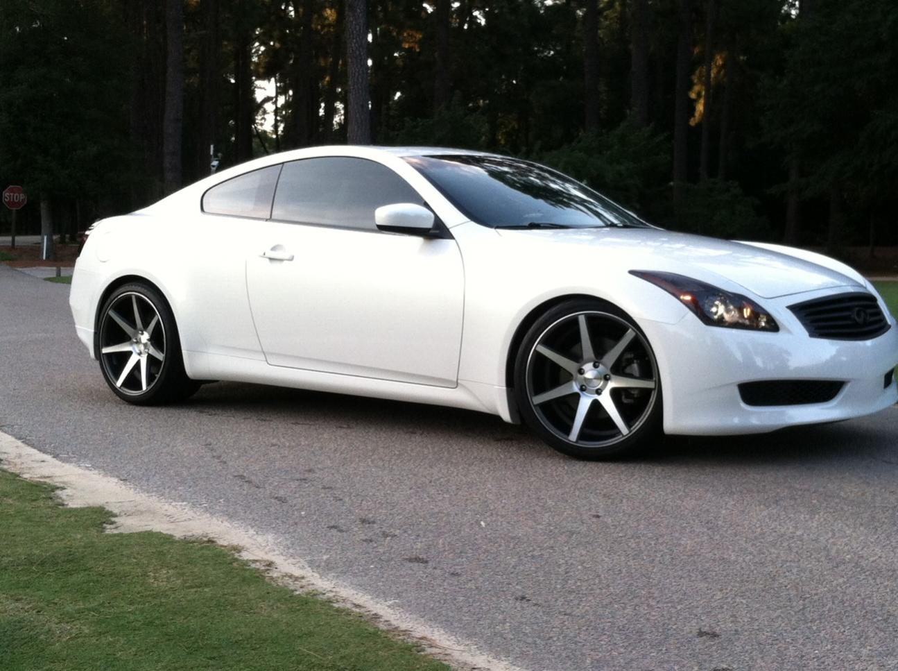

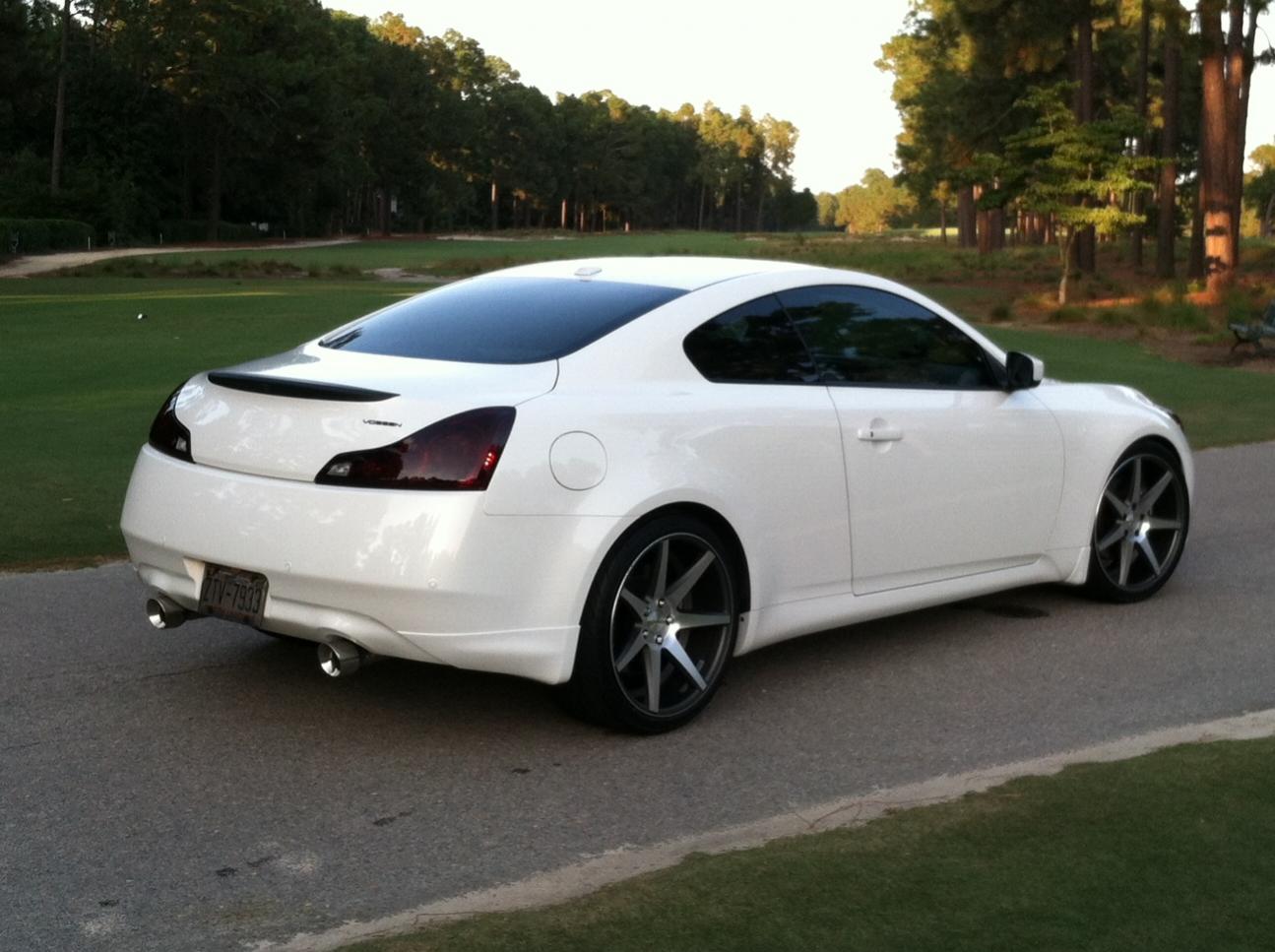

Diego hooked me up with his girl who was selling her cv7's. Matte graphite with machined face. used, but condition was flawless. 20x9, +32 front, 20x10.5 +45 rear. I have eibach pro kit and am running -1.5 deg camber in the rear and -1.6 deg in the front (basically because I do not have camber kit on front.) Rear is spot on for my tastes and well within oem spec, front is just out of oem range but still close. The wheels were made for this car IMO. I have a tight 1 finger gap in the front and a loose 1 finger gap in the rear. slightly raked. In a perfect world I would drop the rear maybe 1/4-1/2 inch but it's real close to perfect for me. Wheels do sit exactly flush with top of fender and the tires are not stretched. Tire sizes are: 255/35/20 & 285/30/20s.
Diego was great to work with and help me through the process. Wheels are beautiful and I would definitely recommend them to anyone. Diego, I'm advertising for you buddy, I put some of the vossen stuff on the car. Rice? Maybe but it's the tuner boy in me that loves the stickers! Thanks again for everything Diego!
