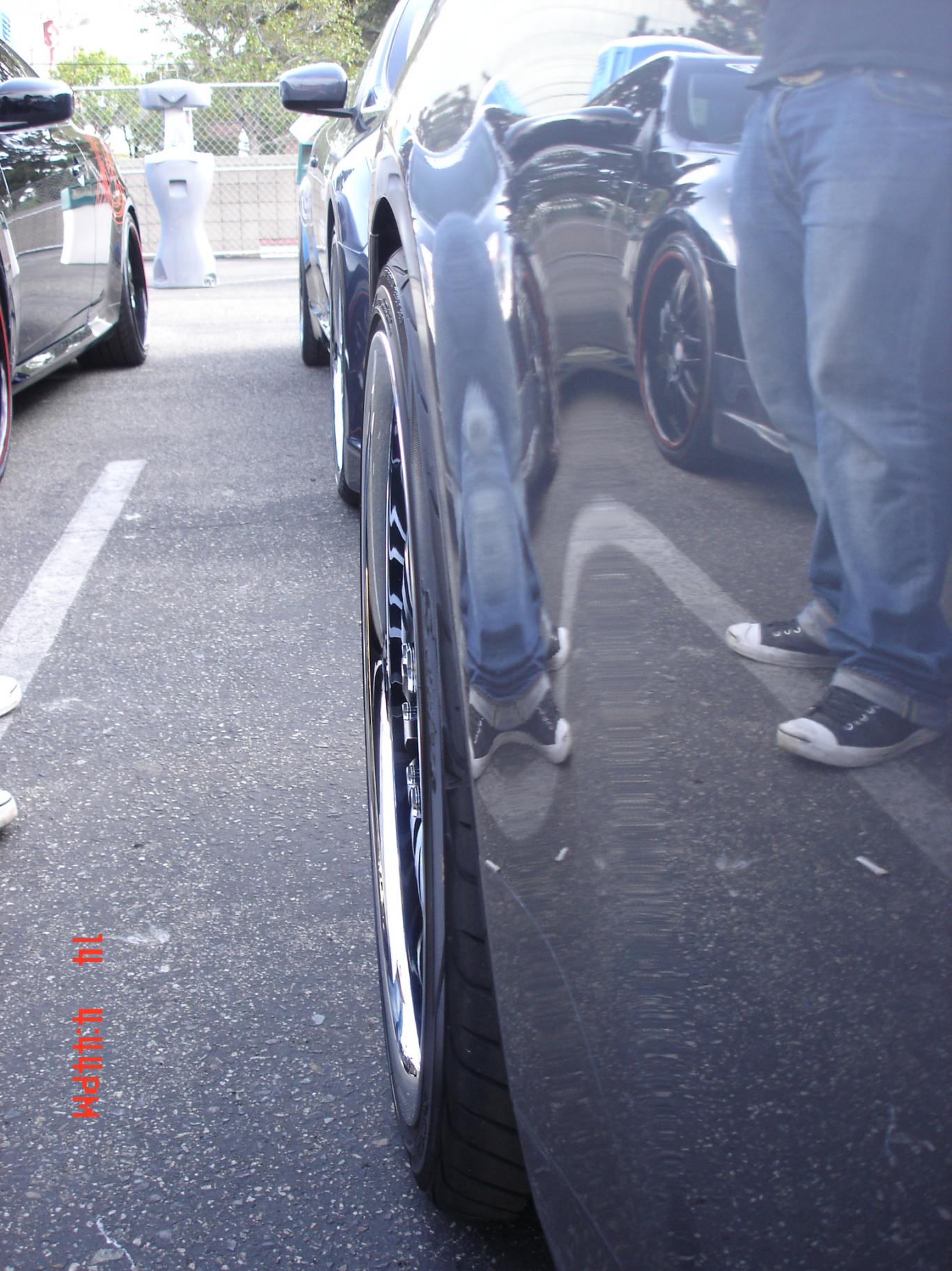

I think you will rub in the rear. I have Eibachs and custom offset. My rear is 32 and it's pretty flush. If you look down from the fender, you'll see the lip stick out by a few mm, which is fine. But I think with 25 in the rear, you will rub. I already did with 32 offset on Yokohamas (granted, half of it was due to the tires).
+1 on what Wei said.
I don't imagine your wheels to be cheap. And you're probably gonna pay good money for them. So why not go custom offset (like iForged?), haha.
If you have H&Rs like Solis then it'll get more tucked from it being lower. But you have Eibachs like me, so you're looking at a more aggressive version than what I have (see pic), by a good amount too.
EDIT: just dug up my alignment specs for you, I got -1.4 camber in the rear.
