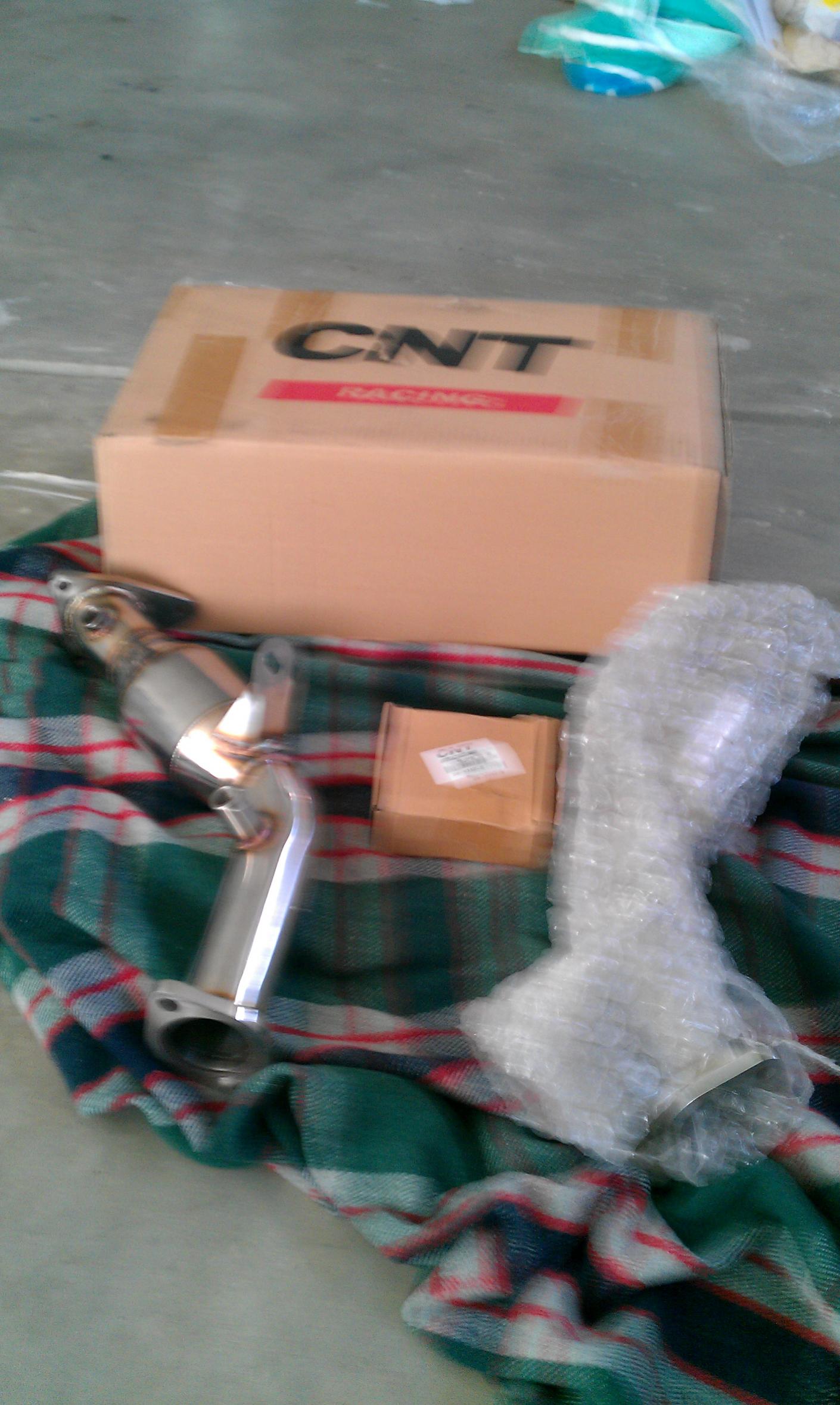

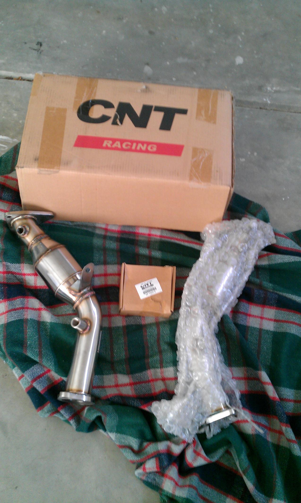

I recently purchased a set of brand new CNT ERZ HFC's from another member on the370z forum. Everything was still new in the original box with the gaskets,bolts and extended bungs. I dropped my car off at the shop yesterday to have everything installed and get a call today that the HFC's gaskets are leaking. They weren't sure what the issue was but there was a definite leak in the system and they would remove them and update me. Upon inspection they noticed the flange was not straight on either side and that is what was causing the leaks. Rather than wait for them to be shipped back to CNT my shop to the initiative to grind down the flange until they were straight and reinstalled them.
They txt me pics along the way to keep me up to date on the process. I didn't even have to ask them, they did all of this on their own.

Attached Thumbnails CNT HFC Fitment Issue...  Buyer Beware!!!-imag0014.jpg   CNT HFC Fitment Issue...  Buyer Beware!!!-imag0012.jpg   CNT HFC Fitment Issue...  Buyer Beware!!!-photo-60-.jpg

I had no problems with my CNT HFCs. I'm still rolling with them after 2 years. I think I remember this was an issue with earlier runs. Any idea how long the original owner had these?
And have you contacted CNT to see what they'd do for you?
