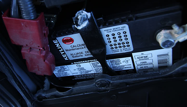

Infiniti covered 100% of my 3.5 year old battery from my 2008 G37S Coupe. I had battery loss issues twice in the past 2 months so I made a service appointment at the dealership. They reprogrammed engine control module - ECM - gave me a new battery and replaced the evap. canister vent control valve from the old thin tubular shape to a new thicker bulkier one. Everything was covered under warranty so I didn't pay a dime. The new battery looks bigger to me and has 675 cold cranking Amps...
