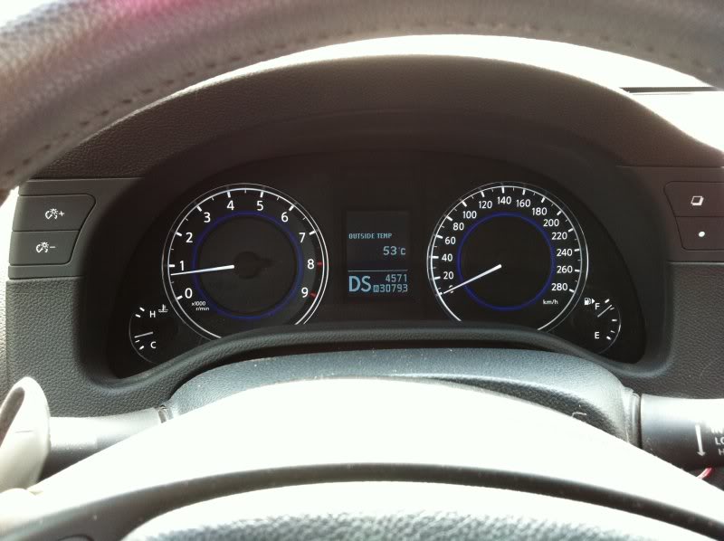

Was coming back from a meeting at 2:30pm, and noticed this:
If it's this hot in early June, August promises to be the hottest on record. Last year it hit 57C, so this year we may see even higher. So, my question is...should I look at getting an oil cooler? Deeper oil pan (to increase oil capacity)? Transmission cooler? All of the above? And if yes, who makes good ones that fit my car?

134 degrees F?? Your temp gauge is lower than mine, I dont think you have any problem.

Photo was taken as I got into the car...not after driving it for a while. My concern is that June is just the start of the summer here, and it's already 53C. August is MUCH hotter, and 90% of the driving is in stop/start city traffic.

Coolant temp gauges here are actually supposed to read about 1/4 not 1/2 like the US. They work differently.
