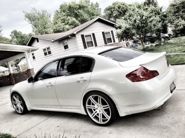

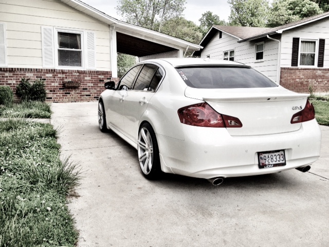

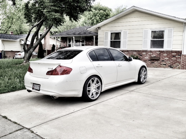

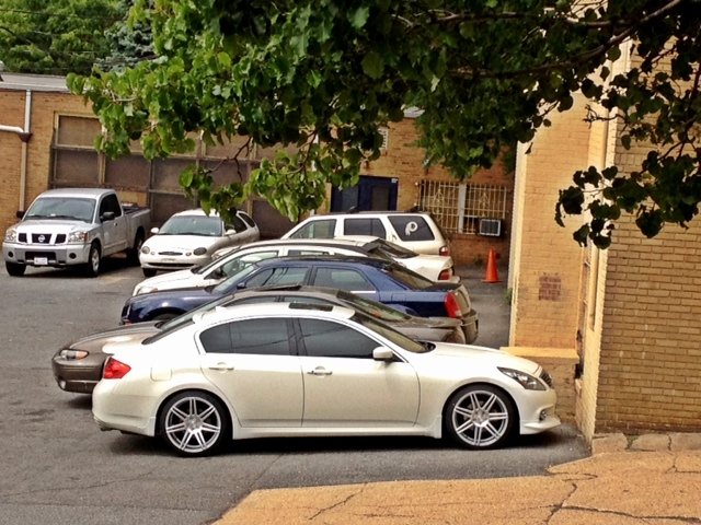

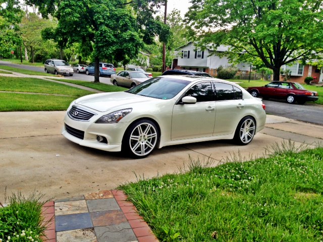

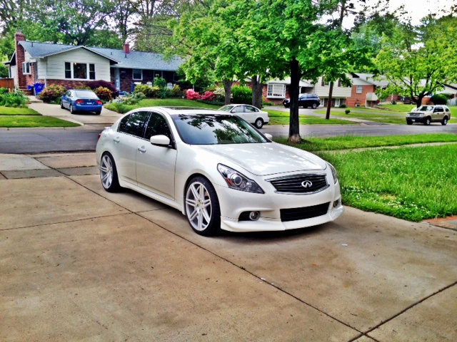

Just wanted to change the look a bit. On eibachs and Concept One
245/35-20 on 20x9 (+21)
285/30-20 0n 20x10.5 (+30)
Sorry first time posting pics. I'm not quite familiar on how to make the pics bigger.

Looks great! I just bought my 2009 xs....(and new to customizing, etc). How were you able to stagger the tires with awd?

As long as you keep the rolling diameter the same or close enough. I've been driving for 2 weeks and so far no problems.

Are you experiencing any tire rubbing in the rear?

There was a slight rub when I had kumho tires. Switched to falken coz it has a rounder edge. And so far no rubbing issue even 2 adults in the back seat.
