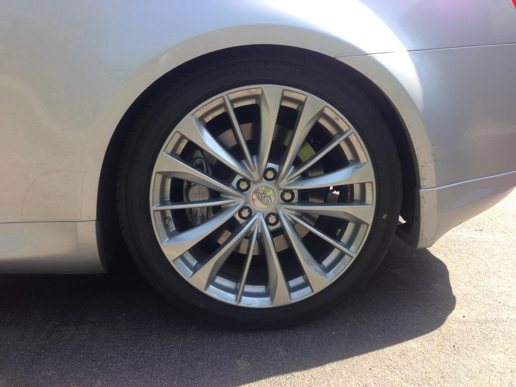

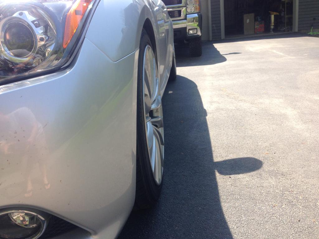

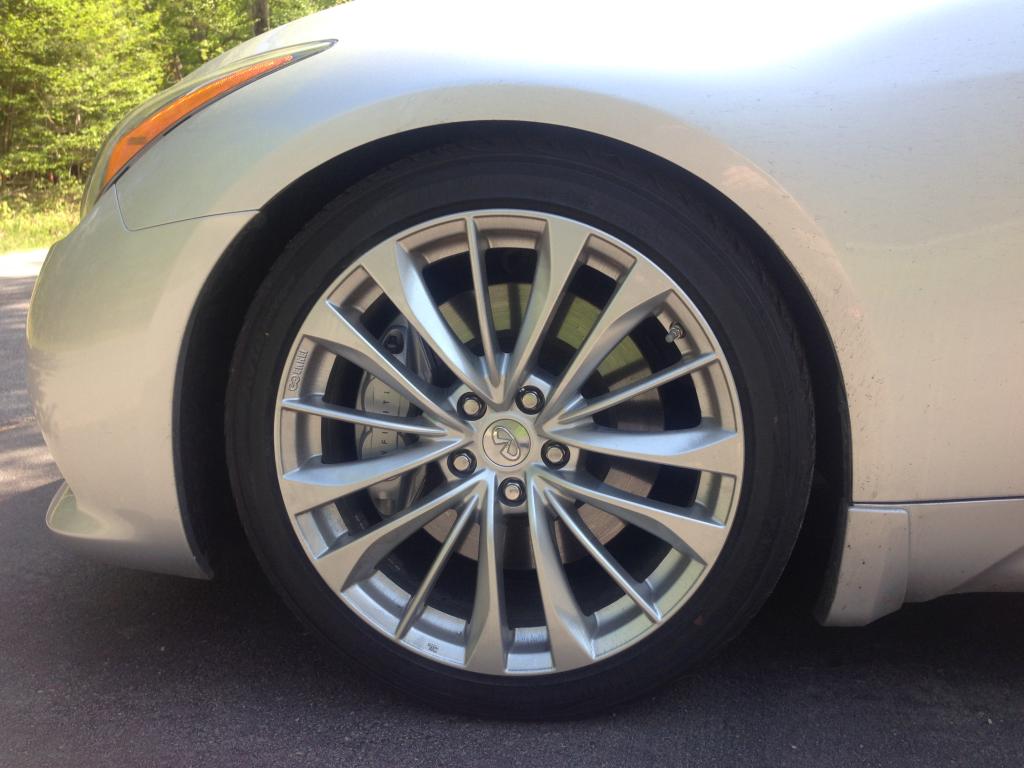

New Stance For The G
2011 XS Eibach Pro Kit and 20mm spacers

Very nice! Do you have any more pics? I'm looking to do the exact same thing.

looks awesome, any more pics, perhaps from the rear to see the wheel stance?

More firm. Not uncomfortable, but noticeable. Most times I'm not even thinking about the ride though, which leads me to believe it is not harsh.
Did you put in camber kits?
You will need a camber kit on the rear to get anywhere in the ballpark for specs. The front will be borderline, but it's likely you will need a front as well to get into factory specs. I went with both.
Did they settle in yet?
Good lowering springs don't really settle. This is a pretty common myth that floats around this forum. Cheap springs sag.
What's the wheel gap space now?
My car sits at an even 27" front and rear. This equals less than an inch of fender gap roughly.
Thanks!
Source: I have Eibach on my X as well. Hopefully this helps.

The 20mm spacers do so much.. I'd love to have the flush look, just kinda skeptical about spacers.
