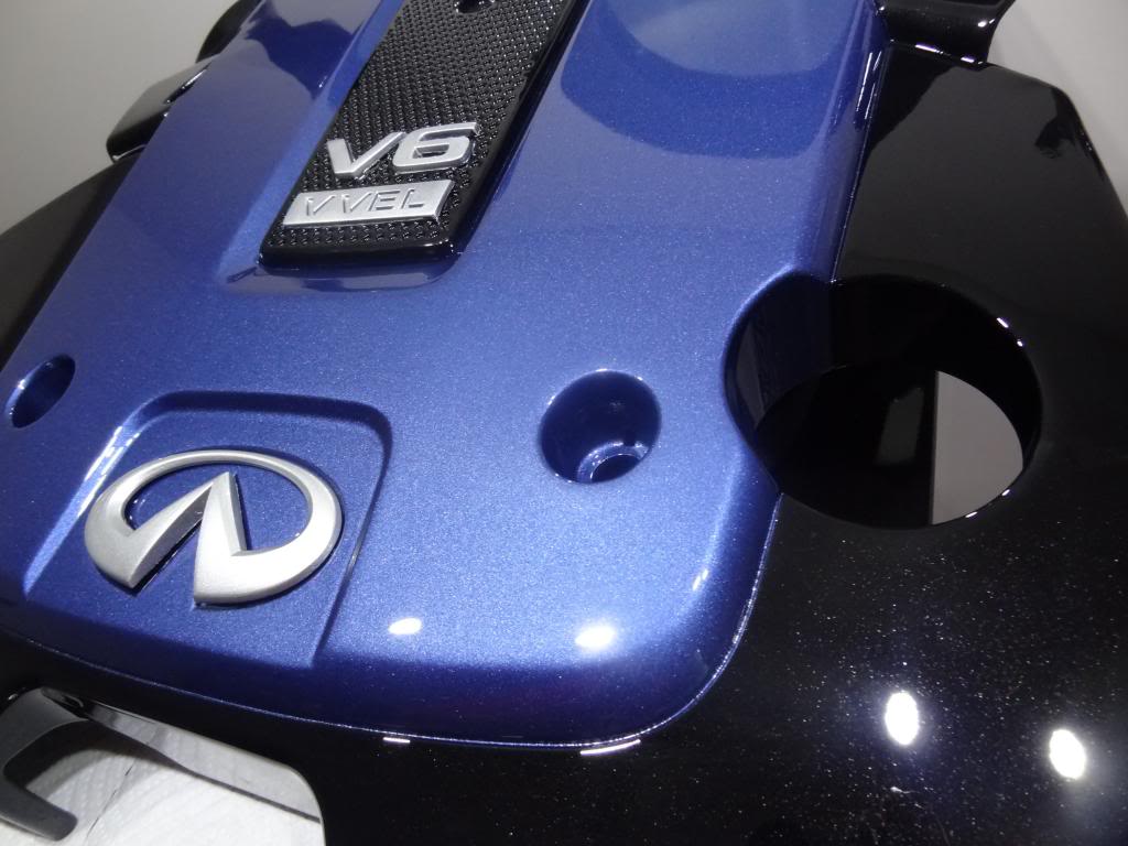

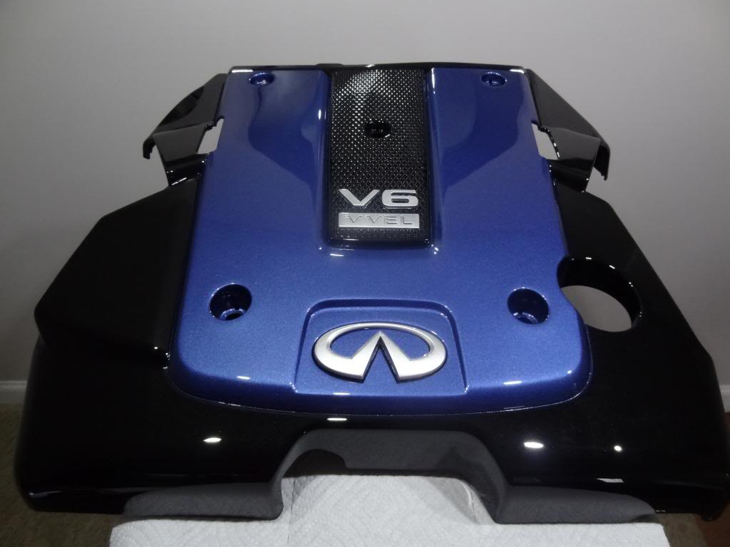

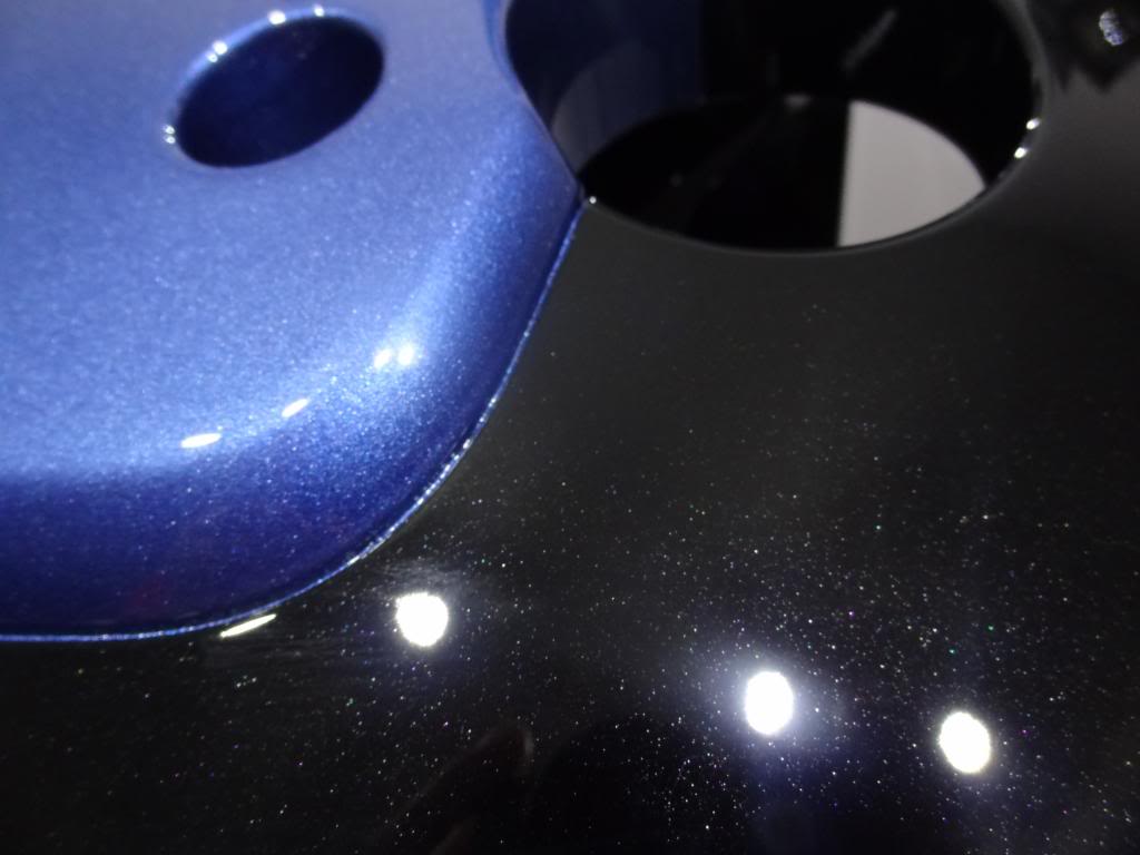

Lapis Blue and Black Pearl custom engine cover
All work done by myself using automotive grade basecoats and clearcoats and labor hours of love

Looks awesome saw this on your FB page. Did you sand this down before painting?

Yessir, sanded, painted black pearl on entire thing then clear coated, then after it dried, wetsanded clear smooth, masked off for blue, painted blue, then recleared the entire thing

Joe6mtt, unfortunately none of the materials used on this can be bought at a local autozone, the paints and clears used on this are the same materials used on vehicle exteriors, this is not aerosol spray cans, and is not cheap either, however the end result finish is glassy smooth and resembles metal, and not the rough, texturey plastic cover it actually is
