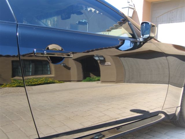

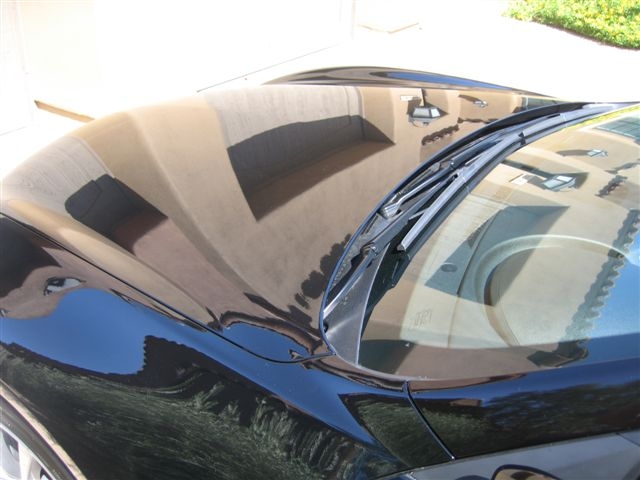

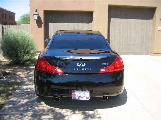

Black G37s- just zaino'd
My first experience with detailing.:

Looks great Goofy. Congrats on the detailing job!

Looks awesome bro, great job!

Sweet!!! Lookin' good.

Gotta love a black car after a good detail job. Very nice!!!

damm that crazy clean

Thats Klean...

Looks great, how long did it take?
Thinking about pickin up a kit, its kind of rainy season up here though

Nice job. Which bottles did you use? And in which order? So I can follow it when I detail it sometime this weekend

Very nice, there's nothing like Zaino!

It took 6 hours.

thanks,
First I made sure the dealer did not touch my car. I gave it a good wash/dry/spot clay/ rewashed that day.
on Sunday, I got up washed the car again, clayed the whole thing, washed it off, dried it. I used Z5/Z6 (my z8 didn't come due to mix up)/Z5/Z6/Z2/Z6/Z2/Z6. The Z5 and 2 with EFX.
for those who don't know- this was easier than you'd think (believe me, If I can do it, any one can!!!) The Z2 &5 get applied then dry (quickly in the Arizona sun) then wiped off. the Z6 is just a quick spray and wipe.

By hand or PC?

nice job! how do you keep your G37 swirl free? whats your techniques?
