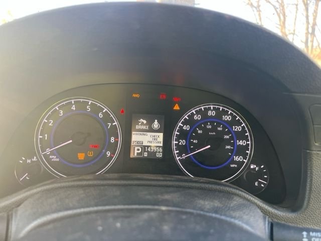

No codes are coming up. I have had a code reader on it this entire time. Would it still try to crank even if it was an anti theft issue?
Old Dec 12, 2023 | 02:46 PM
beefychicken's Avatar
beefychicken
Joined: Nov 2017
Posts: 359
Likes: 102
From: SoMD
Does this warning light come on?
Old Dec 12, 2023 | 03:09 PM
camopaint0707's Avatar
camopaint0707
Joined: Dec 2023
Posts: 83
It does not.
