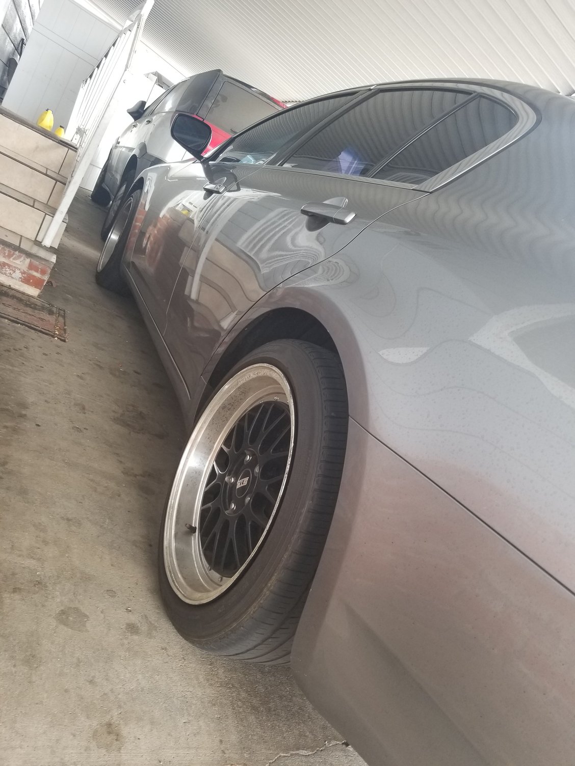

its rwd. Ill attach a photo to give better idea
edit ; photo attached
Side view
Back view
