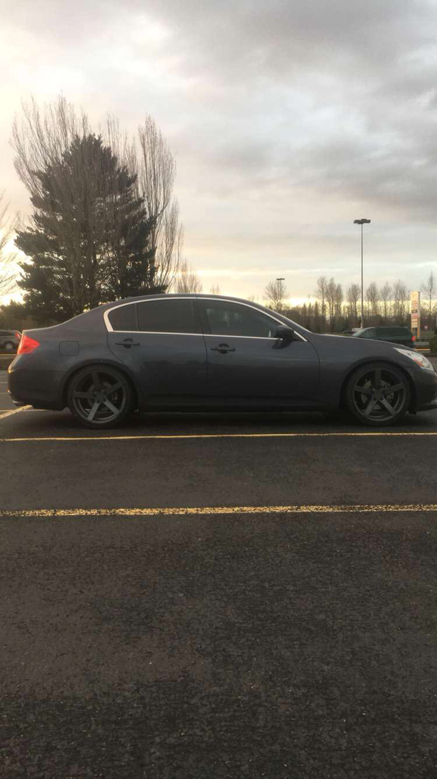

Here's a photo of my new wheels. Running 285's on the back looks so sick!! Thanks for all your help

Glad it worked out, but more pics are needed now
