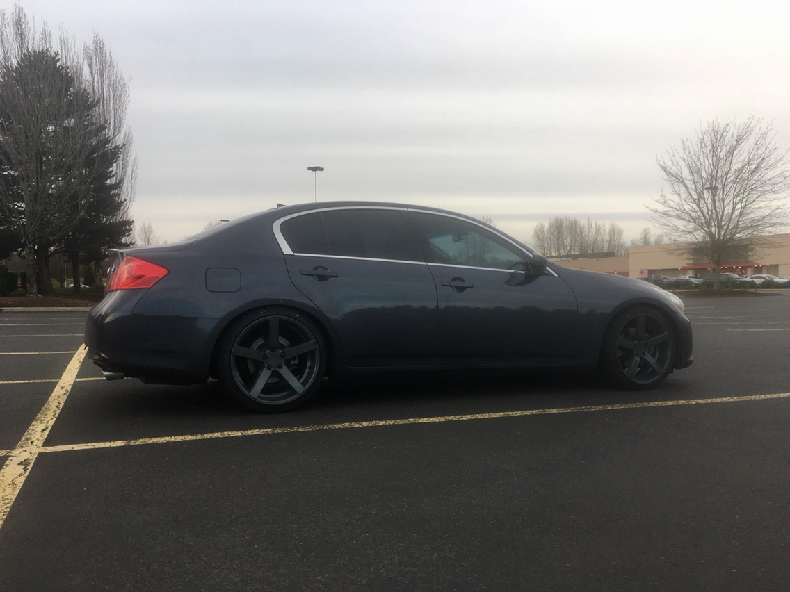

Here's a closer look at the 285's on a 20x10 +40 Max Tire Size for 20x8.5 +20 20x10 +25 Wheels-photo375.jpg

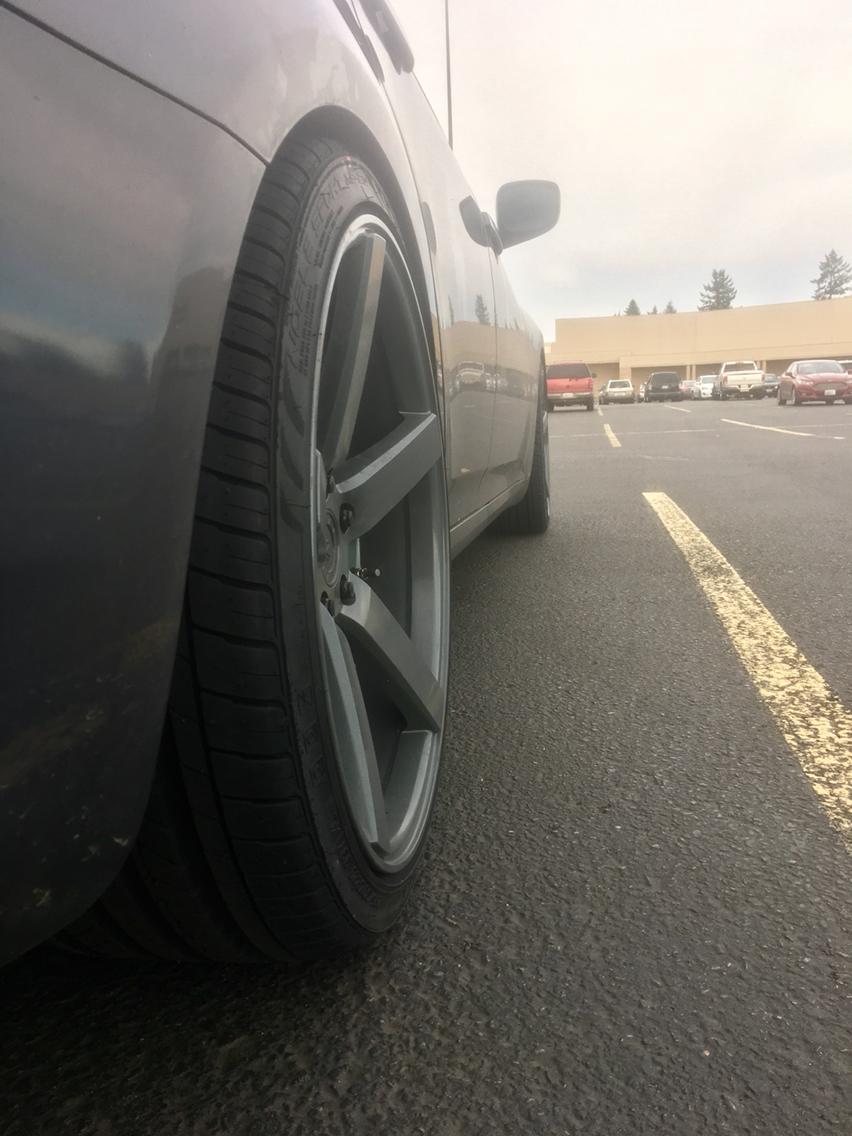

Another side shot

Is your fender cutting into the tire or just the way the tire is?
That's definitely a close fit though. Balsy.

That's the same fit (from the tire edge to the fender lip)I had w/ my 295s on my 10+45s, it's close but they do tuck with about 3mm to spare His wheels are 5mm further out than mine though.

At first it was running on the "cardboard" rock guard thing inside the rear fender but I think the tire wore it down. Haven't had any issues since. but again I haven't had a load of people or a full trunk yet. From the looks on the outside it seems like there's enough clearance but it's definitely really close. I recommend this staggered wheel/tire size for the sedans, looks sick. Have no rubbing at all up front with the low offset and still looks flush with the fender.
Hope these wheels hold up okay, I know they aren't the highest of quality. I snagged them off Craigslist for $500 with a fresh powder coat.
