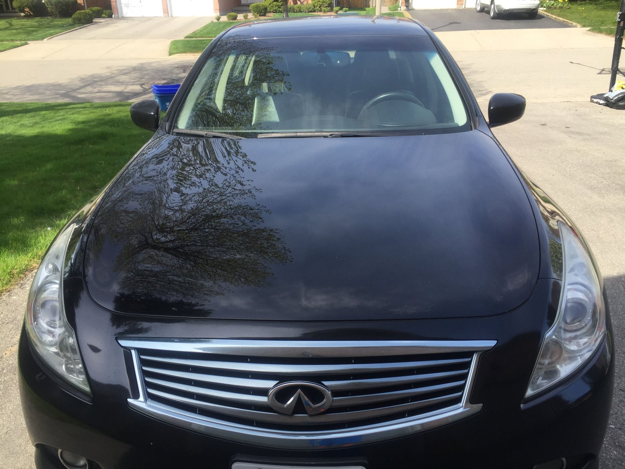

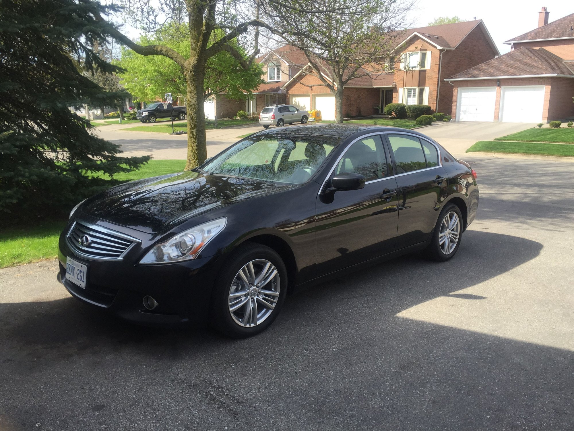

Hello! Just picked up my first car a couple of weeks ago, its a 2012 G37x Sedan.

Welcome to the forum and congrats on that really nice looking sedan! I'd definitely say swift springs or even the Eibach springs are not at all to much for a daily driver drop. Keep us posted and best of luck with the future modding.
