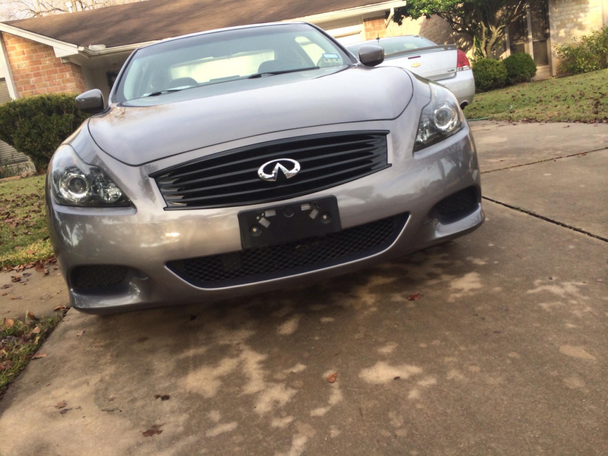

Hey guys,
This is my first post besides my introduction post . I recently painted the inside of my headlights a semigloss black.this was my first time ever doing anything to a car, as I just recently started getting into cars . So I wanted to show it off.
On another note , I'm experiencing bad break judder . It started off small but has gotten worse and especially worse yesterday when I had to slam on my breaks to avoid a accident on the freeway .(if you live in you houston around 288 and 610 you know how crazy they drive ) . I was looking into Adams Rotors and the stop tech brakes they recommend with there rotors.
Does anybody have any input on this company ? I have seen many reviews but I always seem to think most reviews are fake and would like feedback from somebody that has had experience with them.
I'm open to other suggestions , but Money is aa factor .' Something around $800 rotors and pads I was thinking ?
It's a real bummer to because now I'm going to have to wait a little longer for the springs I planned on getting .thanks any feedback is appreciated

Welcome to the site, congrats on your G and your first mod! Lights look nice and not the easiest mod to start with

Looks great, nice job. Especially as a first attempt.
Welcome to the forum!

Thanks! The lights didn't fit in my oven like I expected they would . There where some points were I got frustrated and just wanted to rip them apart when it looked like it was almost off. It was freezing that night to and I was working in the garage so the glue wasn't wanting to come off .

Headlights look good! First step down a long road!
