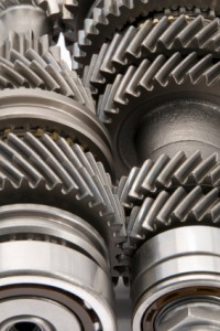

Originally Posted by MSCA
You need to do some research. You're 100% wrong. Our gearboxes are constant mesh, as are just about every MODERN gearbox on every manual trans car. The job of the synchro is to match up SHAFT speeds, not gears. Yes, the gears are attached to the shafts, but they are alread in constant mesh. Don't take my word for it, look it up yourself if you don't believe me.
I've rebuilt countless T5 transmissions (used extensively on 5.0L Mustangs, as well as other vehicles) and trust me when I say the gears are in constant mesh. If you need me to post pictures, I will.
I'm interested in learning about this. If they are always in mesh, but they are rotating at different speeds, wouldn't they have to be out of mesh somewhere along the way. What is the definition of mesh? To me it means aligned with each other, like being in phase. Does anyone have a good link for this?
Back on topic: I think the original topic was concerning the interesting behavior of an Automatic transmission and engine rpms? Was it AT or MT Mr. OP?
This might help you visualize it. Notice that all the gears are constantly in mesh.
YouTube - How Manual Transmission Works

Here's a nice picture of a modern constant-mesh manual transmission. If you can visualize it, all the gear sets are meshed and never separate. You can clearly see the groove where the shift fork sit on the synchronizer collar. This is what moves back and forth when you moved the shift lever and the dog clutches help spin up to match shaft speeds.
