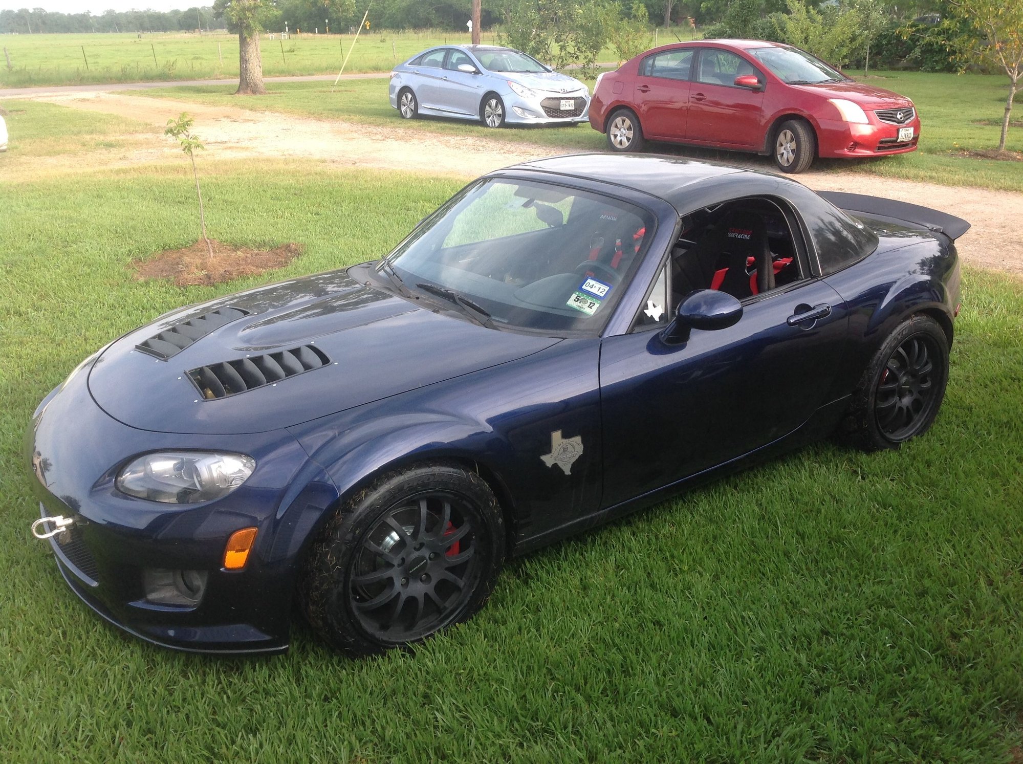

If I really want to get serious, I'll probably invest in a track car, likely a miata.
Like I did.
Only 41k miles.
