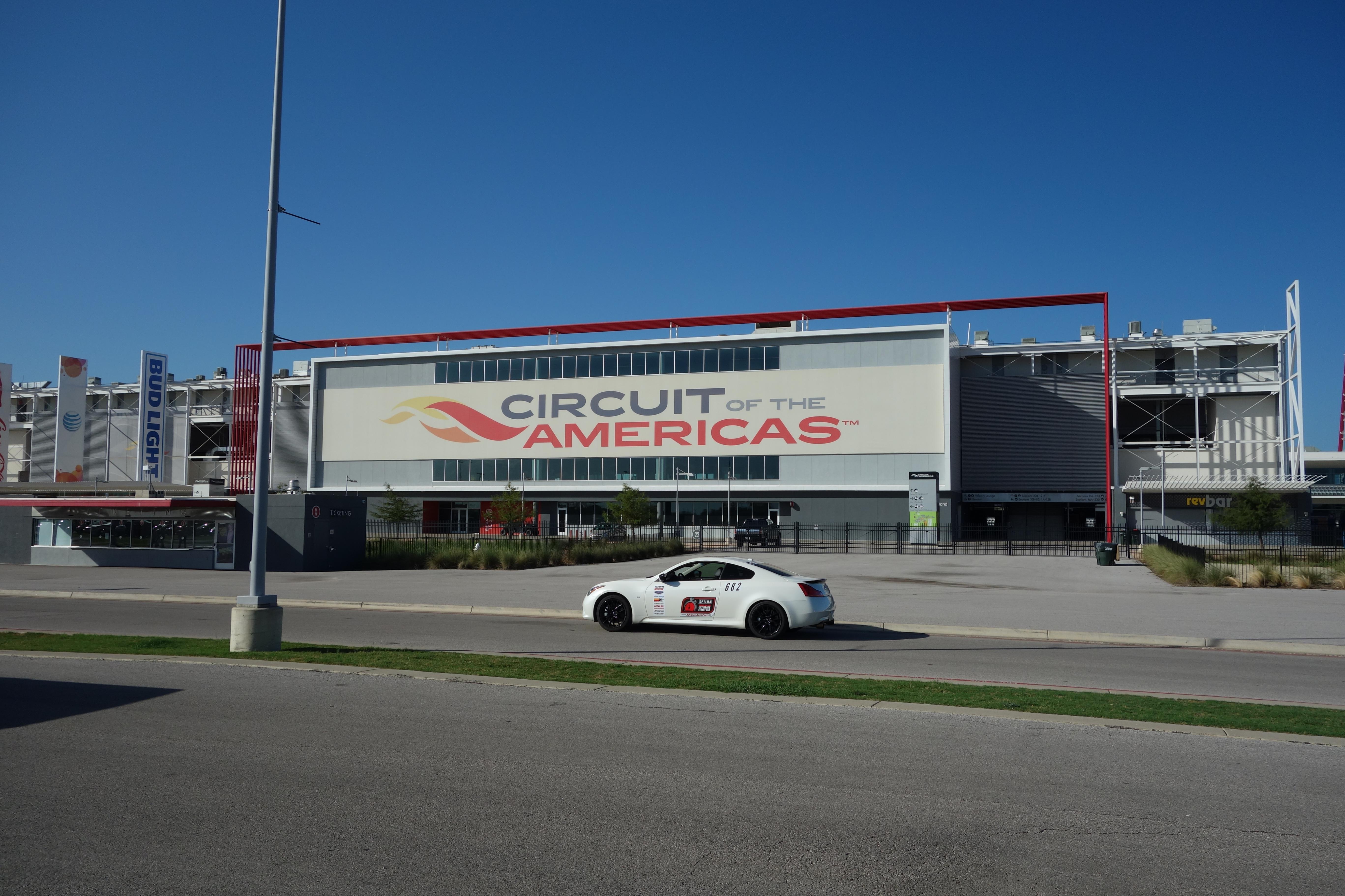

So, I didn't want to take over the other thread and instead figured I'd share my adventures from here.
I've been working to this point for a few months, upgrading and doing shakedown runs in the car. I've had 2 track days so far and a bunch of autocross events but still not enough time in the car in its current state (sway bar and tyres) to really get to know its limits on a track I know the limits of so I go in to the weekend a little blind but super excited to race on this great track.
The drive went well, sailed through tech without any hiccups and got issued a set of race livery to apply to the car, she's looking real nice now!
Car:
2015 Q60s Limited
- Hotchkis front sway bar
- SPL upper front control arms
- Z1 34 row oil cooler
- Z1 power steering cooler
- Z1 2 piece slotted rotors front and rear
- Carbotech XP10/8 front/rear brake pads
- Bridgestone RE71R tyres in 245/40 up front and 265/35 in back on stock rims
The upgrades address the biggest problems with the stock car and leave the springs and dampers alone to ensure daily driver comfort as I do 60 miles per day in the interstate (but that HUMONGOUS front wheel gap is getting real irritating)
I will Take photos, videos and telemetry during the event and keep this thread updated.

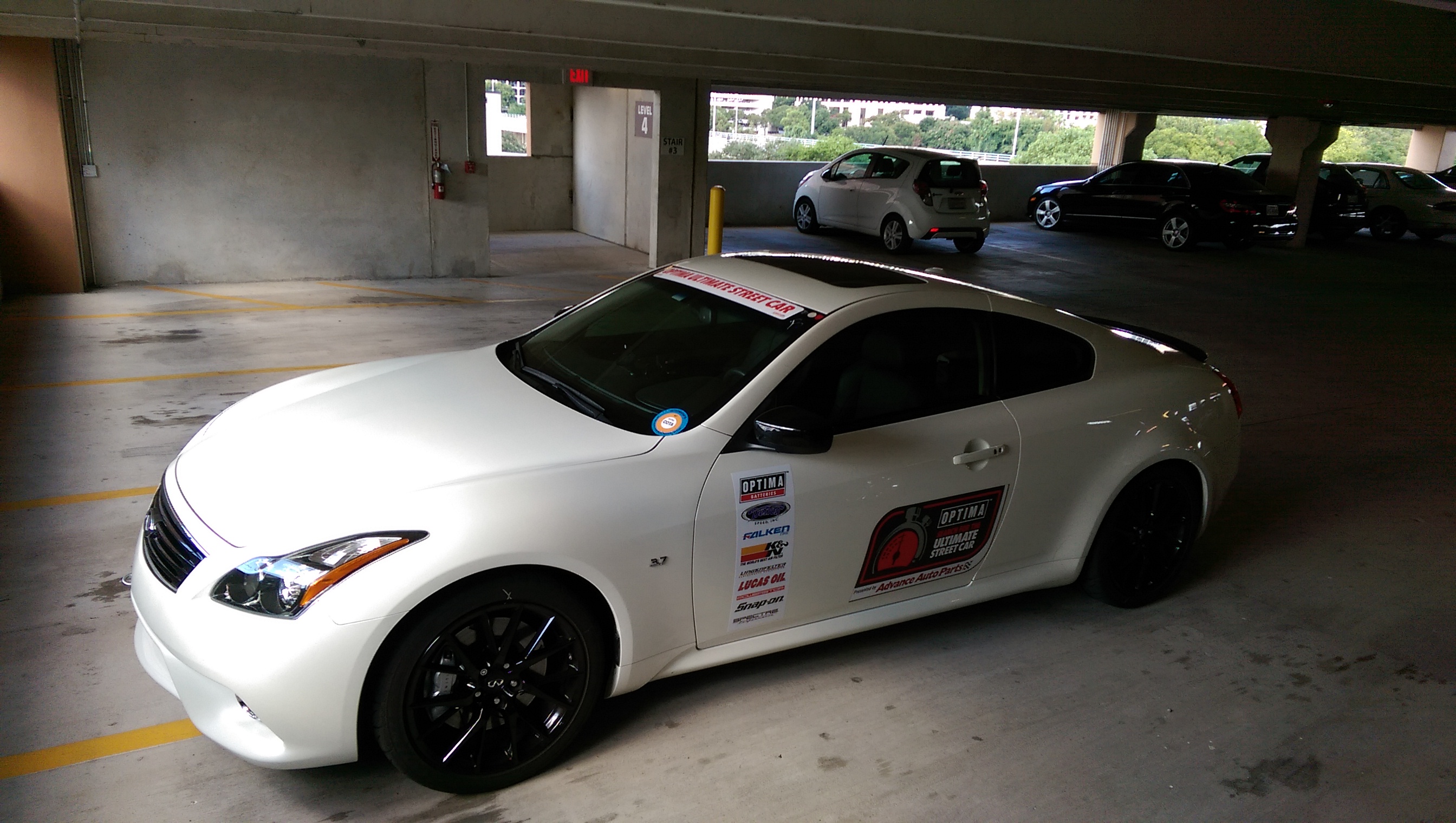

So, COTA, here it is:
Absolutely amazing track and I will be coming back here again. Given it was my first flat out event I was very careful learning the car and track. My first session best was a 3.11 and my third session a 2.50! Not to mention the excessive track clean-up fee's. A corvette left a diff on the track to the tune of $1,500 in cleanup and an EVO tore it's block literally in 2 and copped an even bigger bill for his trouble.
With all that in mind, I tried to keep it really tidy and clean fun, I've watched 370z videos that have lapped in the 2.3X range on the stock tyres, so there is easily 10s left on the table. At no point was I really pushing the limits of the tyres (new) and setup (also changed since last event) but my gosh did I have fun! And I didn't come last in a field entirely of V8's
I would also highly recommend the Ultimate Street Car Challenge of itself. It's 99% muscle cars, but a really relaxed and friendly atmosphere with limited cars per run with lots of track time. There were 11 cars in my group, and by this lap, the last session of the day, only 6 had elected to continue running laps so that mustang was the only car I saw in 15 minutes. He was also my only overtake of the weekend....
Lots of track time and the mixture of events is a nice way to break up a 2-day weekend.
The brakes worked very well for me, no problems at all. My third run I did 4 full-pace laps, a slow lap and another at speed to make 6 and a full 20+ minute session, and whilst the pedal got very long and the pads lost all their initial bite (cold carbotech's will put your face through the windshield with any more than 2/3 an ounce of pressure on the pedal normally), they still worked and continued to pull the car up at 1G according to my logger. I will still investigate getting the brake ducts installed as I did already buy the stuff, so why not to be safe. Unlike some other forum members here, the calipers have not changed colour, so they must be working better than single piece rotors.
The power steering fluid still boiled as well on that run, there was some very minor seeping through the cap and when I took the cap off, a few bubbles. I reduced the fluid level from 'Hot Max' to 'Hot Min' and observed no more leaking for the day. It was just a hot day, 104 degrees blazing sunlight during that session.
The final run of the day (this one on video) I had forgotten to top up on fuel after my last run - I didn't think that 2-3 gallons would make a difference - but you can hear on the last 2 corners and the front straight that the car wouldn't rev. Hit fuel starve by lap 8, only ~5 gallons from empty, so I guess I got bit as I knew I should have filled up.
