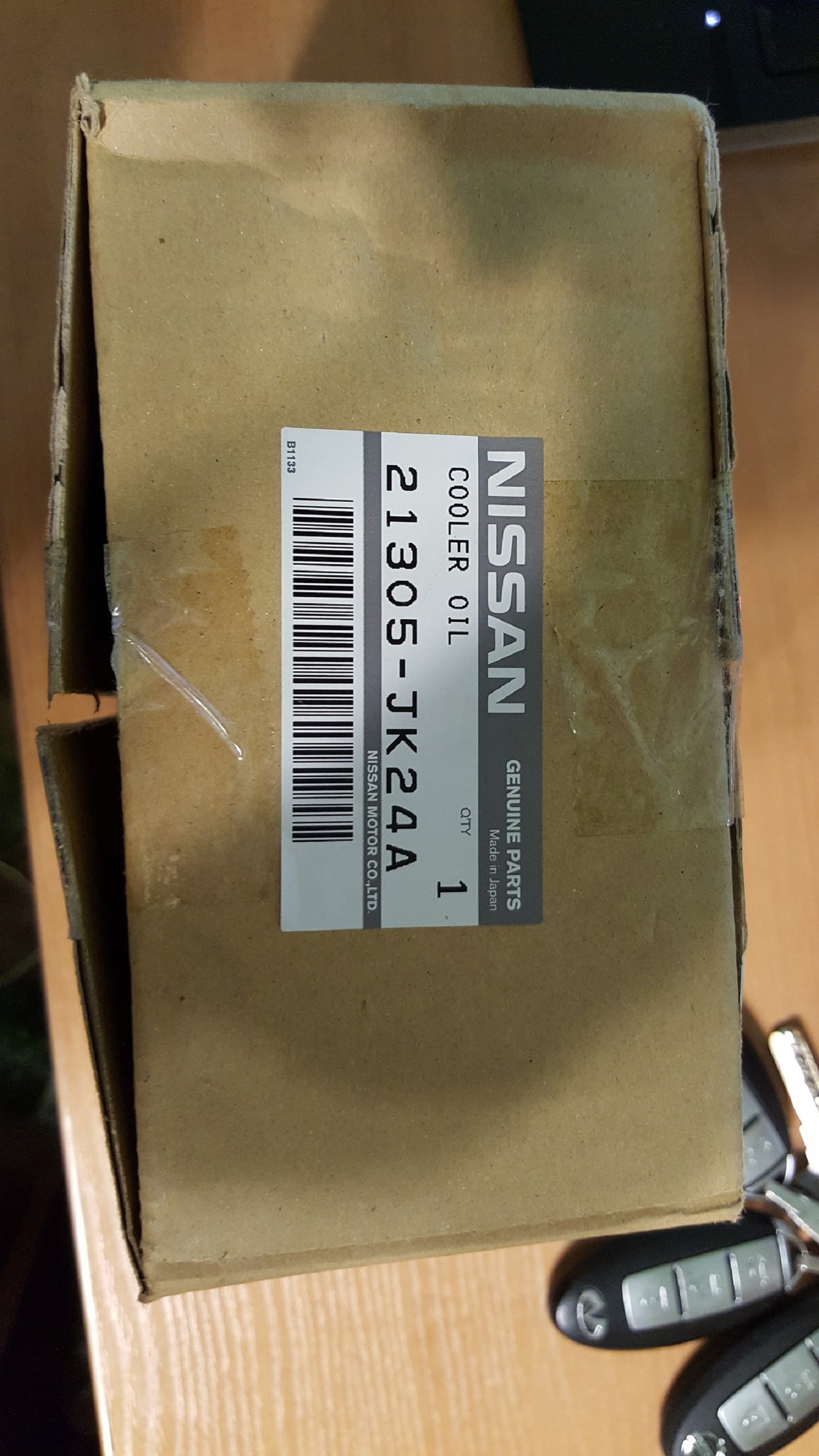

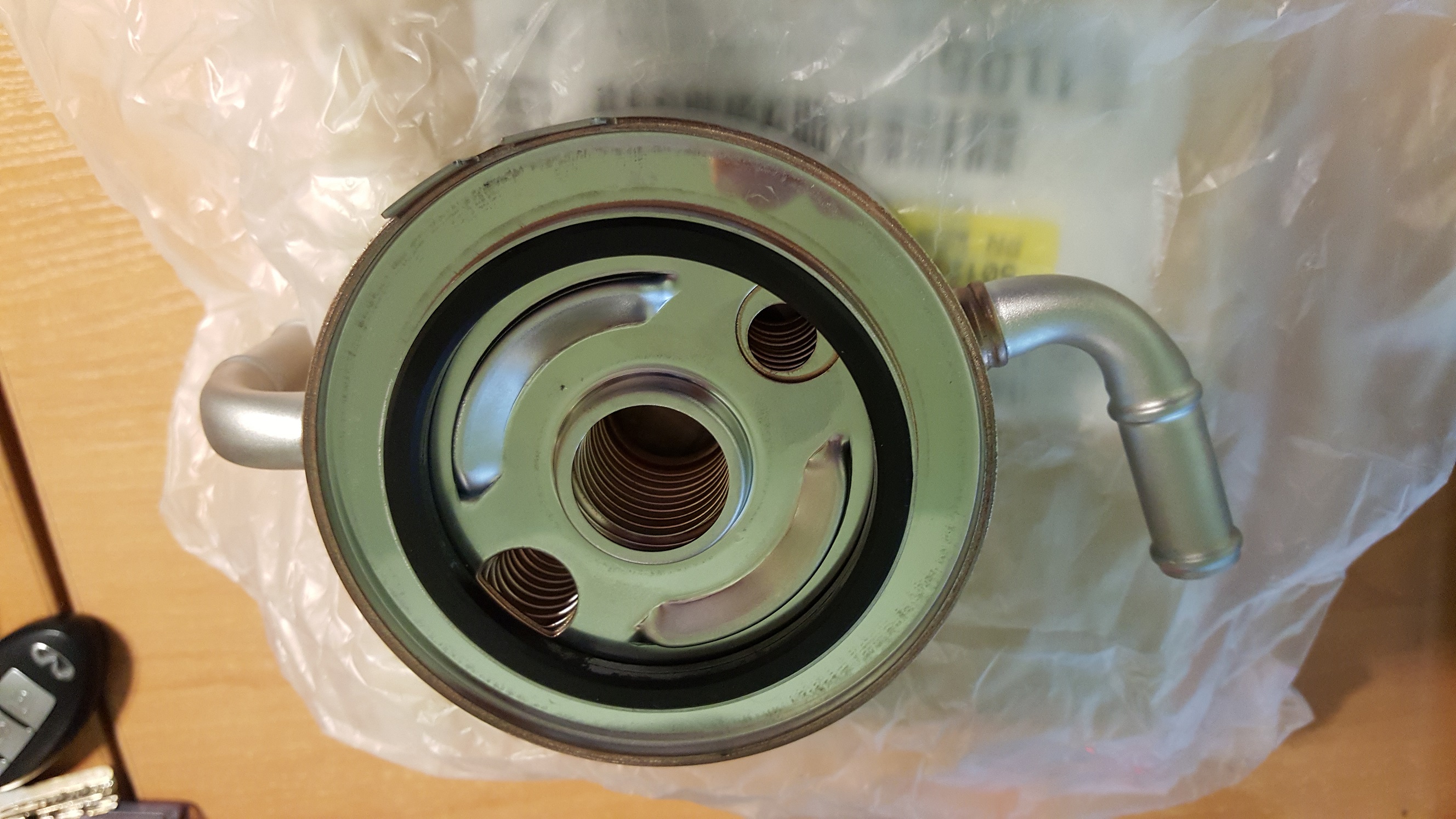

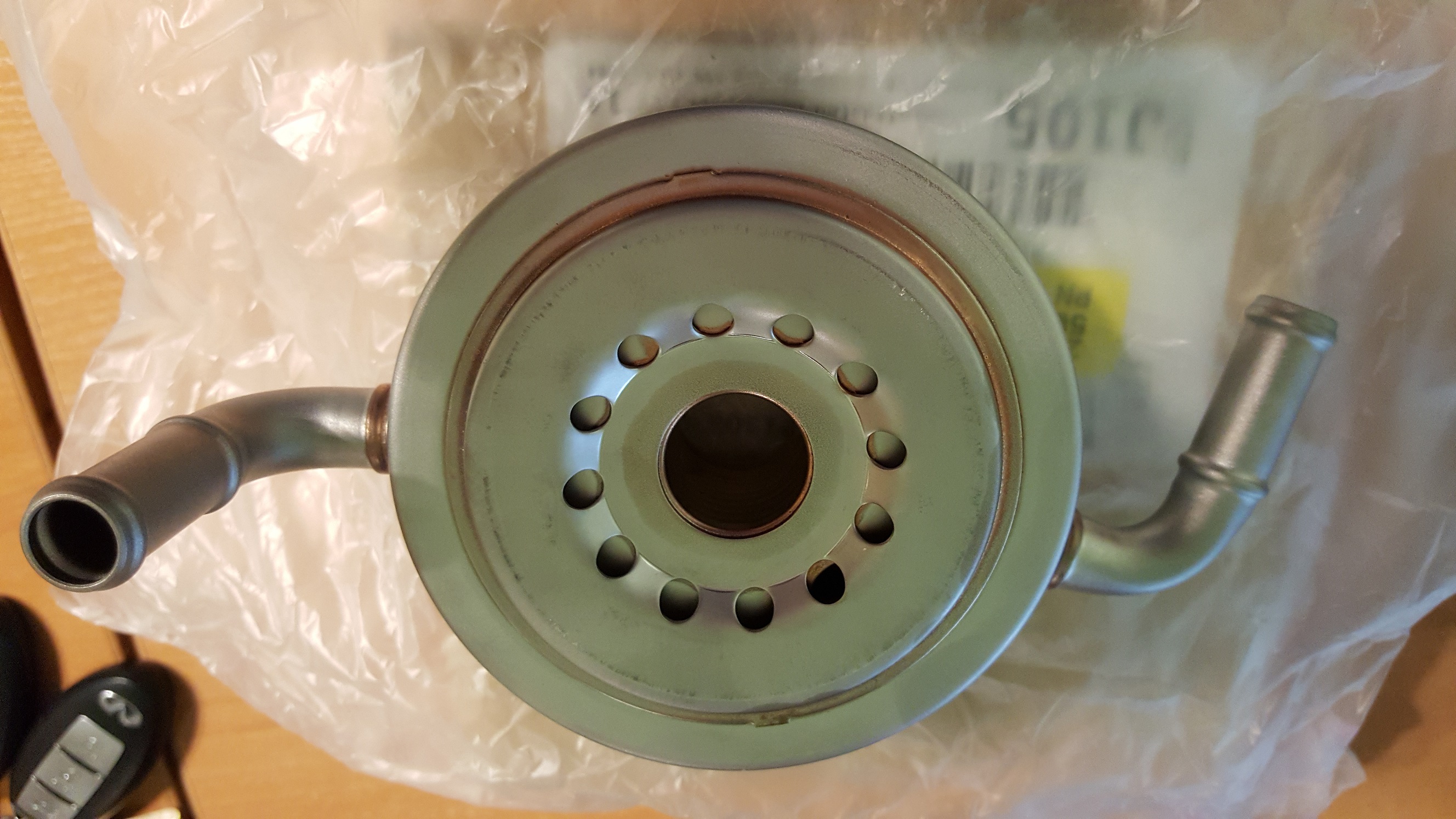

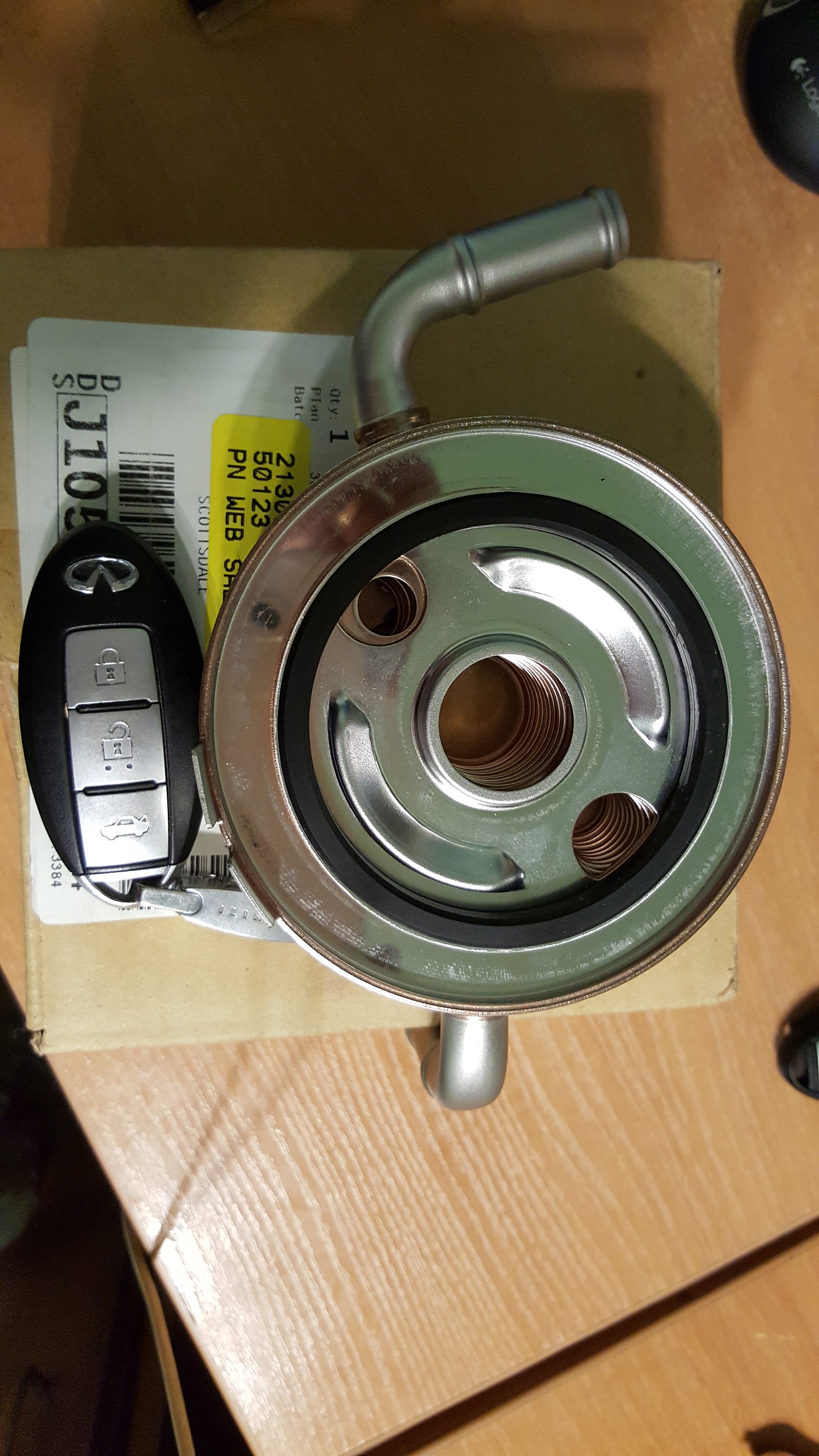

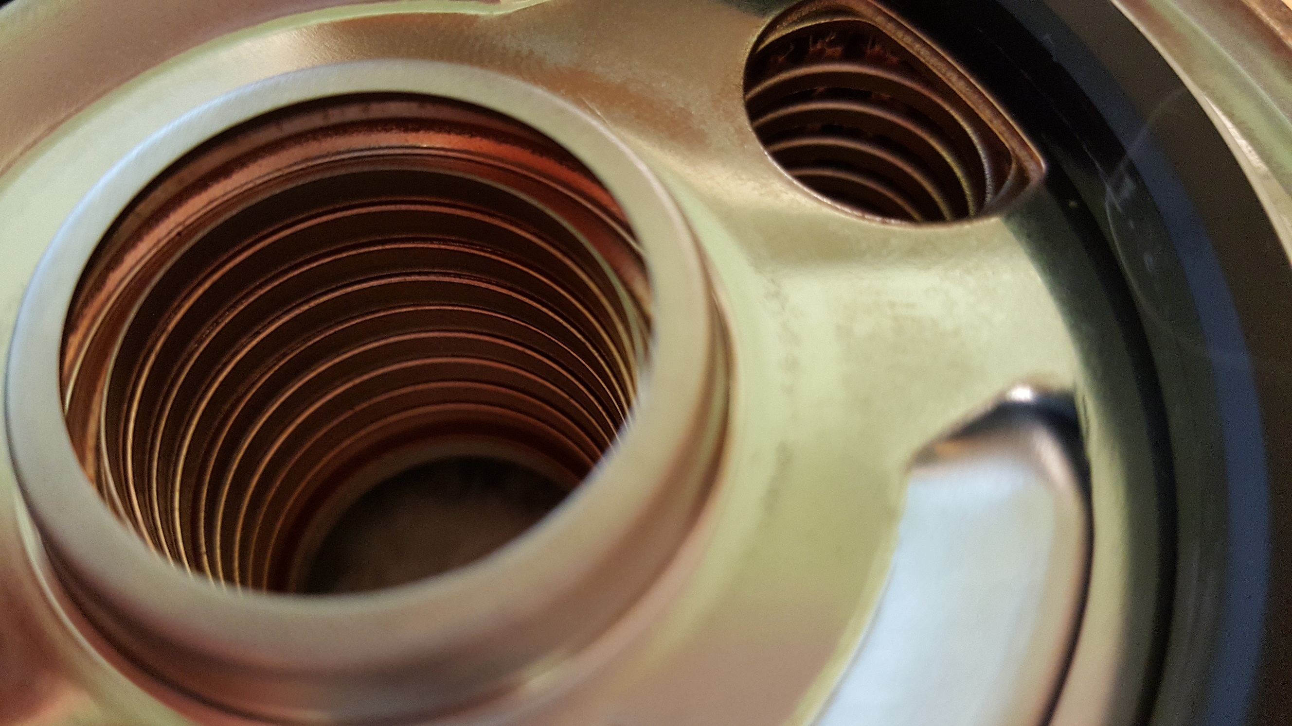

Yes. I have the part numbers. See the attached photos.
The oil cooler use engine coolant to cool the oil. It don't have a separate radiator like the aftermarket oil cooler kits. But it does the job perfectly.
It happen to have a spare oil cooler for vert, because at some point, a "smart" mechanic cracked the original cooler when he over tighten the oil filter. The dealer asked an insane price for it, so i went online to find it cheaper
I found it in UAE for about 300 USD.
So i got 2 of them "just in case"
The G37x use a different oil cooler that have the pipes in a different orientation.
