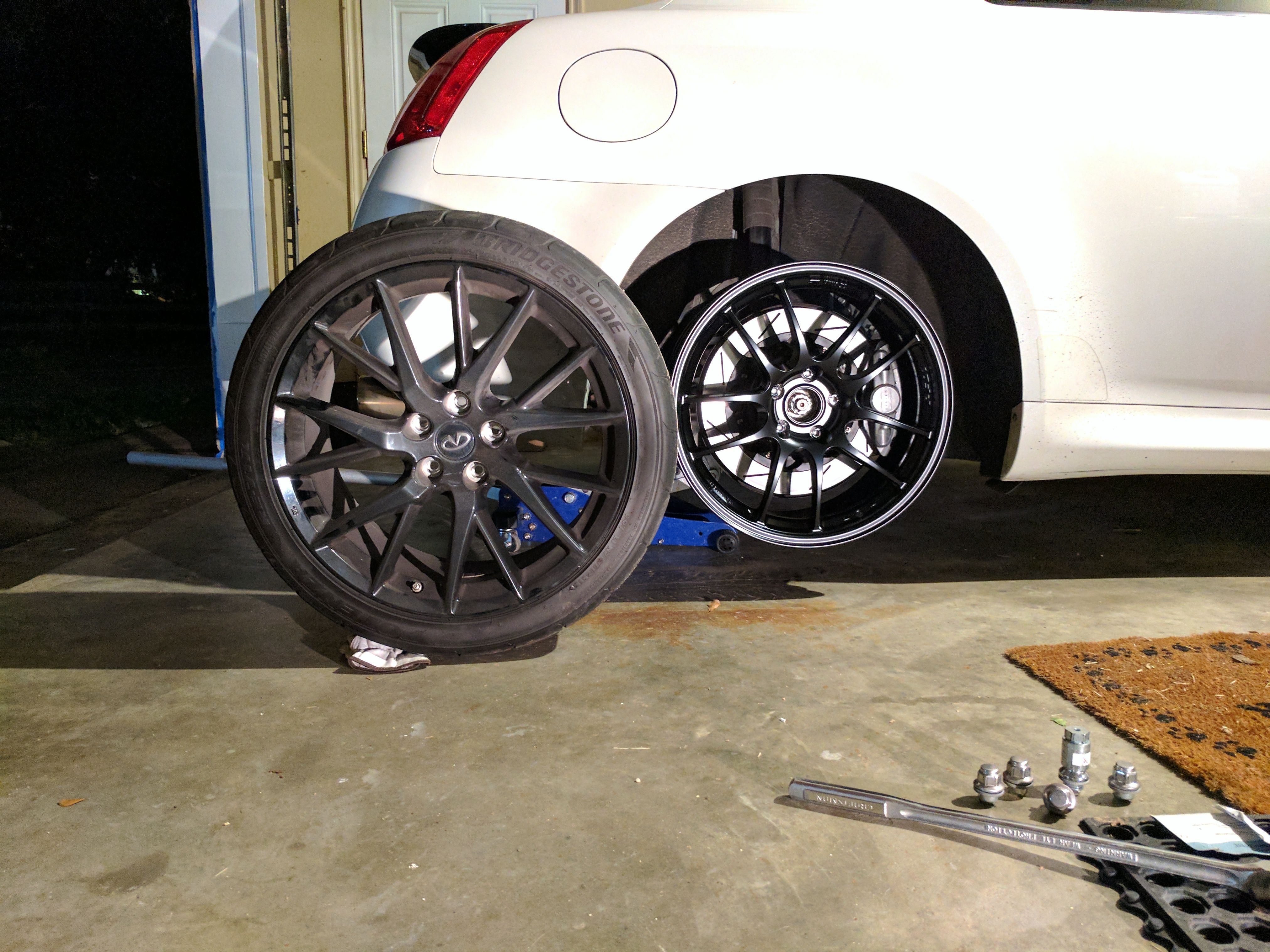

Old Dec 13, 2016 | 08:33 AM
  #180
Splitter's Avatar
Splitter
Joined: Jan 2016
Posts: 250
Likes: 24
From: Houston, TX
Well well well, what have we here....
I resisted for the longest time to buy a set of race wheels, but the Bridgestone tyres are SO NOISY now that they're worn that I didn't really have a choice. Unfortunately, 3 of the wheels arrived with significant damage, so I'm waiting to hear back from the vendor about getting them replaced.
Christmas shopping is done, I have quite the list to install over the break:
- Z1 finned diff cover
- Z1 urethane diff mounts
- Stillen Brake cooling ducts
- Mount new tyres
- Flip current tyres
- Wheel alignment to fix the crooked steering wheel
The car developed a clicking noise from the rear hubs a couple weeks ago which a quick google showed up as an Infiniti TSB, so I cheaped out and had the dealership do the oil change with new redline oil, filter and magnetic drain plug while it was being worked on. When I picked it up, the service technician and 2 of the sales associate and I had quite a good conversation about the car, they loved how it was modified. I stopped short of showing them the video, but they were excited to hear about plans for COTA and Road Atlanta next year.
I've also decided that I'm going to run standard pads 99% of the time and for autocross, just swapping in the race pads for the track. The car has gotten to a point where my wife doesn't like driving in it, and to be honest neither do I, hence some of the recent 'bolt-on' track part decisions to keep it a nice daily. I also had my first pucker moment at the last autocross event with Ice mode. It was a cold day and the car was AWFUL to drive. It felt like the brake pedal was operating in a 2-phase mode. You would go for the brakes, the pedal would go hard with almost no slowing down and a good half second later the pedal would relax and you'd actually get some brakes back. I have 2 embarrassing moments where I couldn't slow at all and straight lined in to the infield. These pads are great on track, but just not ideal for street driving, nor low temp autocross.
I look forward to giving all the new parts a solid work out in the new year, I probably should have bought these 8 months ago really when it was actually hot, but whatever, I'll be prepared for when the heat comes back at least.
