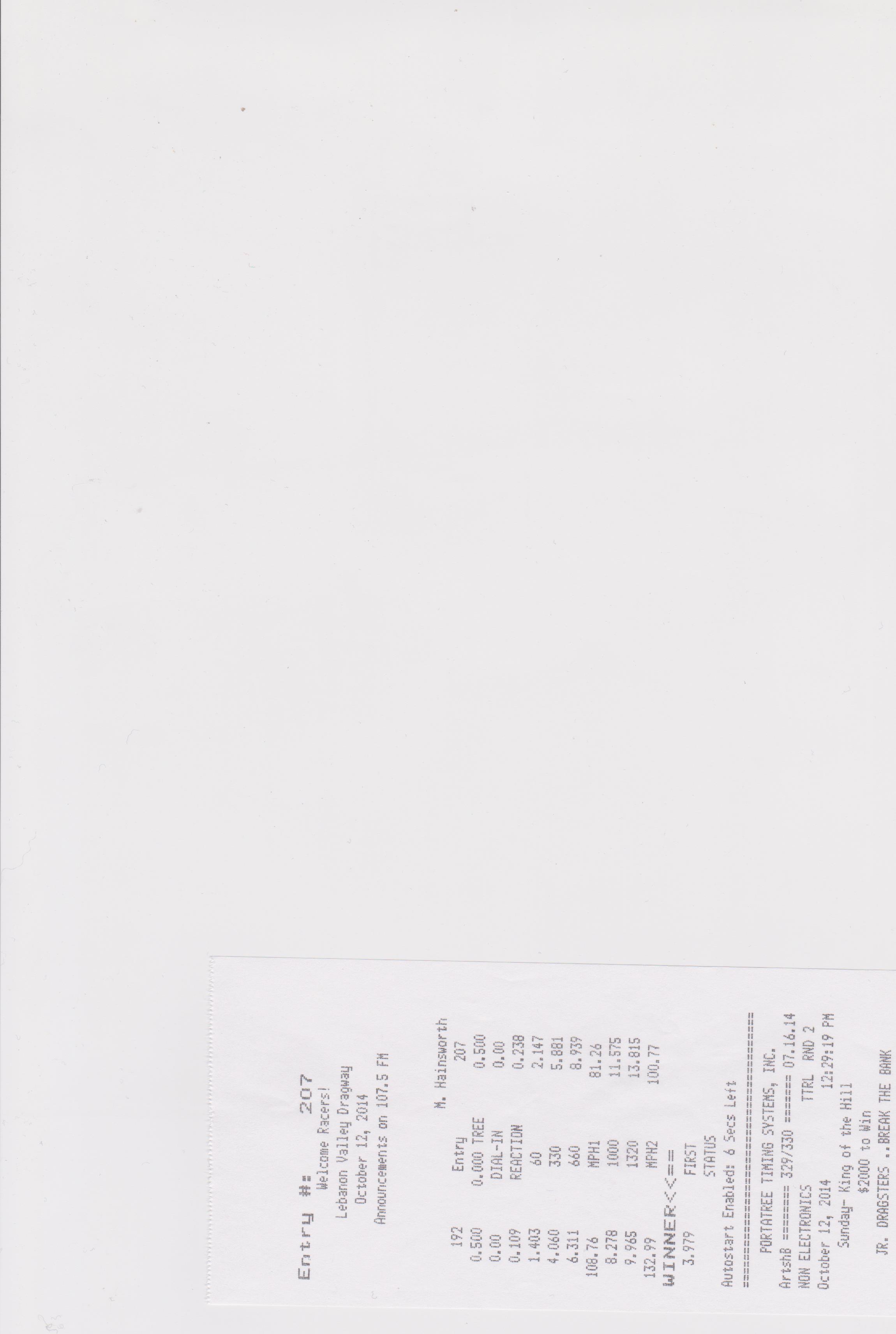

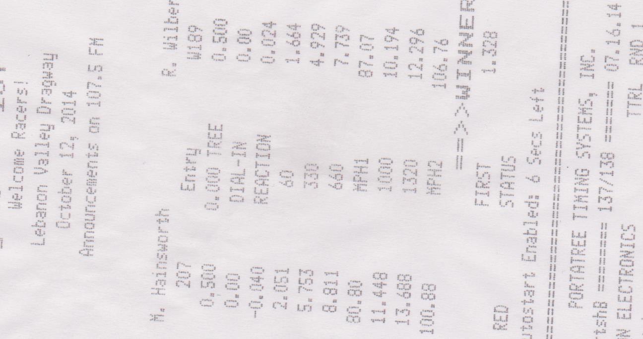

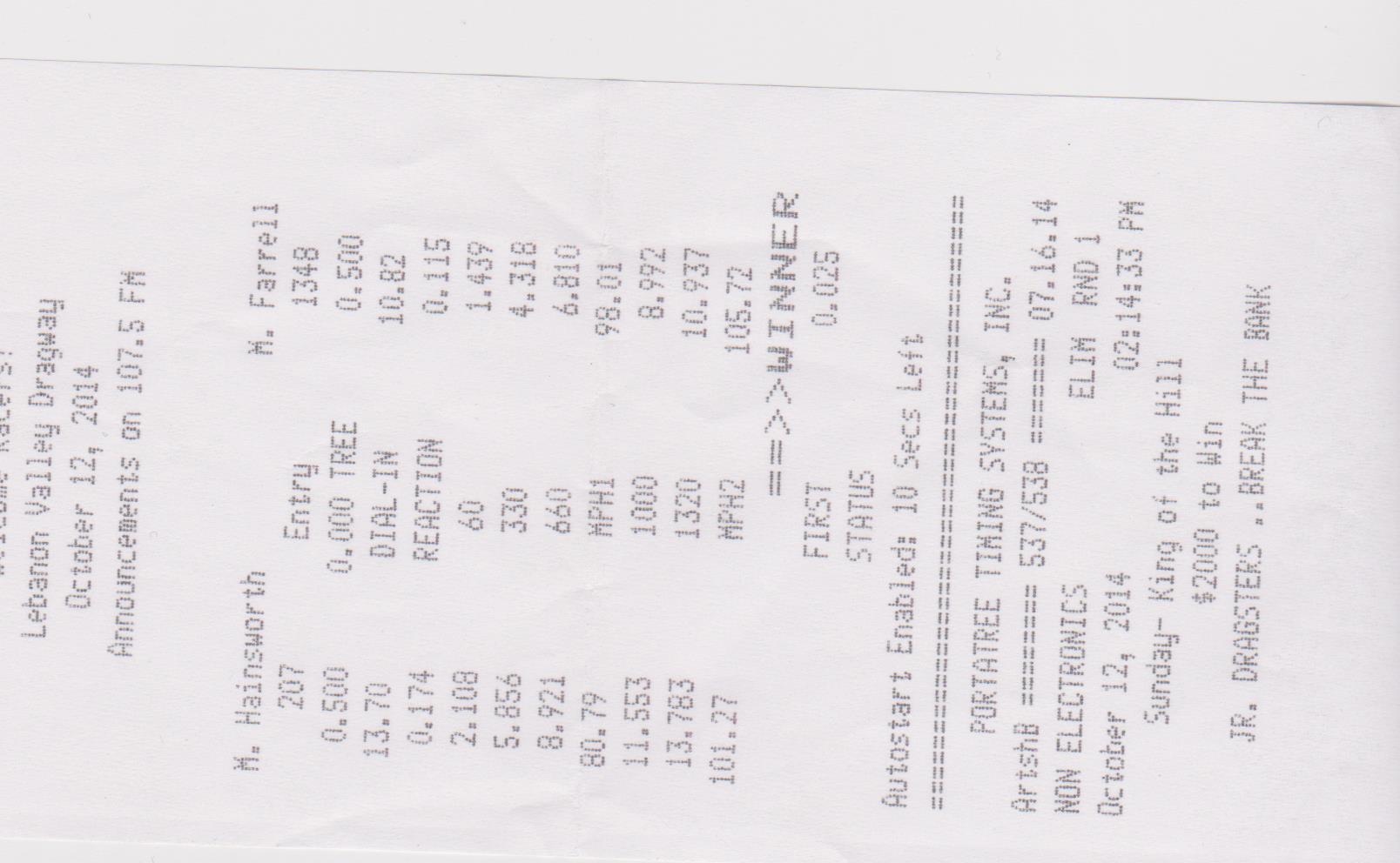

Car is a 2009 G37XS Sedan completely stock. Went to Lebanon Valley Dragway today in Upstate NY. Entered a King of the Hill race. Got eliminated 1st round but the G was pretty consistent I can't complain about the car. Racing all guys that race almost every week and have big slicks. Pretty happy but just wish I had more time trials and tried more RPM on launch. Seems like I should be getting out of the hole stronger it's not spinning at all. Posted slips below got a 13.688 best @ 100.88 cracked 101 on another run.

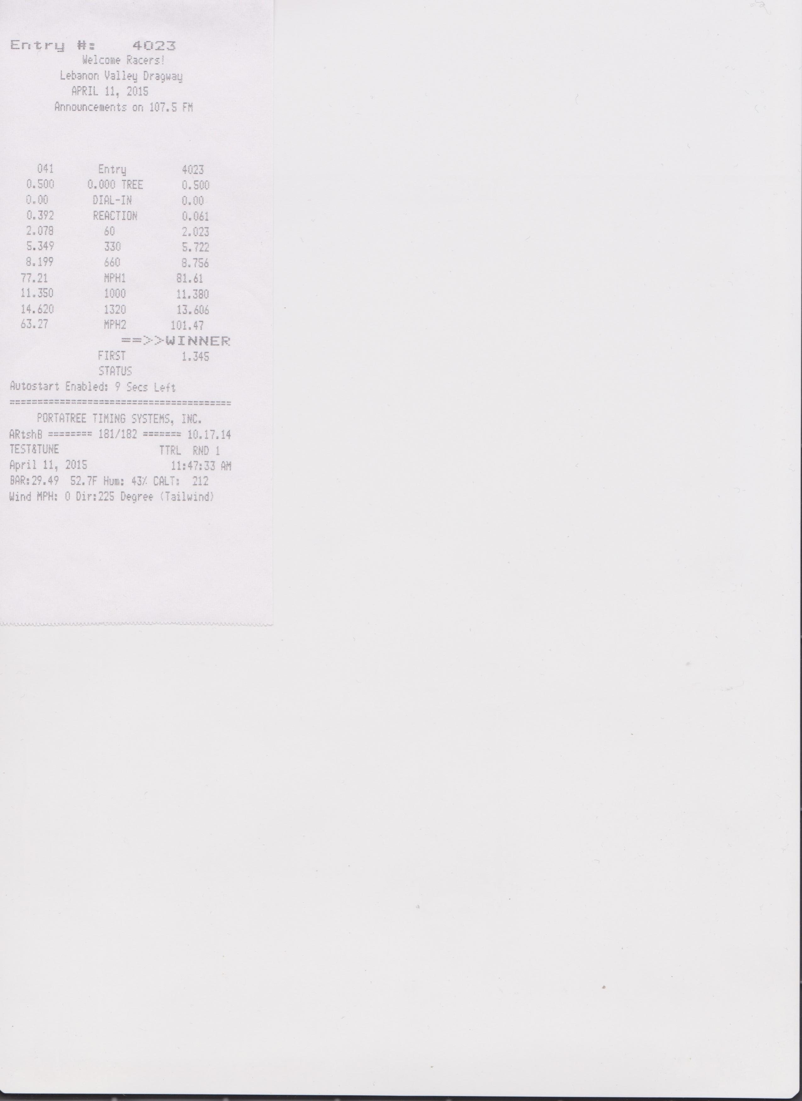

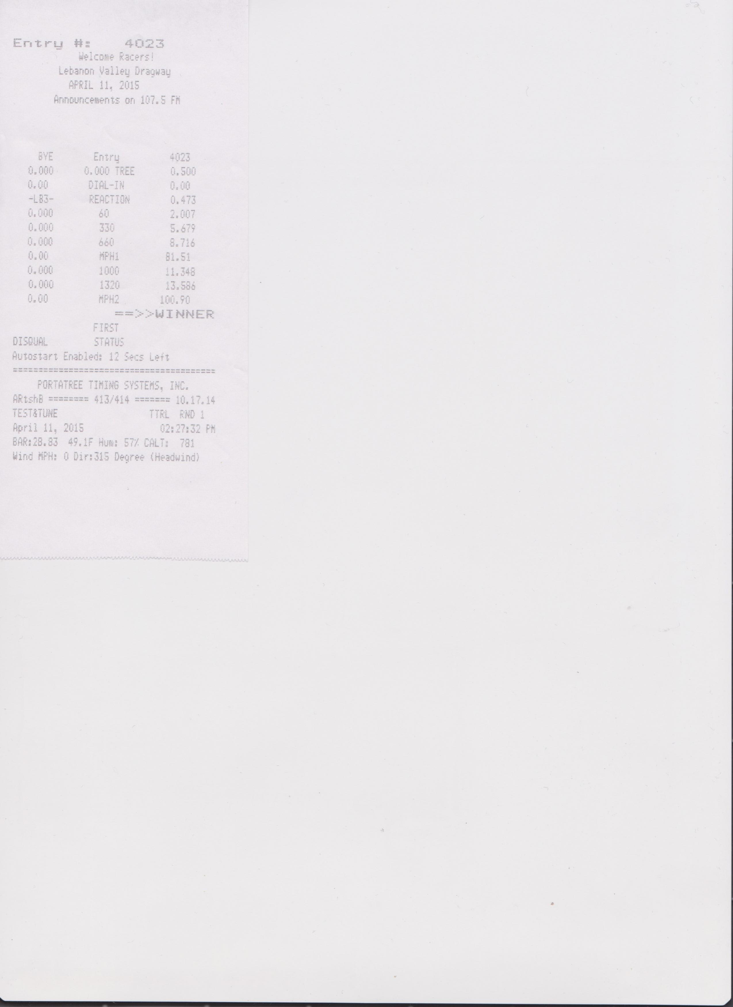

Went racing again today will post the slips in a bit. Ran a new best 13.586
2.007
5.679
8.716
81.51
11.348
13.586
100.90

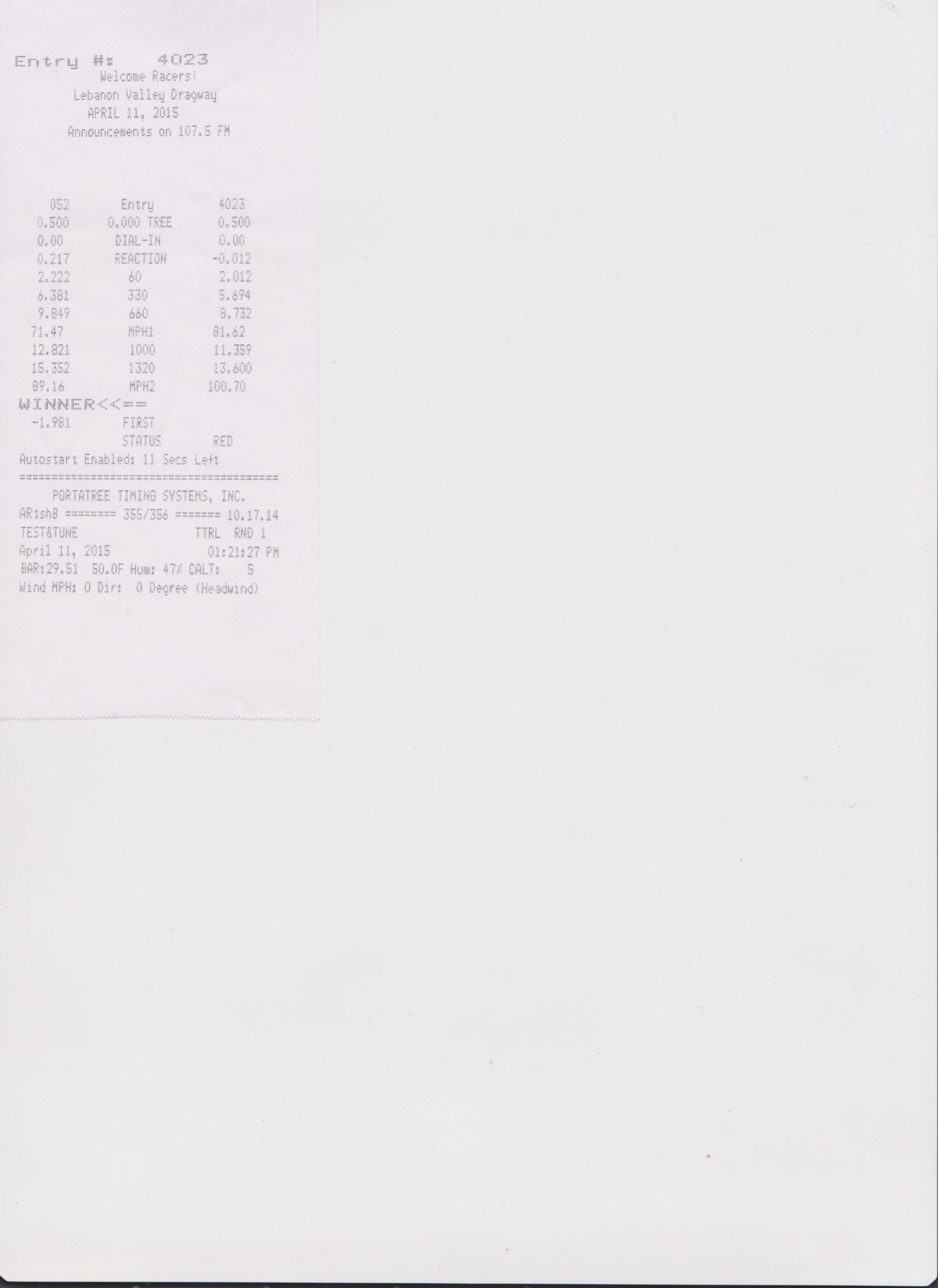

Here are my best 3
Attached Thumbnails Took The G Draggin Today-scan_20150414.jpg   Took The G Draggin Today-scan_20150414-2-.jpg   Took The G Draggin Today-scan_20150414-3-.jpg
